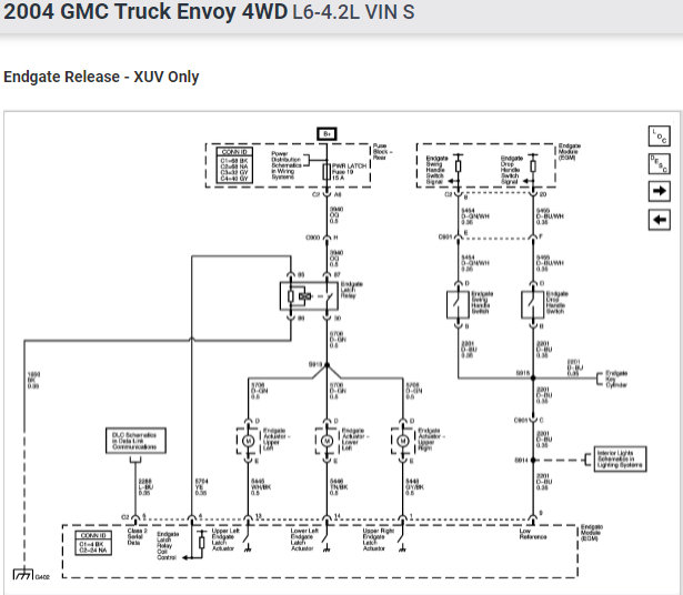

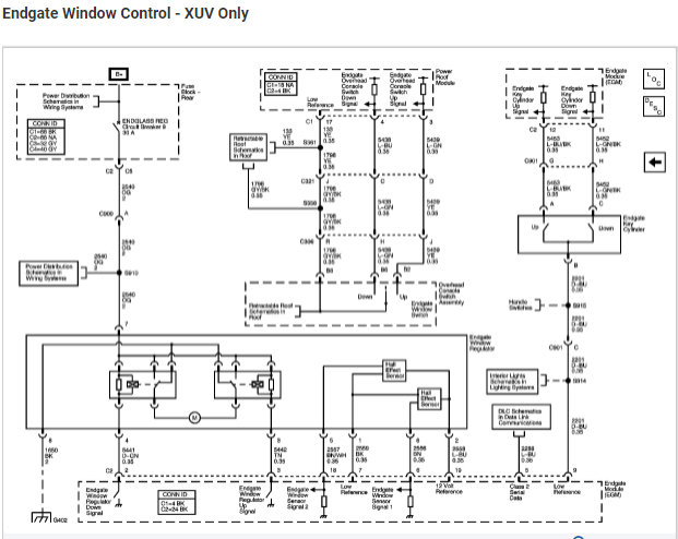

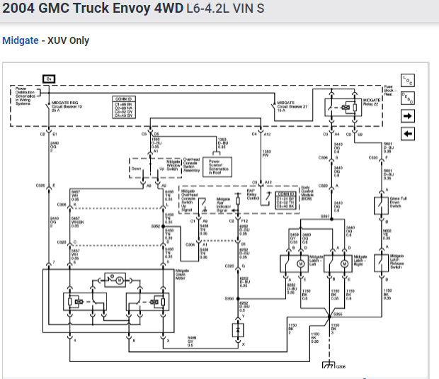

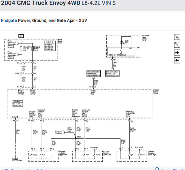

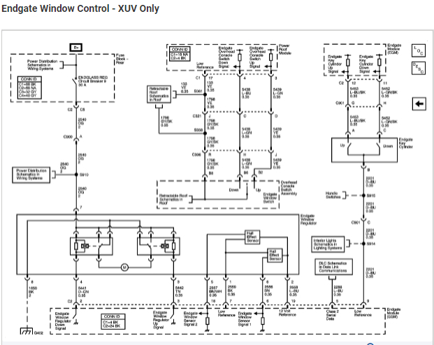

I currently own the vehicle listed above XUV, 4.2 Liter, I-6. The vehicle seems to run fine, but my issue is with the tailgate/endgame not getting power to the window as well as the door release buttons at the rear of the vehicle. Also, the rear defrost button is not working as well.I would like to assume that the problem is contained to the rear function of the vehicle (the power going to the tailgate/endgame specifically) because I don't have power to the tailgate window as well as the door, but power to everywhere else. It could be a possibility of a fuse or shorted wire, but I have no wiring diagram to isolate the tailgate. The XUV is a rare vehicle and a lot of GM dealers see it and said that they have never heard of it before. Which means I'm going to pay them to experiment like I am. Does anyone have this issue or have wiring schematics for the tailgate in particular? Your help would be greatly appreciated.

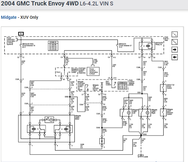

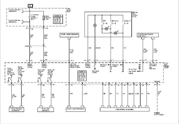

I have attached few wiring diagrams for the XUV. Let me know if you have able to read it. Some reason the format of these does not allow me to upload larger images.

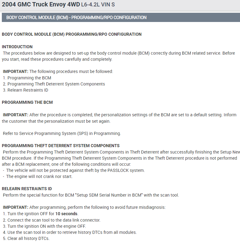

The BCM usually needs to be programmed to the vehicle. Did it get programmed?

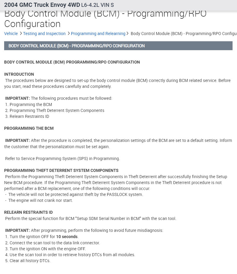

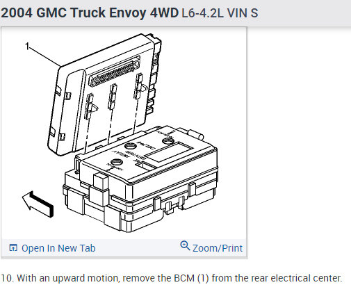

Did you get the BCM programmed? It might not be recognized by the vehicle otherwise.
Thursday, July 15th, 2021 AT 8:27 AM
JETSON21
  • 9 POSTS
No sir I haven't. I just downloaded the attachment you sent with the last post and I'm going to try and follow the procedure as the instructions say. My question is even if its not programmed properly, I should at least get a indication that it is communicating with the BCM, but not able to respond by at least a error code on the dash right?

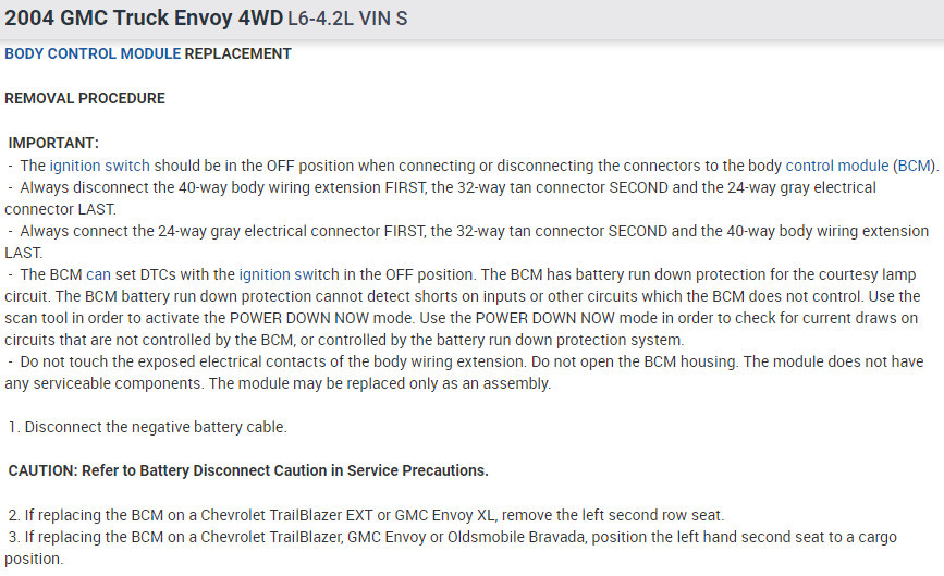

The BCM for that vehicle does need to be reprogrammed.
Did you get a chance to do that?
Friday, December 17th, 2021 AT 9:40 AM
JETSON21
  • 9 POSTS
No sir, I have not. Do I need special instructions on how to do so, or is it just a matter of me unplugging the battery and letting the charge drain for about 30 minutes?
Friday, December 17th, 2021 AT 10:10 AM

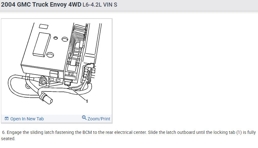

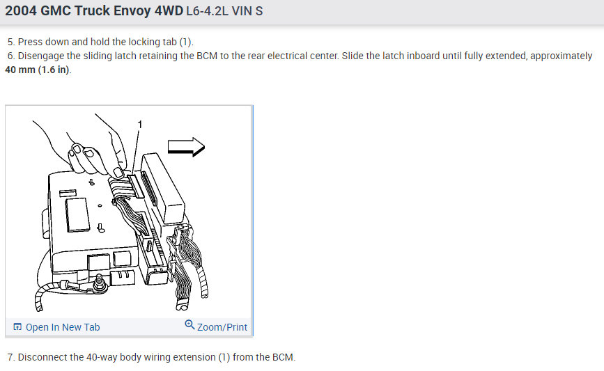

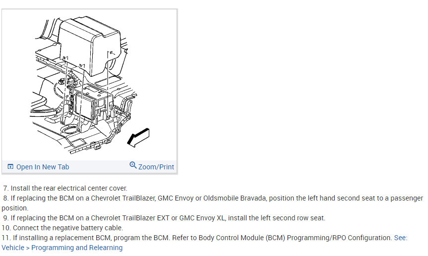

SQM
  • 6,383 POSTS

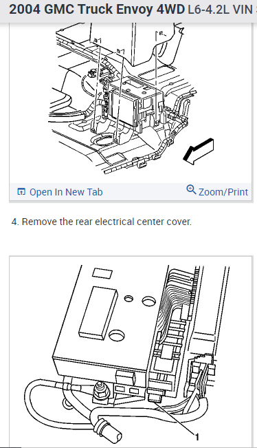

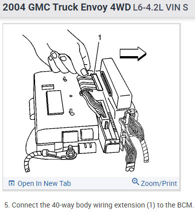

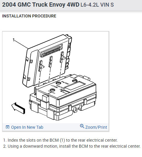

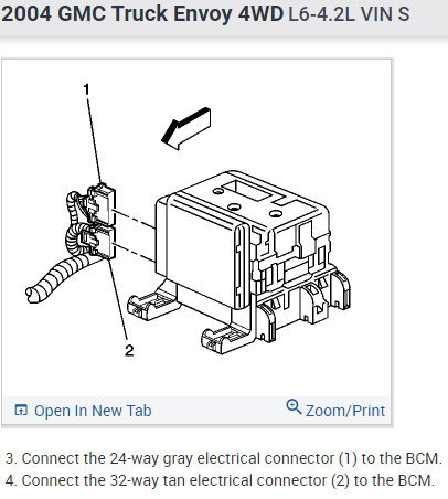

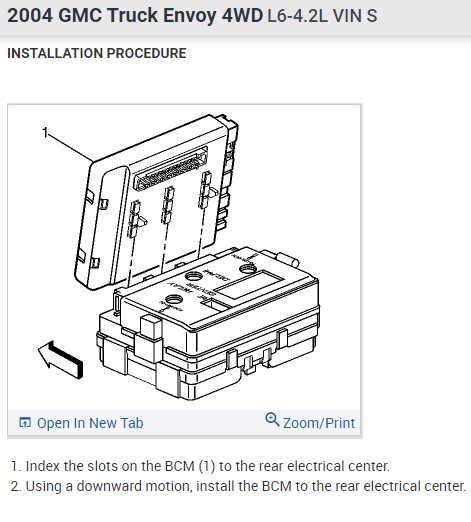

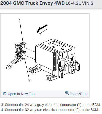

These typically require a special scan tool to perform the programming/relearn.
But disconnecting the battery could work.
Look below for the steps that Alldata provides.
Friday, December 17th, 2021 AT 12:25 PM
JETSON21
  • 9 POSTS
Now the question I have is: Is there a procedure specifically for the Rear BCM? I tried the procedure that you passed along, but that is for all Envoys in general. The functions and controls for the regular controls did reset and relearn, but it had nothing to do with the rear controls.

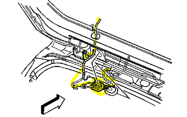

  • 110,192 POSTS
I noticed it has been a couple of days since we made contact. Has any progress been made?

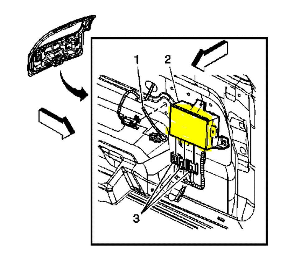

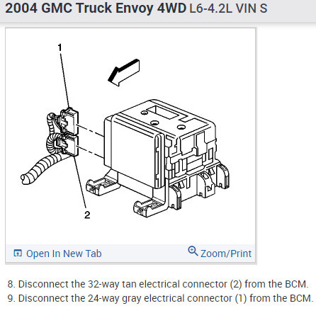

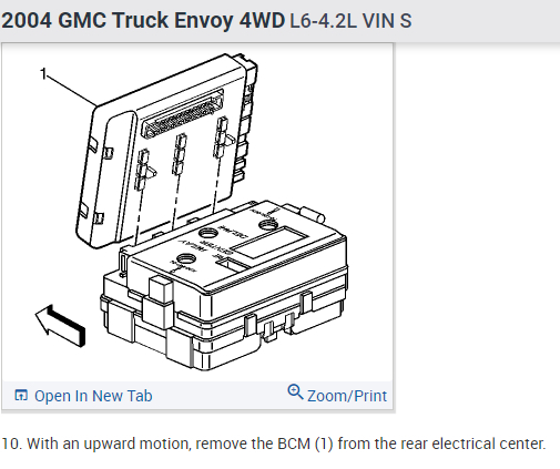

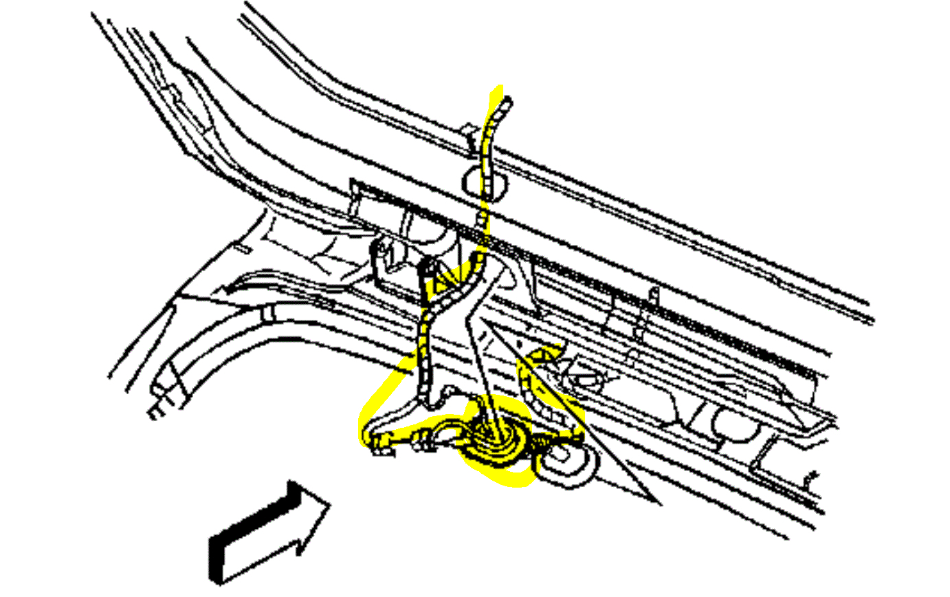

I do have a question. Have you checked for damaged wires where the wiring harness goes from the body (top of liftgate) to the liftgate door? It is common for them to fail from opening and closing many times. Pull back the rubber boot there and inspect them. See pic 2.
Also, there is a liftgate module in the door itself. See pic 1. Check to make sure none of the wiring is damaged, cut, or disconnected.
Let us know what you find. I have a feeling that you have an open circuit to the liftgate module. Chances are it is where the wiring goes from the body to the door. Also, thank you for your service to our country. It is truly appreciated. I hope you have a safe and good new year.
