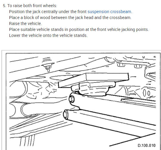

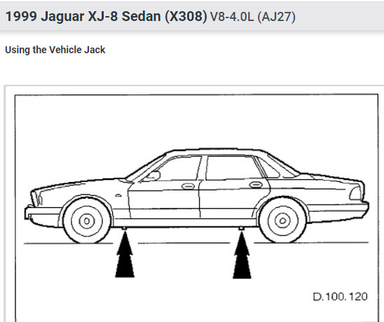

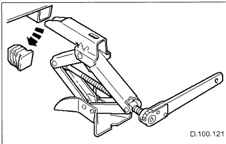

I have the vehicle listed above and would like to get the jack points front and rear using a floor jack. The manual shows front and rear points but their diagrams are atrocious. Any help would certainly be appreciated.

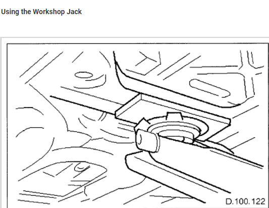

Hello, I'm Danny,
Here is the information you requested. This is a tutorial for you to view showing how to properly jack-lift your vehicle:
I've attached picture steps below showing how to lift-jack your vehicle off the ground. Hope this helps and thanks for using 2CarPros.
