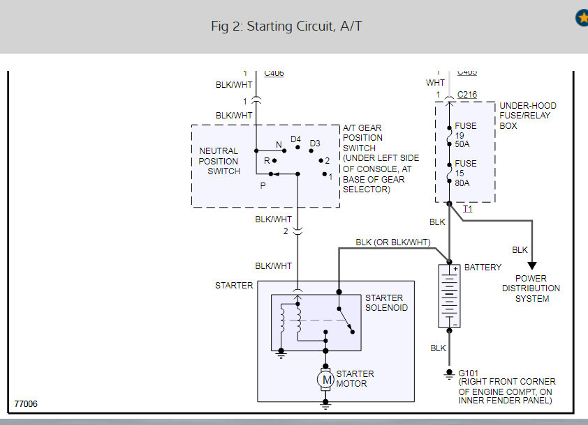

Starter is not working car in minor front collision
SBSHELLEY
  • 1993 HONDA ACCORD
  • 6 CYL
  • 2WD
  • 210,000 MILES
Car in minor front collision. Replaced radiator, condenser, fans, bumper and wont start. Check with meter all fuses. All come back okay. Battery has charge. Car had been sitting since November 2018. Started repairs in May 2019 couldn't start sooner. We Don't know what to check next. My brother is great at fixing cars. I am the helper but he know stuff. Thanks

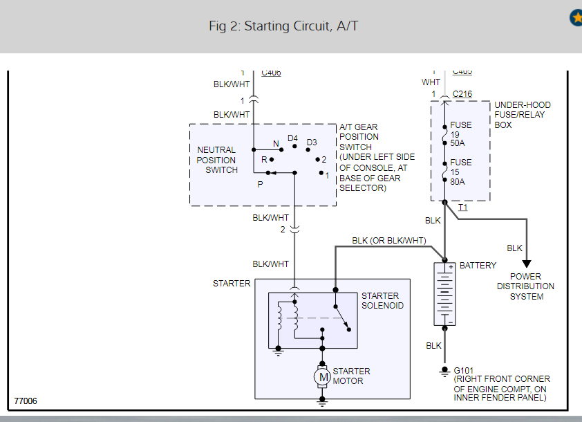

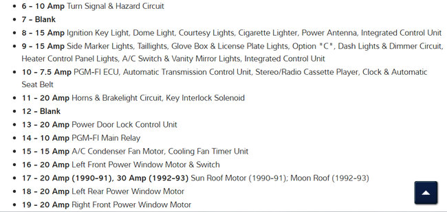

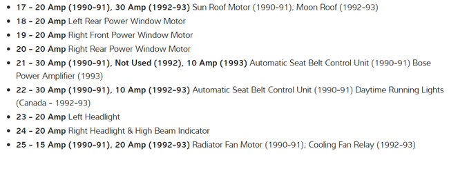

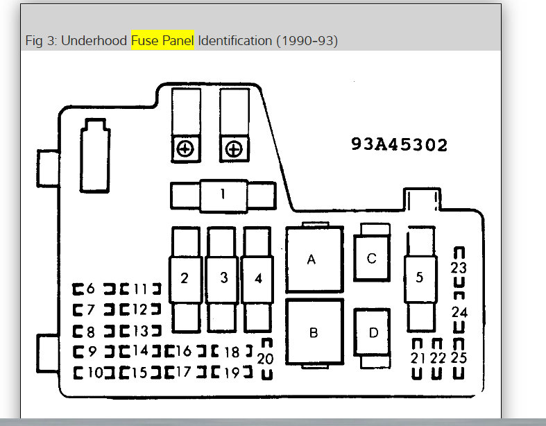

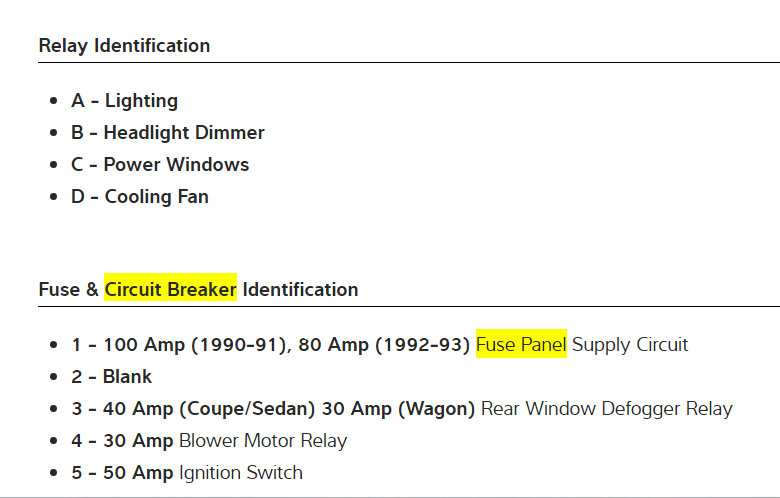

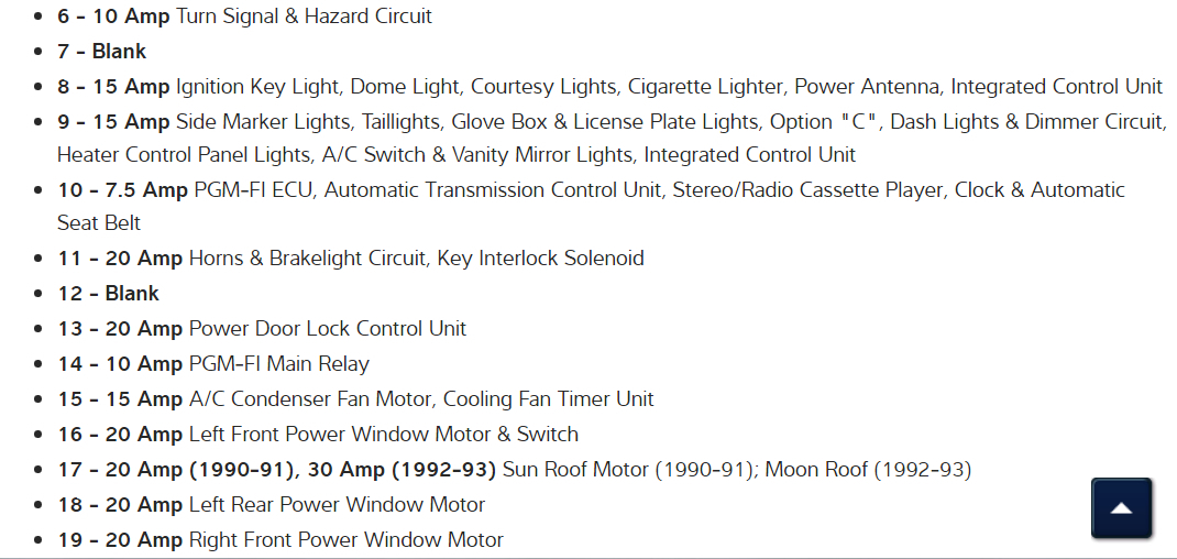

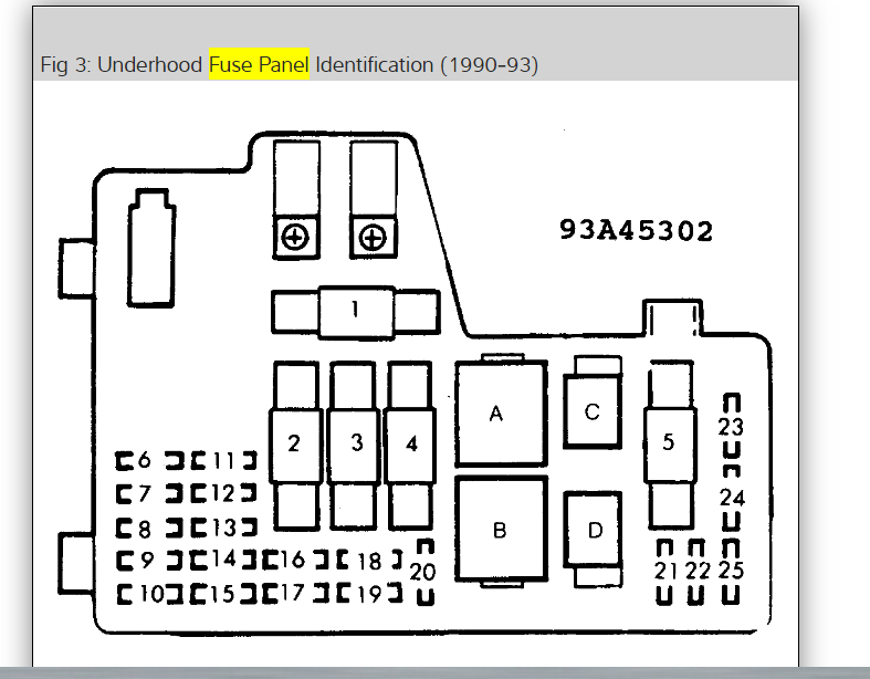

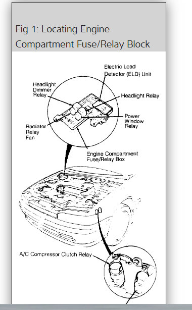

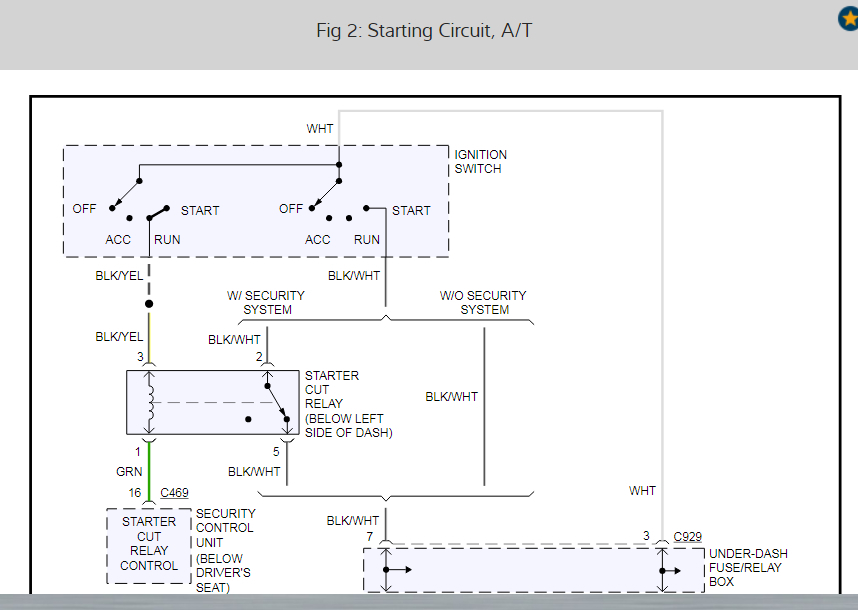

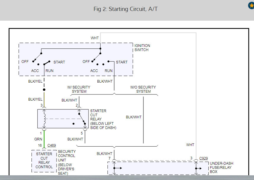

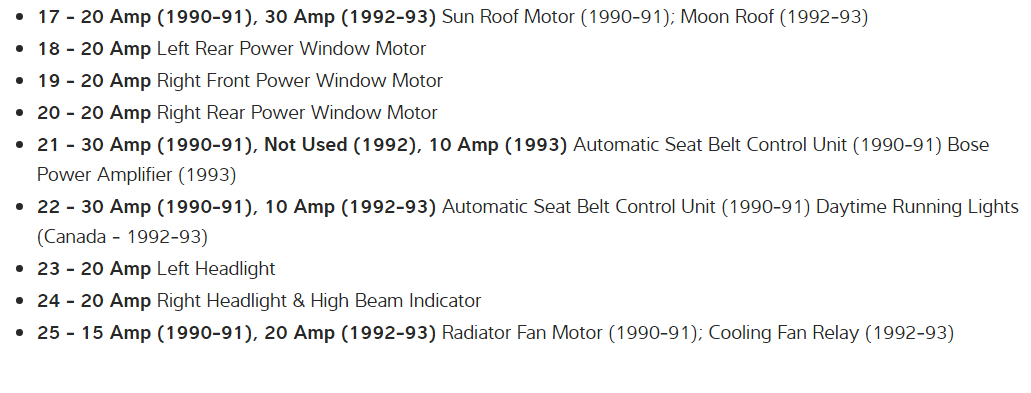

Okay, in the diagrams down below I have included a wiring diagram of your vehicle's starting circuit. Could you please double check fuse #15(80A) and #19(50A) in the Under hood Fuse/Relay Box. I have also included a diagram with the location, diagram, and callout for this fuse box in the diagrams down below as well. Here is a link to help with how to check fuses, if needed:
Please go through these guides and get back to us with what you are able to find out. We can go from there.
