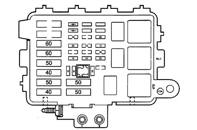

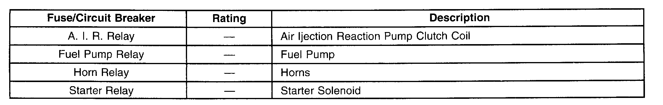

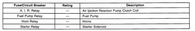

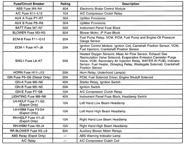

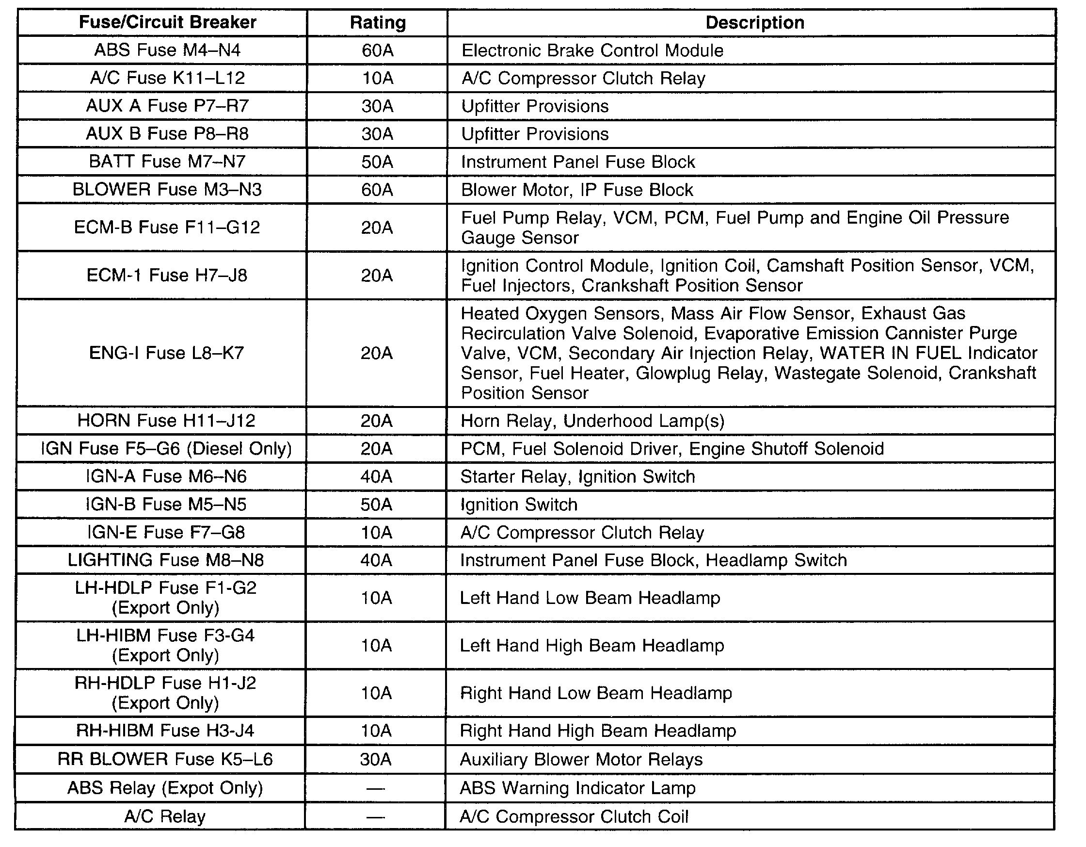

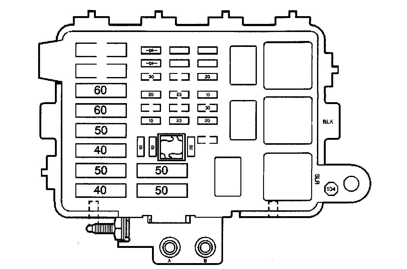

If you find there is no pressure, first confirm that you hear the pump turn on for a couple seconds when you first turn on the key. If you do not, check the fuse and fuel pump relay. The fuses are under the hood in the power distribution box. I attached a picture of the box, fuse locations, and two legends of what each fuses is for as well as where the fuel pump relay is located.
Make sure all fuses related to the pump and relay are good. Next, remove the fuel pump relay and first inspect the connections for corrosion or anything that could be preventing connection. If everything looks good, switch the relay with another relay in the box that has the same part number to see if that makes a difference.
