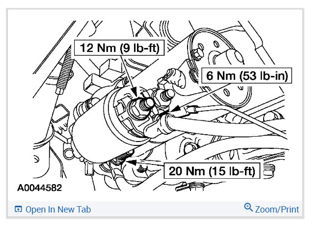

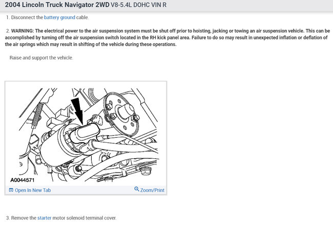

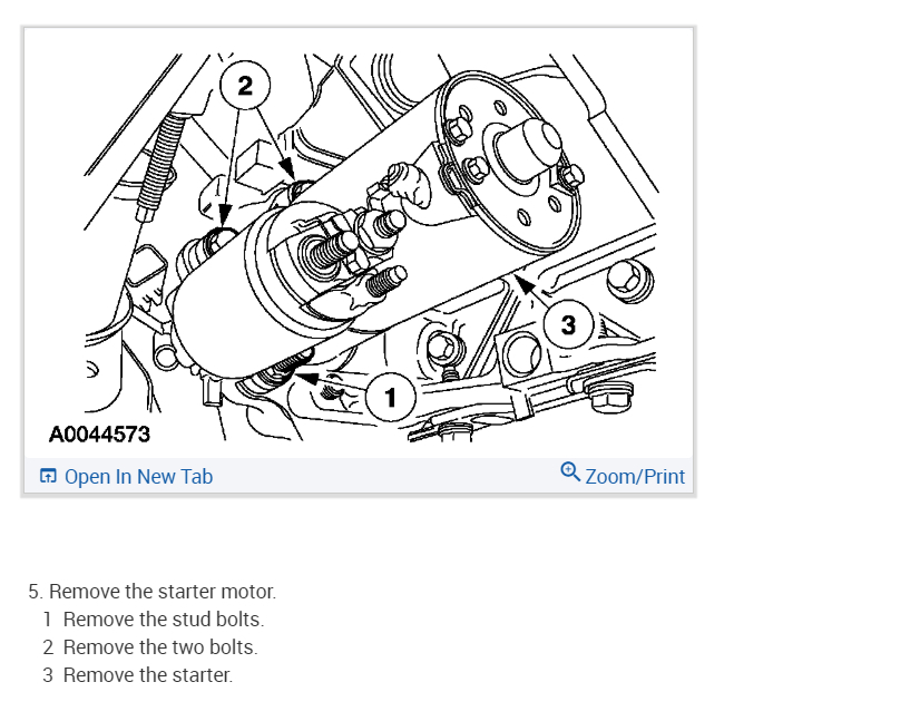

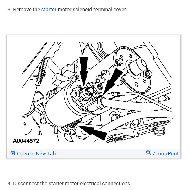

If I can step in here is sounds to me the starter motor has gone bad and the vibration of the tapping helps the starter work. Here is a guide to confirm the issue with a guide to walk you through the starter replacement with diagrams and instructions to help you with the job on your car:
and
