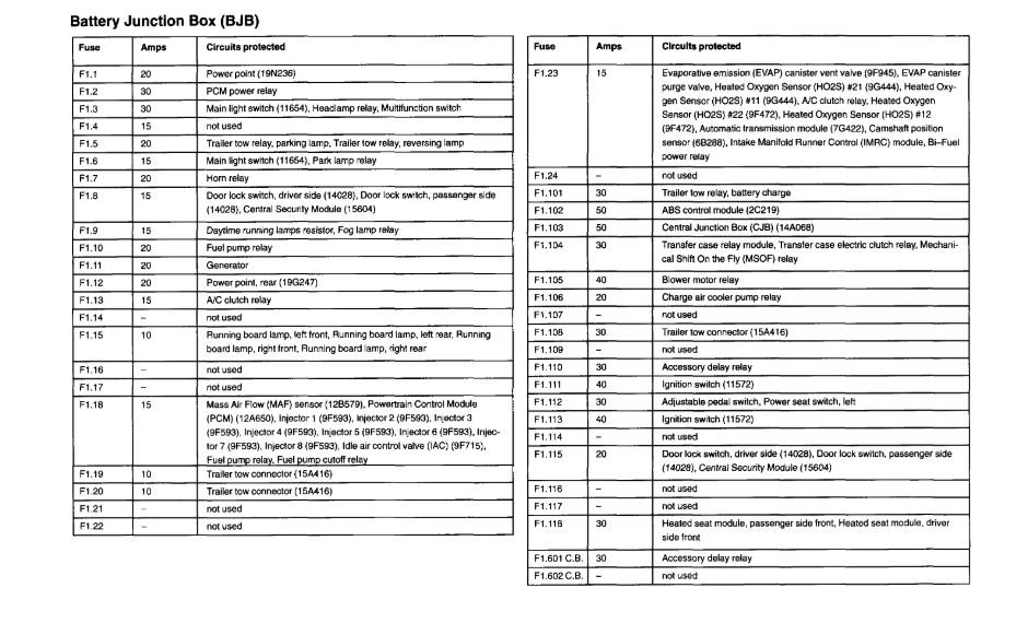

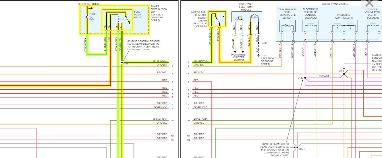

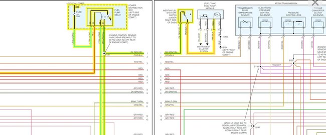

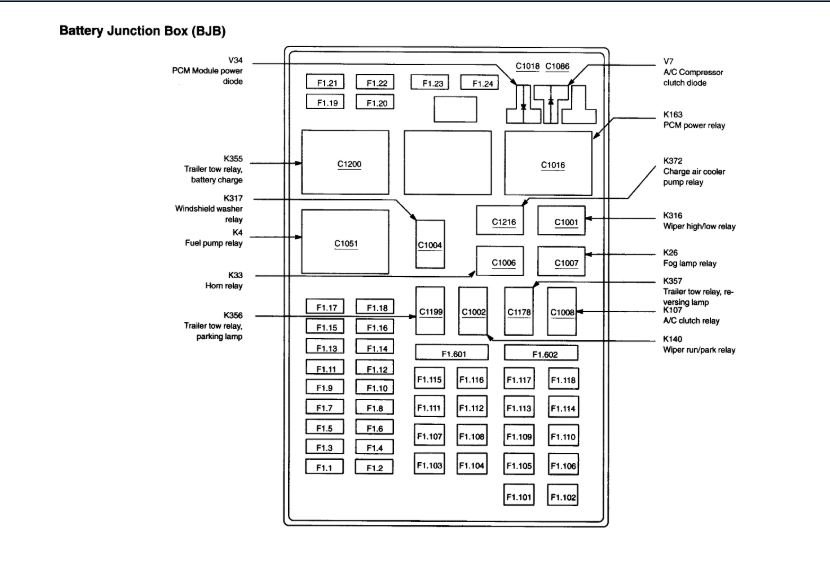

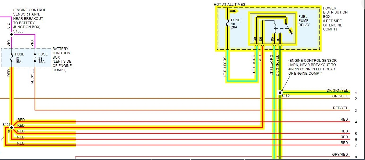

Will not start, I replaced the starter, fuel pump?
JAKXWESTHOFF
  • 2002 FORD F-150
  • 4.6L
  • V8
  • 4WD
  • 110 MILES
I replaced the starter, fuel pump, fuel tank, fuel regulator and it still wont start unless you poor gas into the throttle body. I have reset the emergency shut off.
Friday, July 3rd, 2020 AT 4:49 AM
Good morning,
Can you hear the fuel pump run when you turn the key on?
Did you verify power to the pump?
Do you have a voltmeter or test light to do some checks?
Monday, May 31st, 2021 AT 12:40 PM
