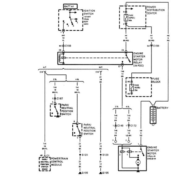

Not even a click. New battery and starter. No corrosion on battery. All lights and radio work.
Monday, October 29th, 2018 AT 11:14 AM
3 Replies
MECHANIC
52,796 POSTS
Good afternoon.
Do you have a voltmeter to check the battery voltage?

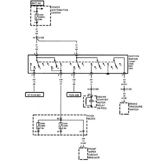

Otherwise, it could be a wiring issue to the starter. I will attach a wire diagram for you to view.
Do all the accessories work?

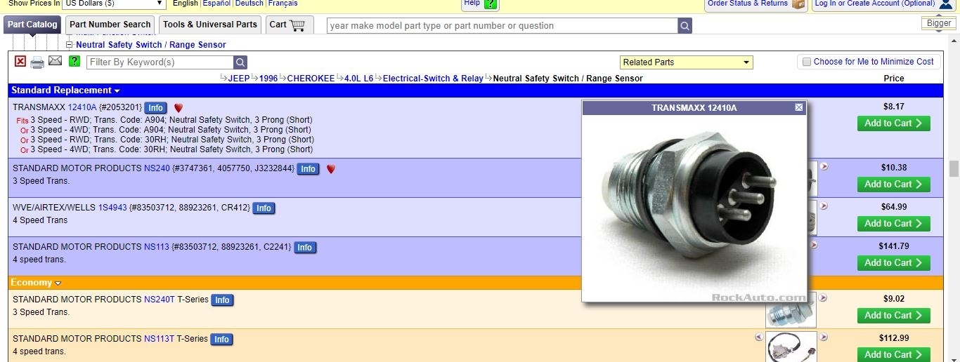

The battery is brand new. If you pull the e brake and put it in neutral it starts right up.
Monday, October 29th, 2018 AT 12:16 PM
MECHANIC
52,796 POSTS
Okay, that indicates the park neutral switch is the issue.
I will attach a picture and procedure for you.
It is on the side of the transmission. It has a three wire connector on it and it just unscrews. Picture attached of the switch.
