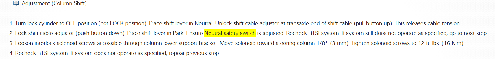

This could be a problem with the neutral safety switch. Below I have included some instructions on how to properly adjust your steering column shifter.

I know the neutral safety switch will prevent one from turning over if its bad, but can it cause the ignition not to fire? Car turns over, just not firing.

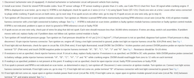

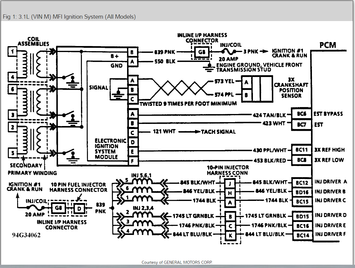

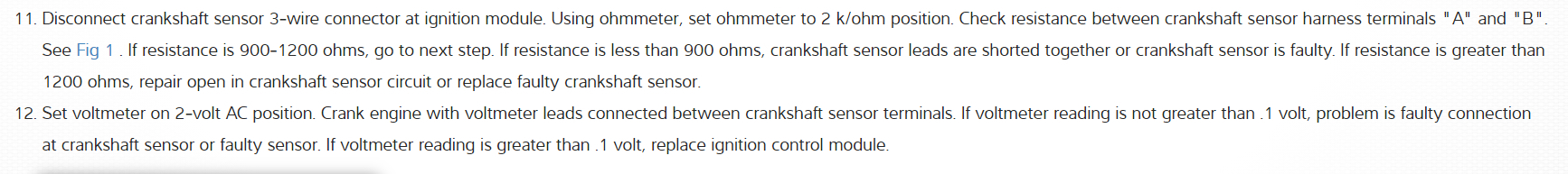

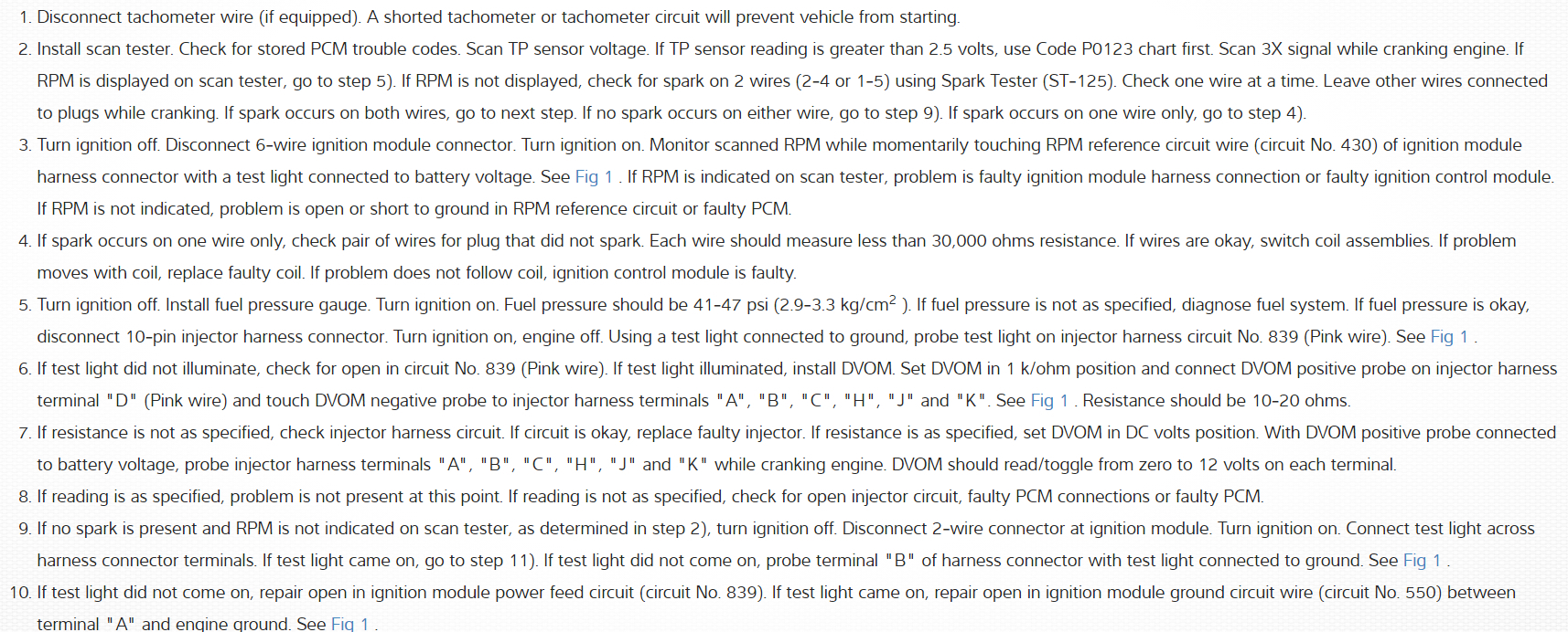

Hello again,
Okay, I have sent step by step instructions on how to troubleshoot the ignition system on your vehicle. They are listed in the diagrams below. Let me know what you find out.
