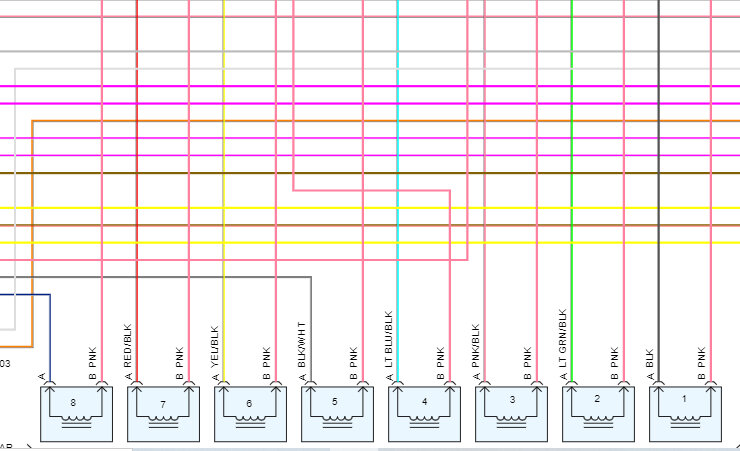

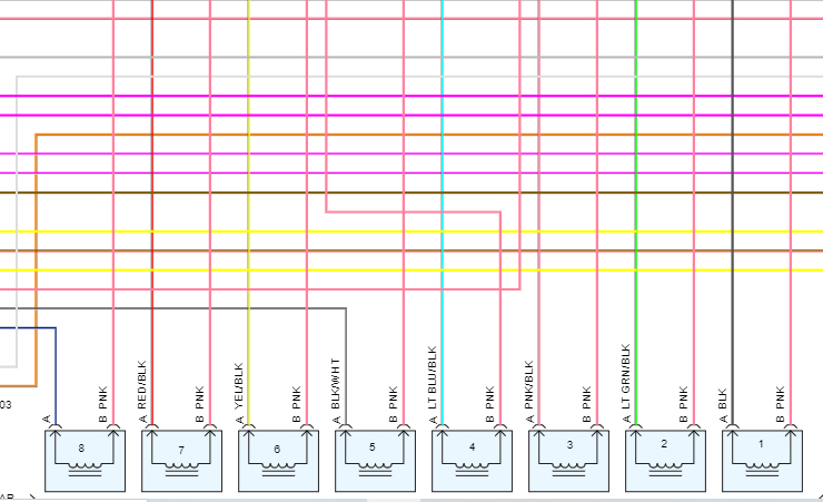

If it runs on starting fluid, then it isn't getting fuel. You mentioned it has good fuel pressure, it's most likely not getting power to the fuel injectors or injector pulse from the PCM.

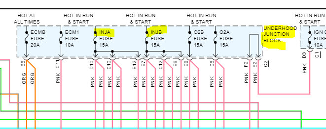

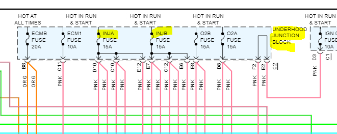

At each injector, there will be a pink wire. I need you to check for power to those wires. If there is no power, check both injector fuses in the under-hood fuse box.
If you find they do have power, I need you to disconnect one of the injectors. The connector will have two wires, one pink and one another that is different based on the cylinder.
Take a test light and place one end to the positive side of the battery and the opposite side to the wire (not pink) in the injector connector and have someone crank the engine. The test light should pulse on and off.

Okay, so, with just the key on I'm showing 5.4 volts when it turns over it jumps around from 5.4 5.1 don't down to 4.8 and 3.5and back through the same sequence. That's touching the none pink wire to the battery.

The good news is that it appears the PCM is doing its job. The bad news is there isn't enough power to the injectors. They should receive battery voltage (12v)
If you move the pink wiring harness around when checking voltage, does it change?
