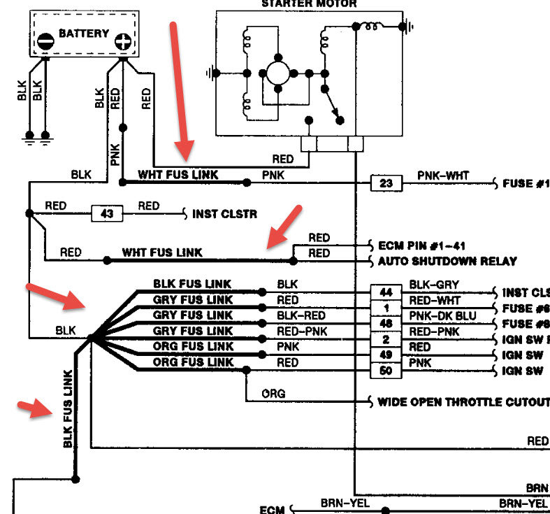

Changed batter and starter, still wont' run.

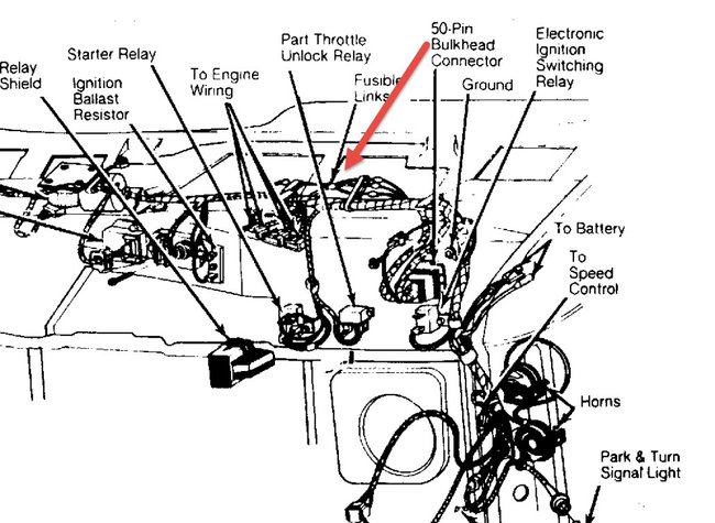

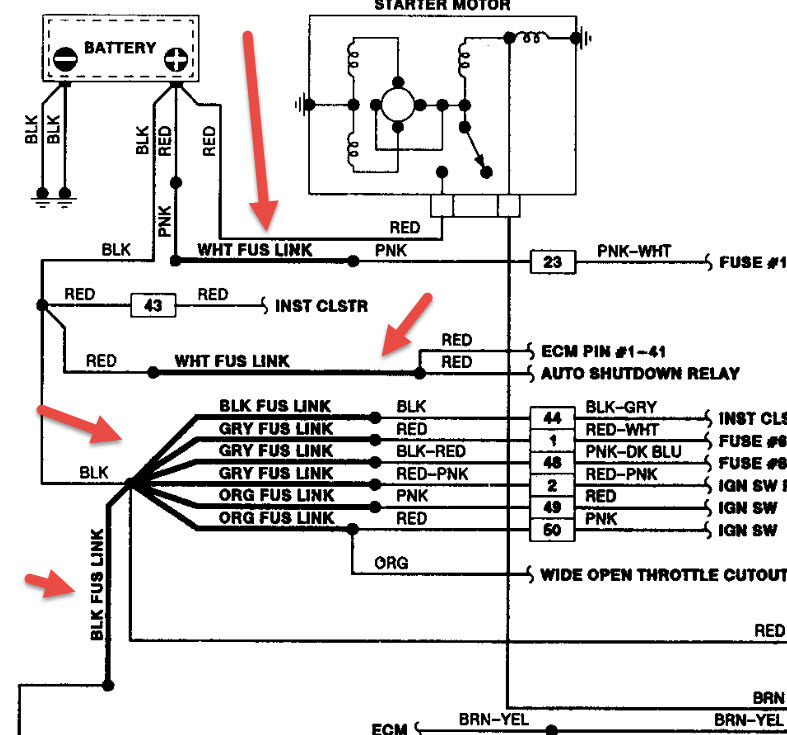

Check items in pic starter fusible link will runn off starter

Thank you will check it is on a church van.
