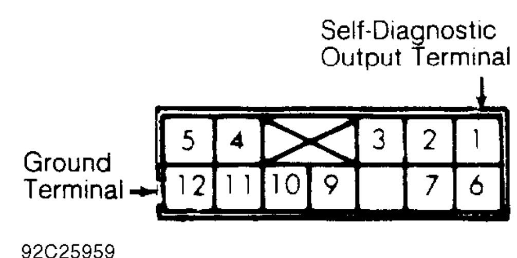

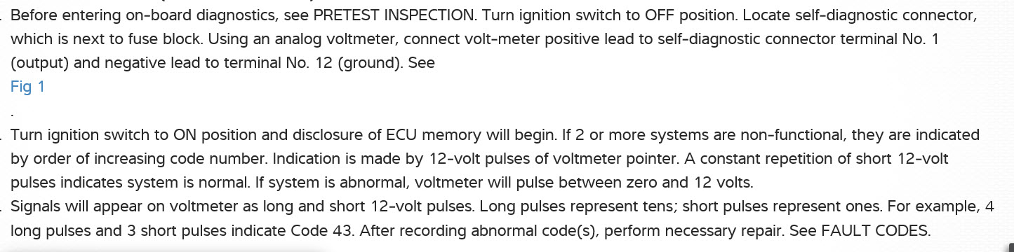

I have a 1991 dodge stealth r/t tt, 5spd, 85000 miles, the car has always started. But one day I went out to start it and all it did was crank fast but no start. It didn't even sound like it was trying to catch.I don't have a code scanner, so I can't pull codes.I'm in the process of checking the fuel in the tank and the pressure, it is sparking. Please help me get my baby running again.

Try resetting security system if no manual look online for your vehicle scan for codes see pic you need a volt meter to do that
