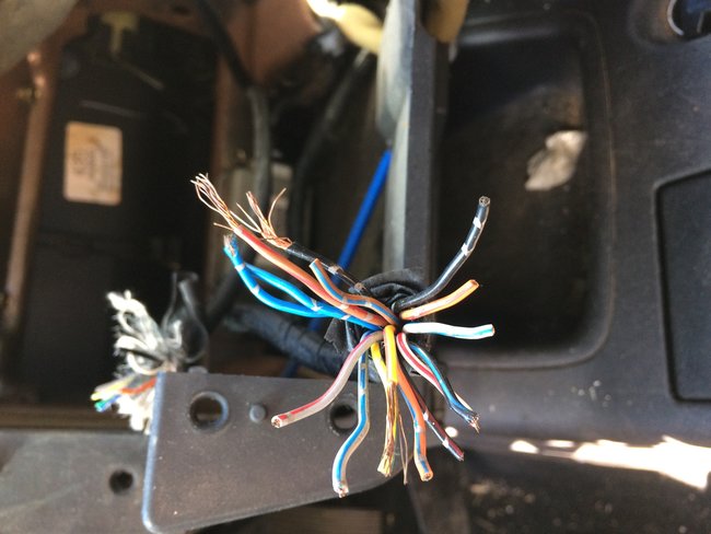

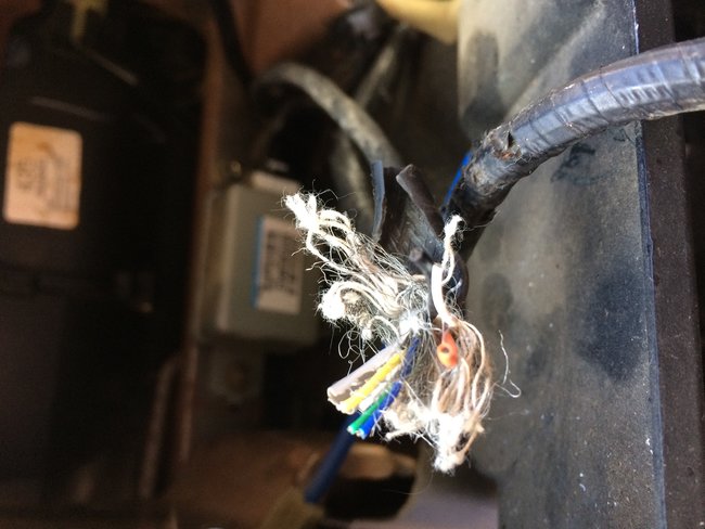

I have the car listed above GS, that someone cut the wiring harness behind the stereo the stereo. Clip is still intact as are the climate control clips, there are two other bunches of wires that I don’t know what they are that are cut. I need help getting a diagram. The only things that seem to work on the car are the interior and exterior lights and the dinging to say the door is open and key is in ignition. When I turn the key absolutely nothing happens.

I will do my best to ID these wires, might take a little bit, can you clean those fibers away in the first picture so I can see the wire coloring better. Also does the check engine light come on when you turn the key to the on position? Or the Start position, it should come on for a couple seconds.
Are these wires directly behind the radio, or more down under the dash? Any more on location will help a lot.
And do you have a multimeter by chance?
I need a couple more angled pictures so I can see the stripes on the wires too.
If I can get you to check for power on a few fuses, even with a regular 12volt automotive test light, it will also help a lot. I can already see some possibilities
So far, a lot of these look like they were for the Radios Amplifier (which would be under the passenger seat) if its missing, they probably took it.
If you can, in each picture, so picture 1 I see 4 or 5 wires, can you give me each wires color, I see a green, blue, yellow, orange/yellow.
Second picture I see, 2 black, 2 white/red, 2 white/light blue, 2 orange/blue, 1 yellow/red, 2 blue/light blue, 1 black/purple, 2 yellow/, 1 black/blue, 1 orange with strains on the end.
If you can correct any of those.

Okay, let’s start with a picture of one of the wires are Tiny and they are red, white, black, yellow, green, blue and it comes from the same place the antenna and remote wires come from.
And now for the wires in picture to there is a
gray with blue stripe
gray with a red stripe,
2 blue with no stripe
2 Black with no stripe
brown with blue stripe
brown with red stripe
white with blue stripe
yellow with red stripe
orange with blue stripe
yellow with blue stripe
white with red stripe
black with blue stripe
black with red stripe.
And that set of wires comes from the lower right-hand side.

Okay. So, from the first picture is the red, white, black, yellow, green, blue? Haven't seen a plain white wire except the cruise control unit, and are you missing any of the control face units? Like heater control unit, etc. Maybe take a picture of the whole dash so I can see what's missing altogether. Because I'm having to go through diagram by diagram to ID wires, and there's a lot of them. And if the heater controls are not missing, does it light up when the lights are turned on?

So, the big cluster of wires is supposed to go down under the seat, so I suspect you’re right on that. As far as the controls on the dash I’m not missing any and everything turns on and works as far as the climate control all lights everything works except for the push for the max A/C I guess doesn’t come on and light up.

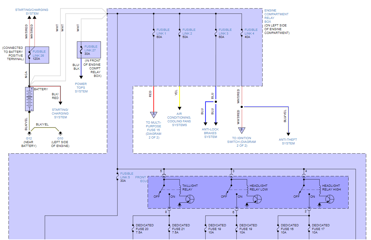

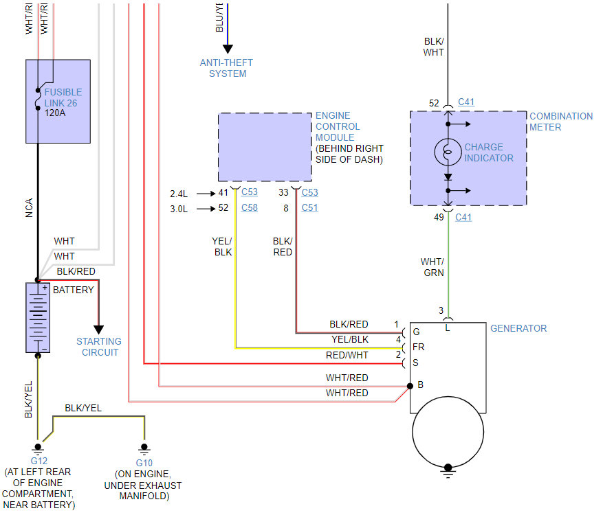

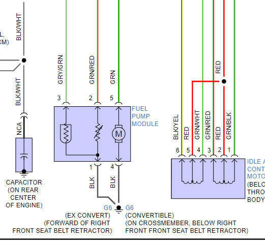

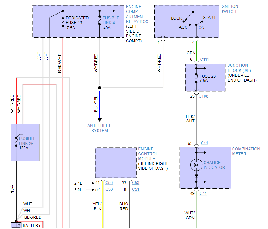

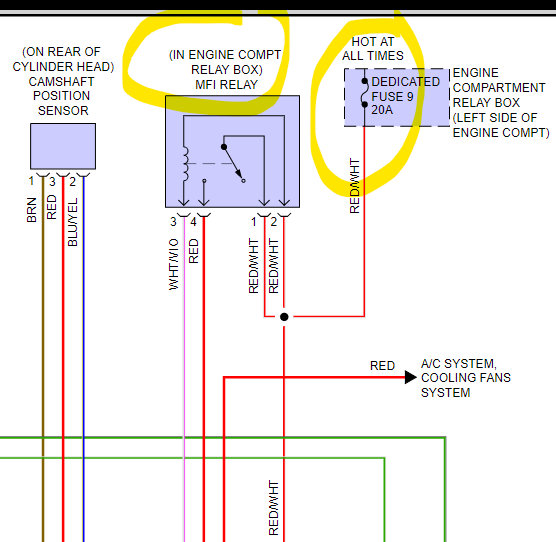

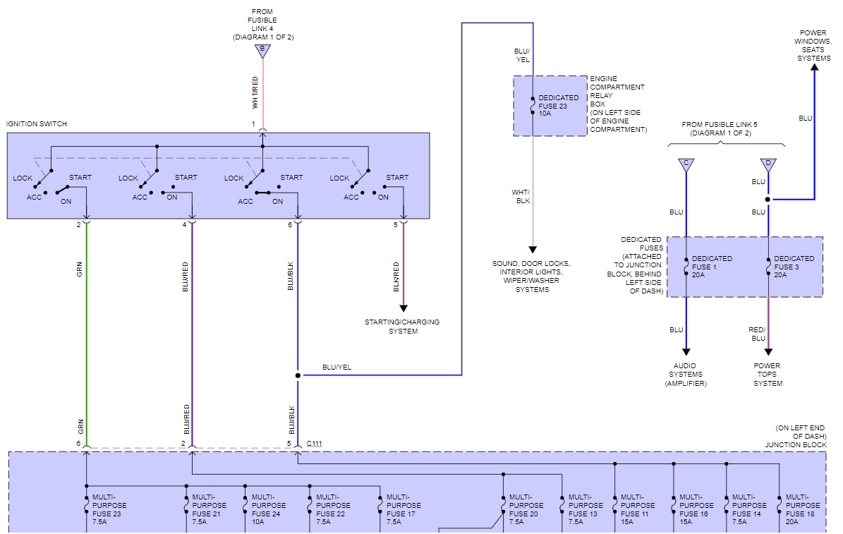

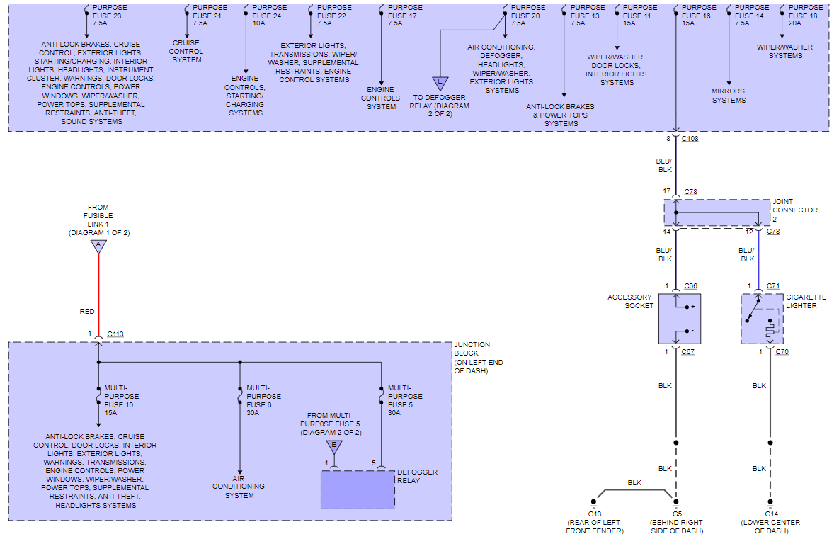

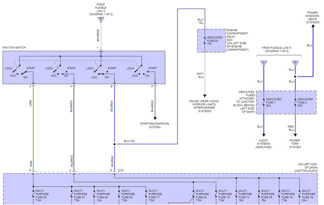

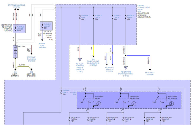

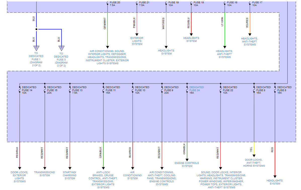

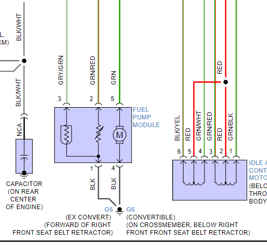

Okay, well I'm posting all the Power Distribution Diagrams (1, 2, 3, 4) and the Starting Diagrams (5&6), This way you can at least know where each Fuse goes to and won't be left waiting for me due to the time difference.
I'm also adding the Fuel Pump Diagram (7) and the MFI Relay (8).
With the Fuel Pump, all those wires to it go back to the ECM,
But also check the MFI Relay, I had an Eclipse once, I think the same year too, and the MFI Relay Harness plug to it was completely filled with green corrosion, The car would run, then not run, do all kinds of strange things. So definitely check harness plugs on these cars.
