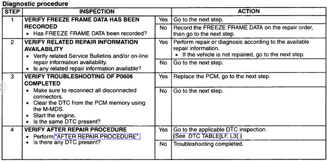

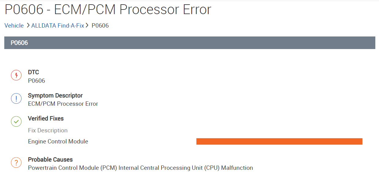

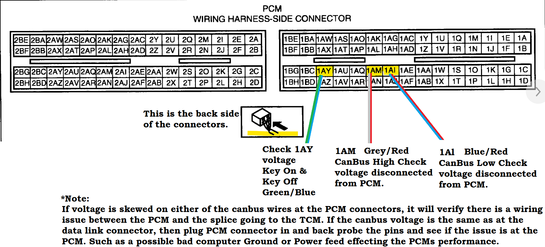

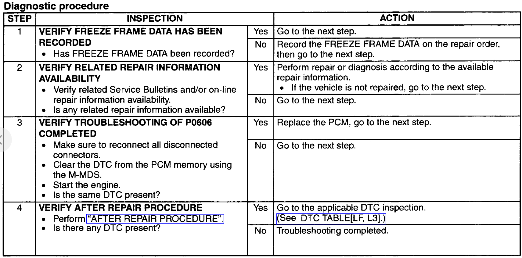

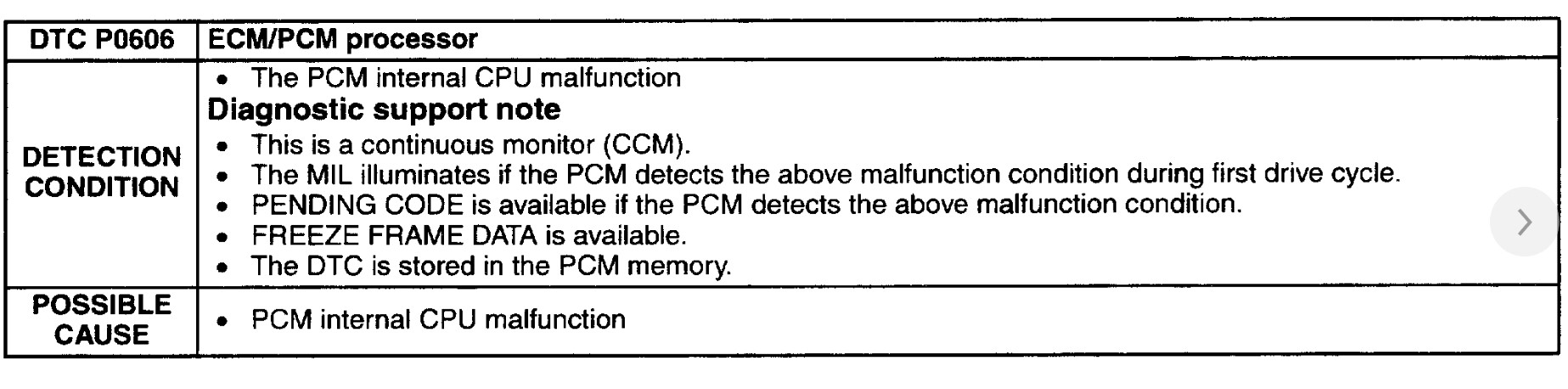

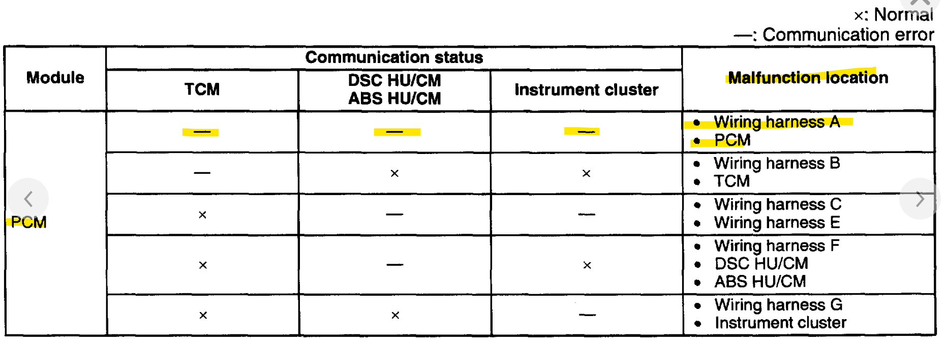

Okay, well let's see what the Alternator does. I'm worried something is causing these internal PCM failures. Thats really what the P0606 code is. So, I hope the Freeze frame data has something in it.

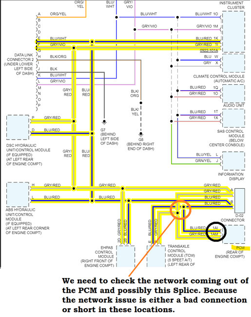

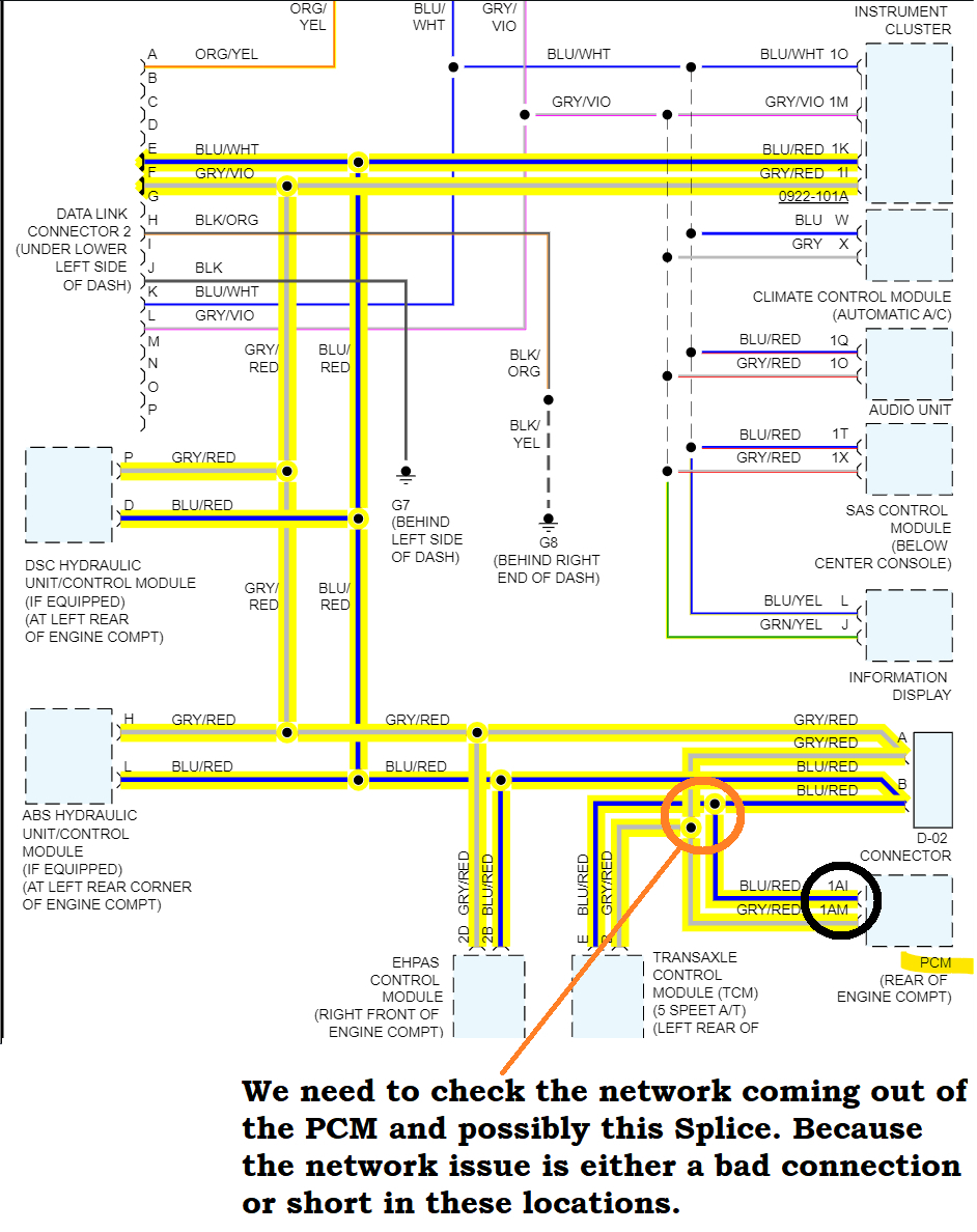

I looked over these codes in service info again and these U0101 no comms w/ TCM, U0121 no comms w/ ABS, and U0155 no comms w/ Cluster are all being set from the PCM. So, it's not the other modules setting these codes, it's the PCM not being able to talk to those modules. Not the other way around, which is why you probably had good voltage readings at the data link connector.
+1
Monday, June 12th, 2023 AT 9:59 AM
AL514
  • 5,584 POSTS

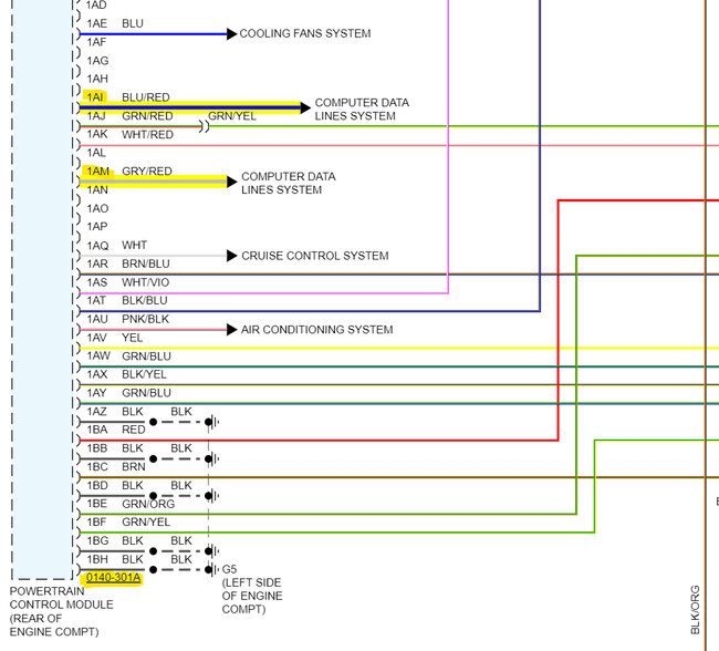

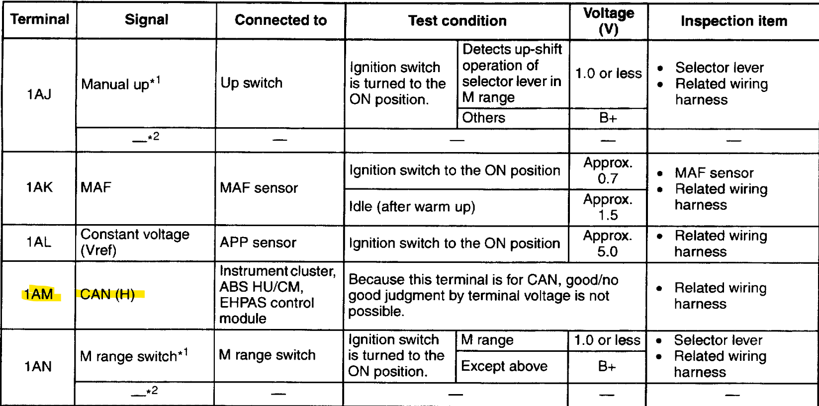

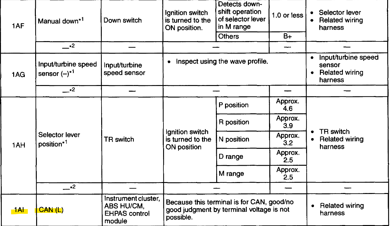

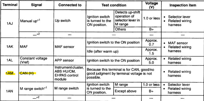

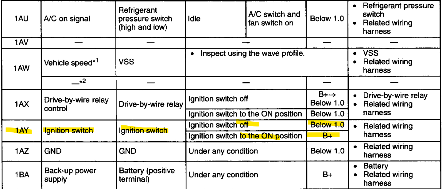

These are the PCM connector with the network wires and testing in diagram 1. Check to see if theres any issues from the PCM to the rest of the modules. Let me know what you find.

Okay, are you still getting the same 4 codes as before (P0606, U0101, U0121, and U0155)? And how do you have the Fan wired up right now? This sounds like a temperature related issue. Sometimes when a PCM or any other circuit board gets a cracked solder joint, the crack won't open up until the board gets hot, causing an open circuit. The A/C compressor is a large load on the electrical system, that's why I'm curious about how exactly the Fan is wired, that way we can possibly have you back probed into a connector somewhere to monitor the voltage and catch the fault when it happens. I would do this same type of diag but with a scope on the network wires to see if the PCM comms (can bus) are dropping out at some point.
