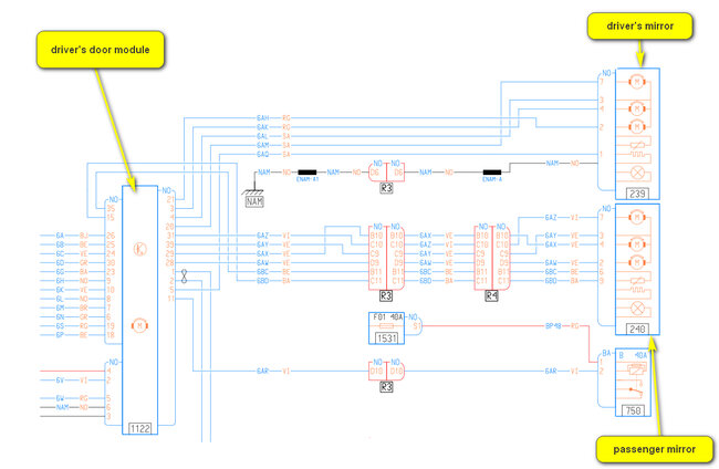

Hi, i a have problem with the wing mirror of my car. That is when car park wing mirror doesn't close, so i need to wiring diagram of wing mirror. Thanks to anybody who can help me.

Below please see wiring diagram from driver's door control module to both outside mirrors.
Also check fuse F32(30A) in interior fuse block
You can test wiring using a voltmeter.
