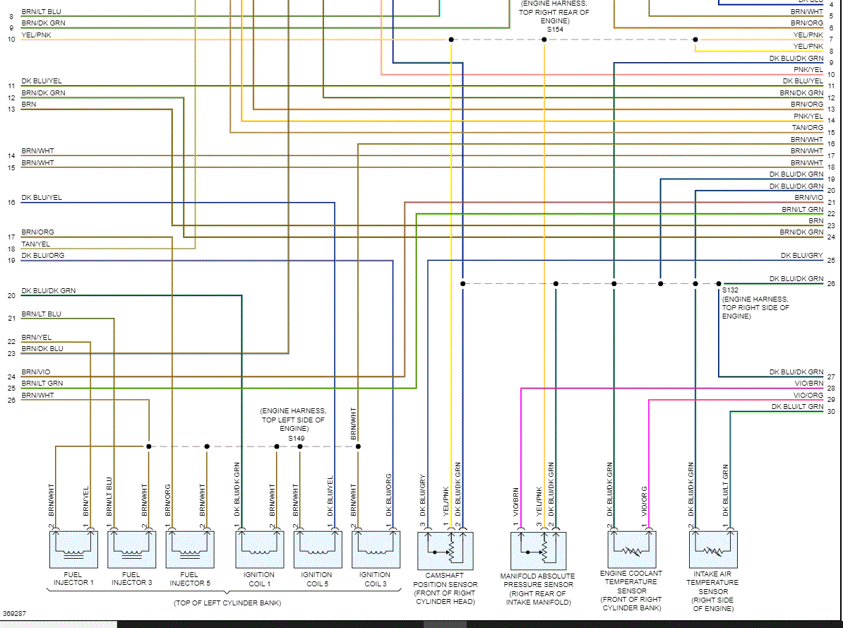

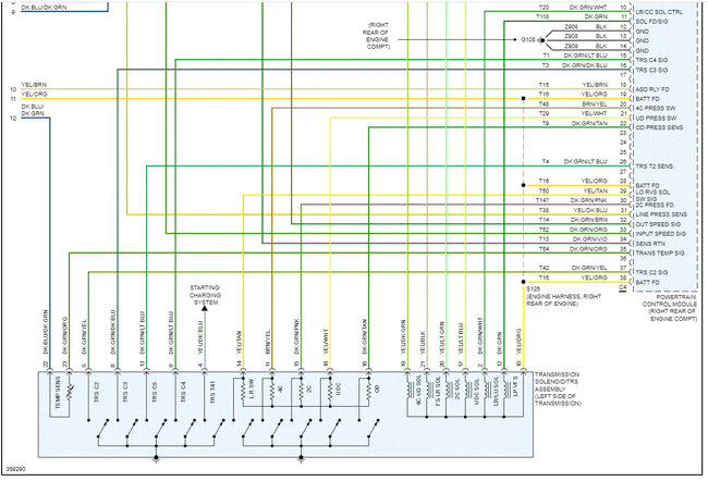

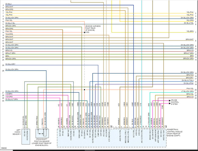

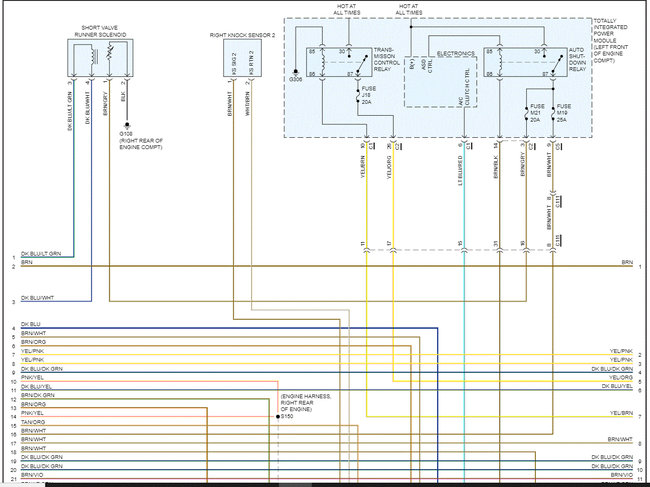

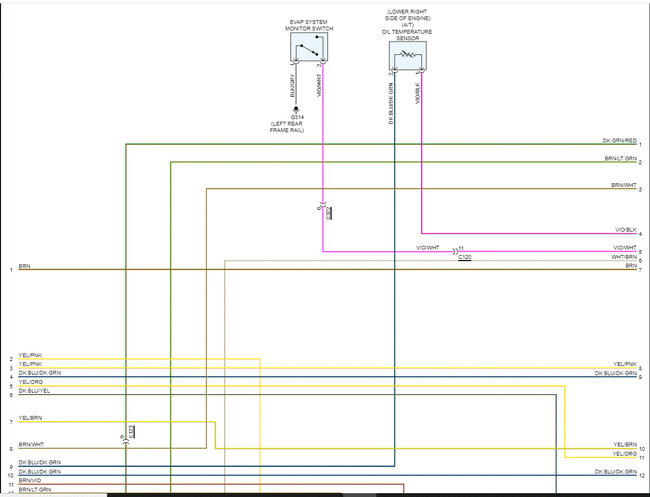

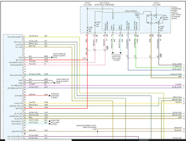

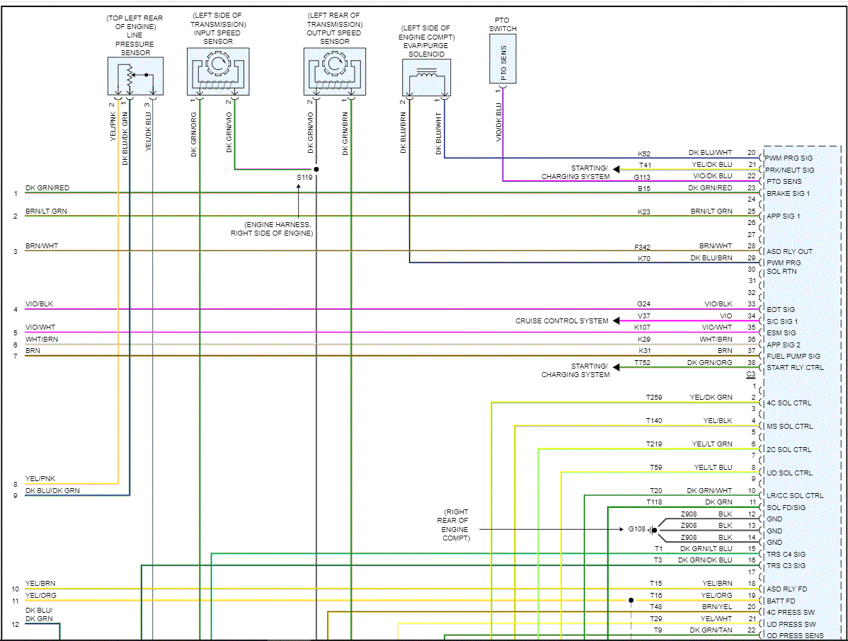

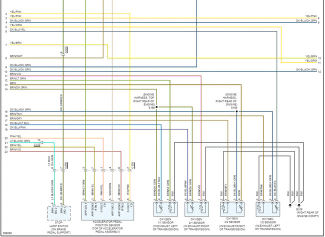

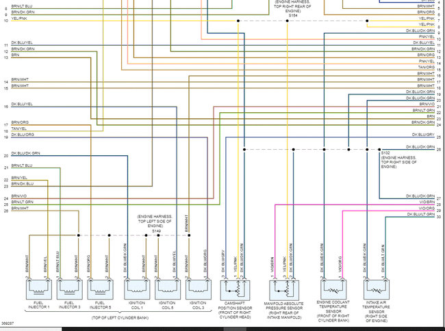

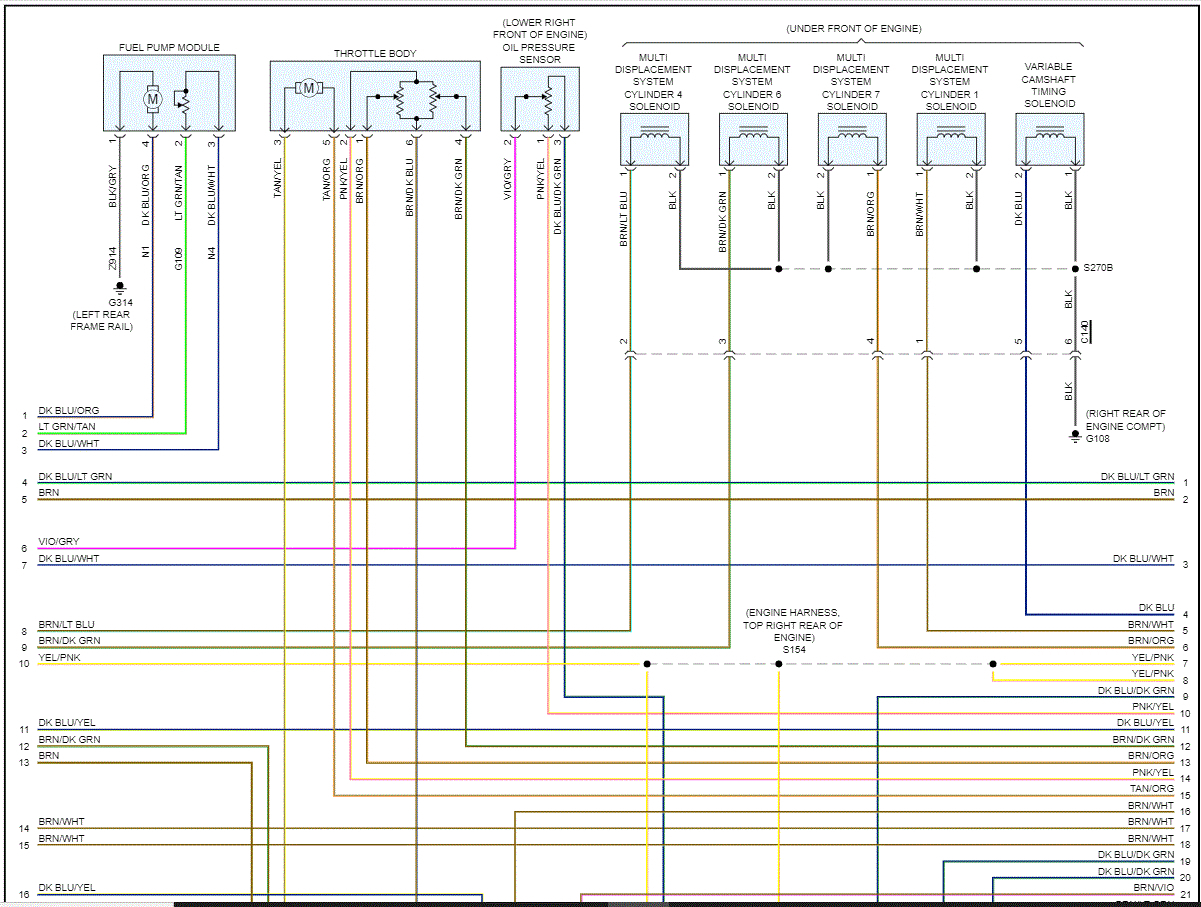

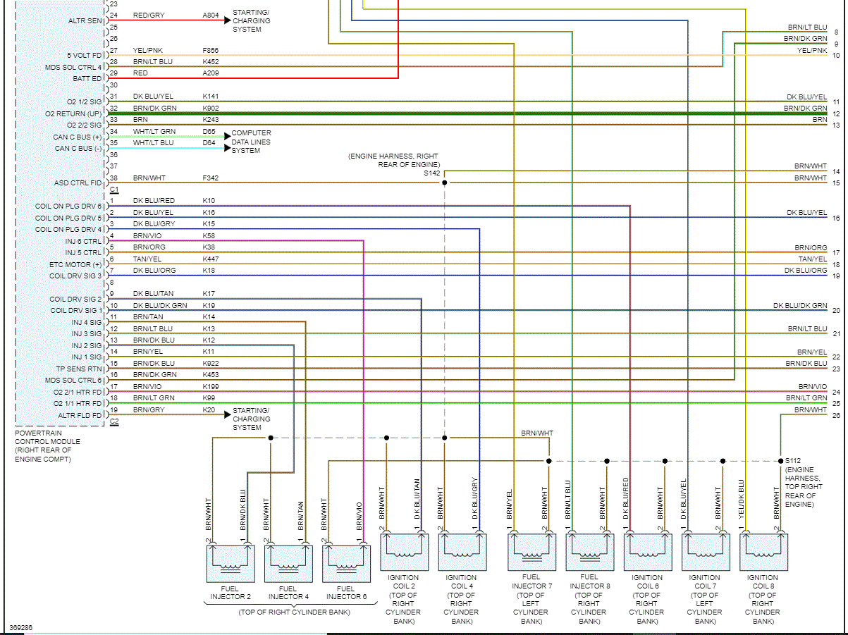

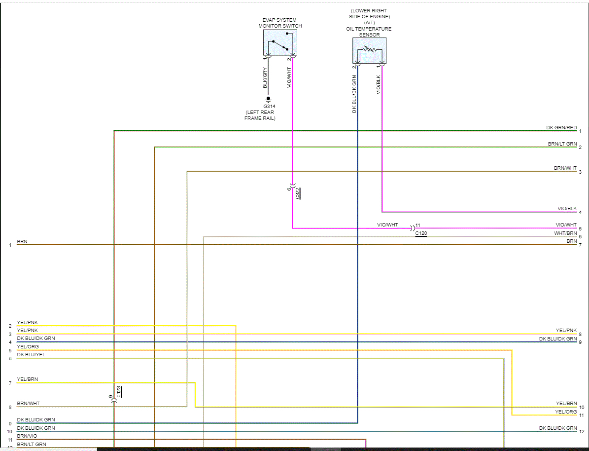

No problem whatsoever. If you look below, I included the schematics. They were 5 pages long. However, I had to cut them in half to make them readable for you. I did overlap them so you can follow from one to the next.
I'm not sure what you are working on, but here is a link you may find helpful.
I hope this helps. Let me know if you have questions or if I can help.
