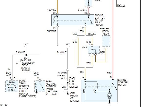

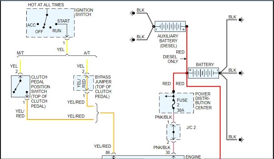

Wires that are red green and black and it won't start.
Tuesday, July 30th, 2019 AT 11:25 PM
  • 110,192 POSTS
Welcome to 2CarPros.
Can you describe what is happening with the wires you mentioned? Also, is the starter engaging or does nothing happen?
I attached 2 pictures. They show the entire starting system (starter circuit). I had to break it into two pictures to make it readable, but I did overlap it so you can follow it. Let me know if the wires you are referring to are shown in the schematic. Also, I need to know what is happening with the wires you mentioned.
If the starter is in question, here is a link that shows how to test a starter:
Here is a link related to a crank/no start condition:
Let me know if any of this helps or if you have other questions.
