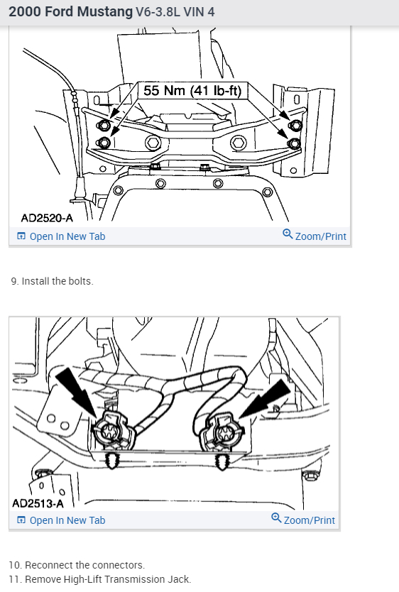

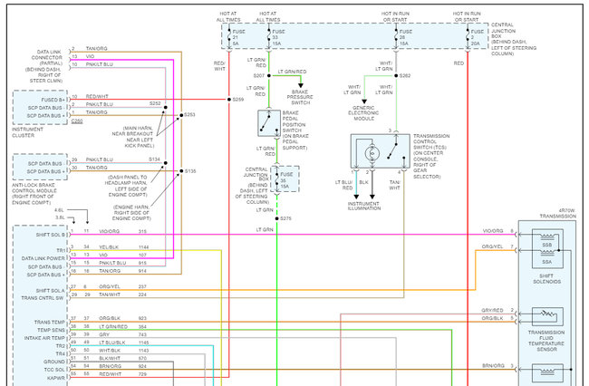

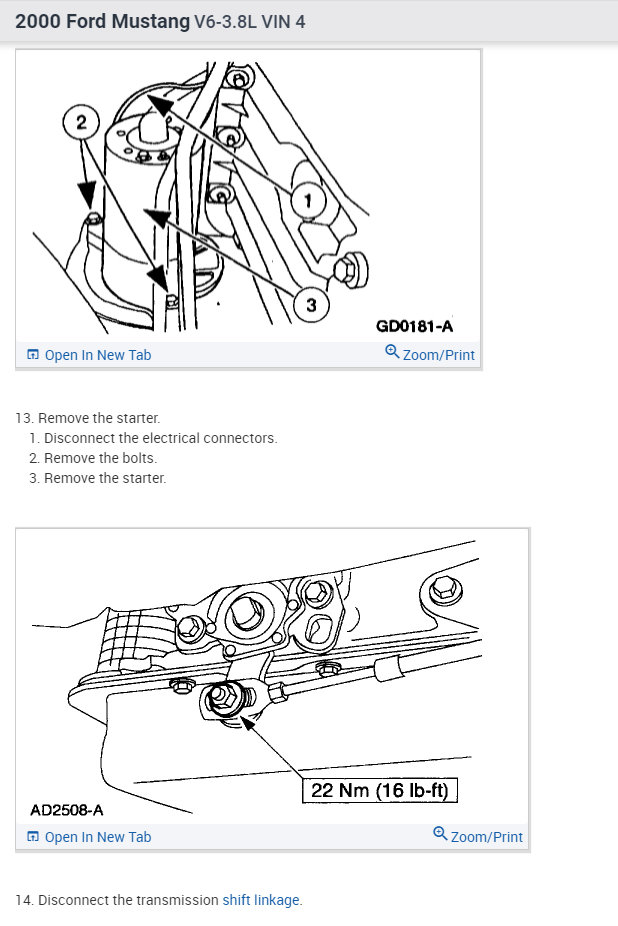

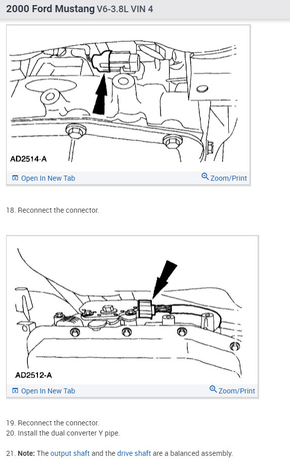

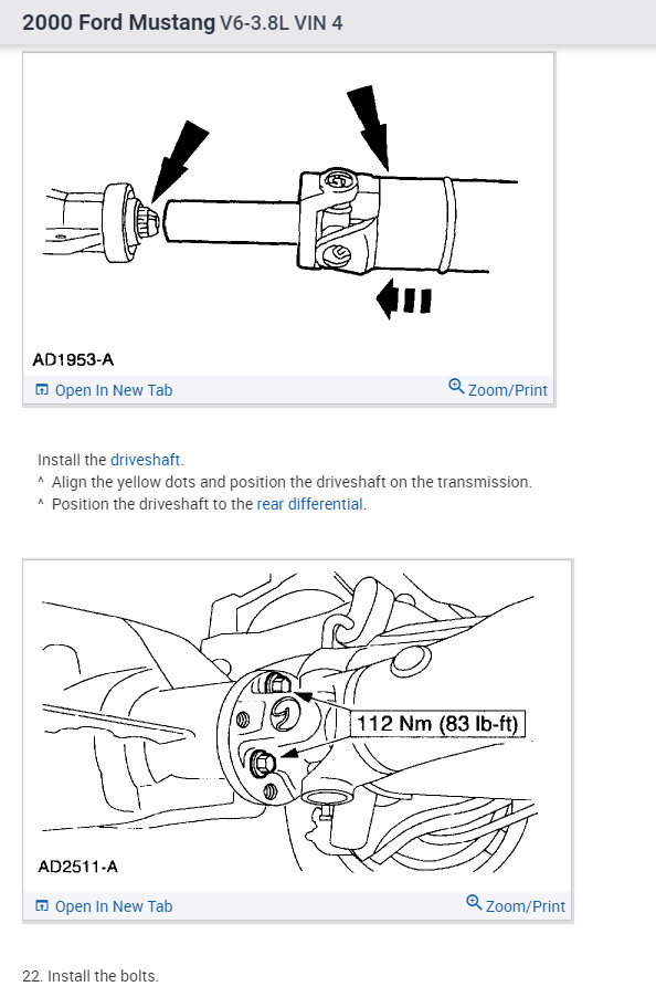

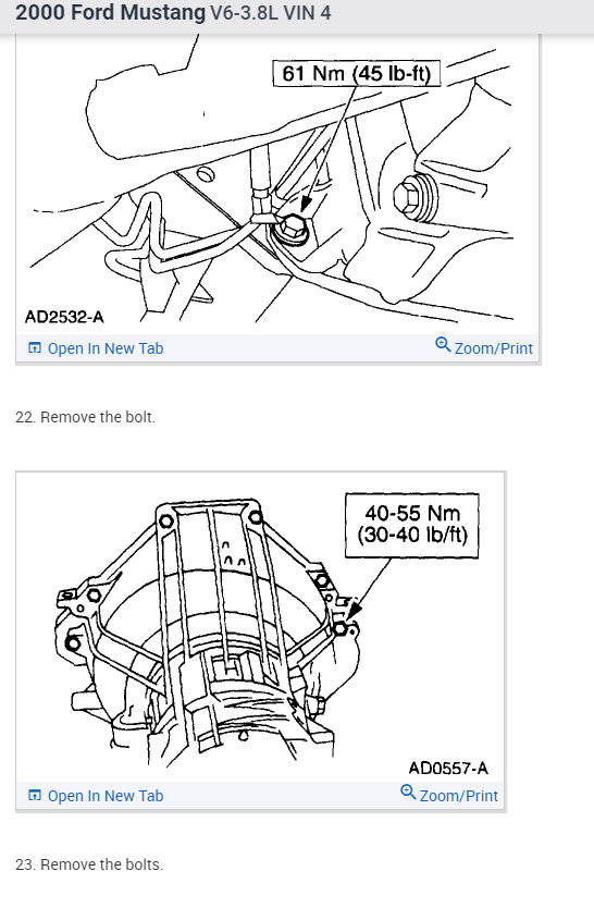

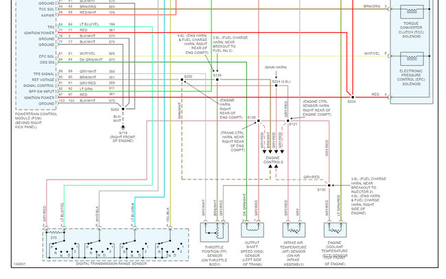

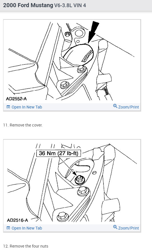

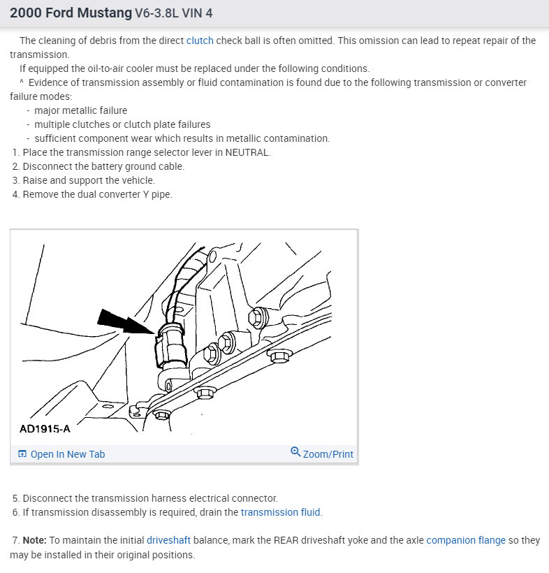

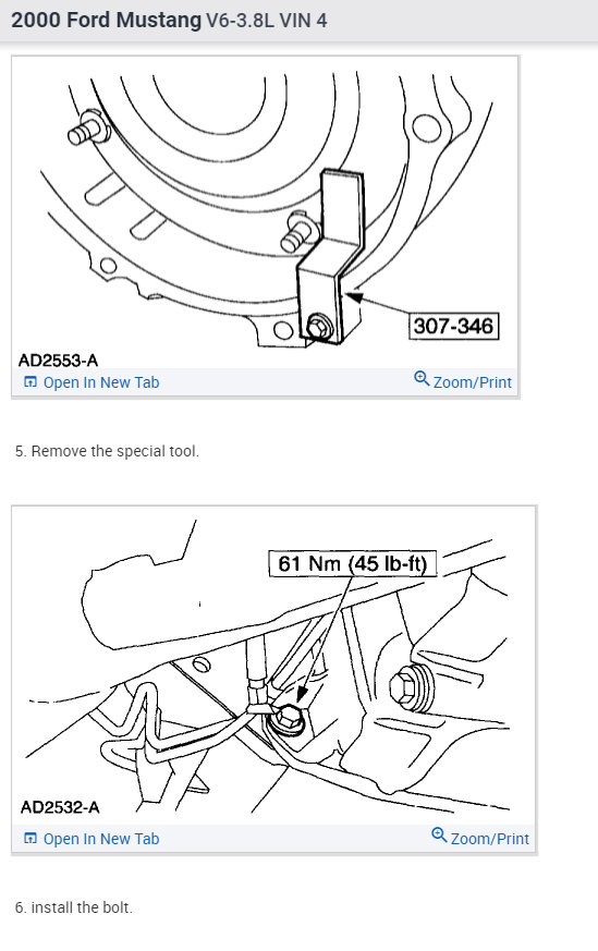

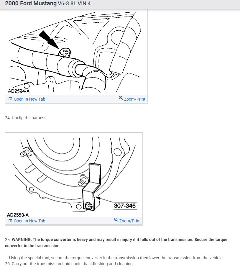

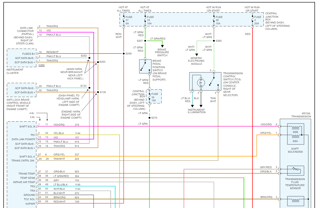

I need a diagram for the transmission wiring for my car. 'm installing a 4r70w 3.8 v6.
Monday, February 21st, 2022 AT 4:19 PM
SQM
MECHANIC
6,383 POSTS

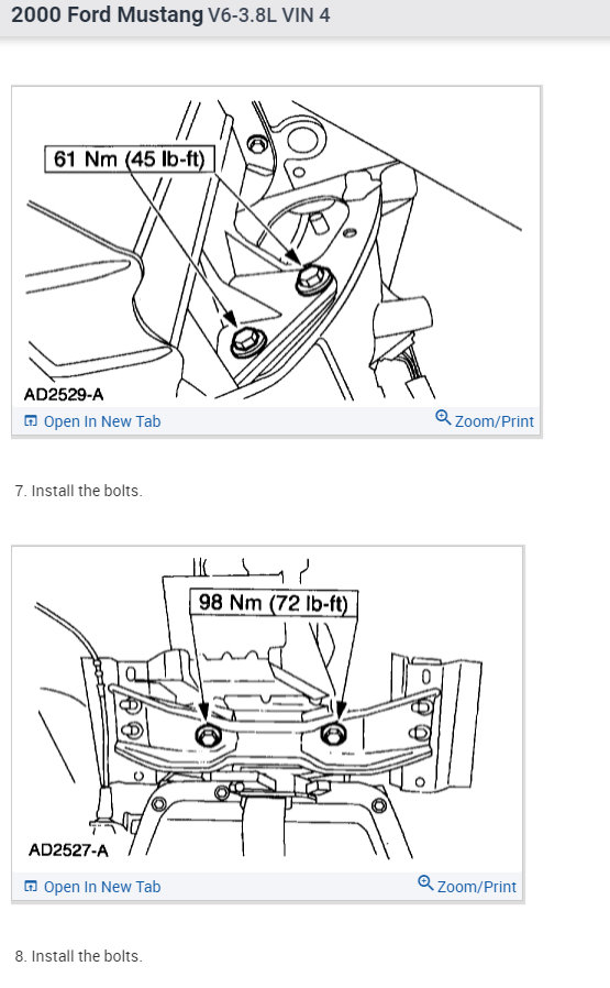

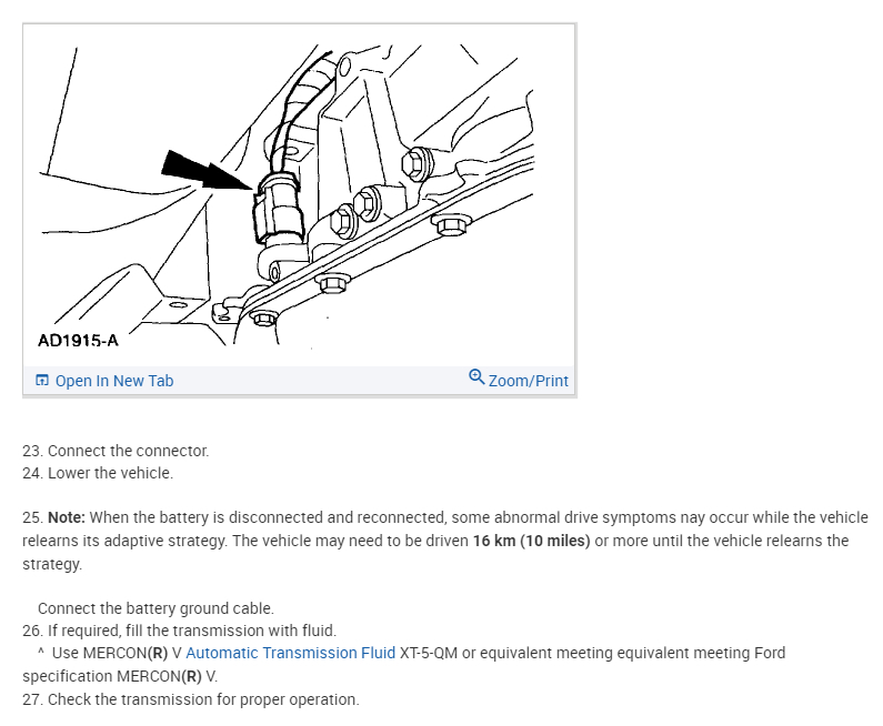

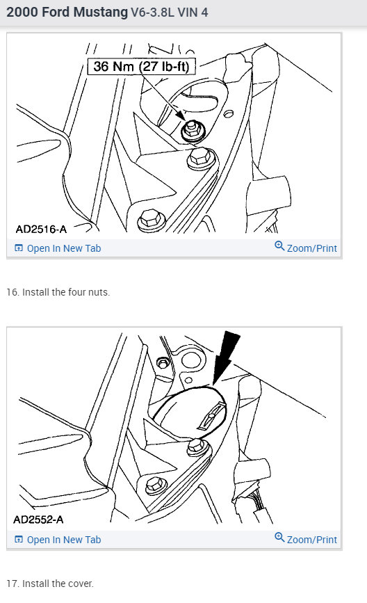

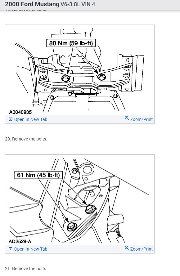

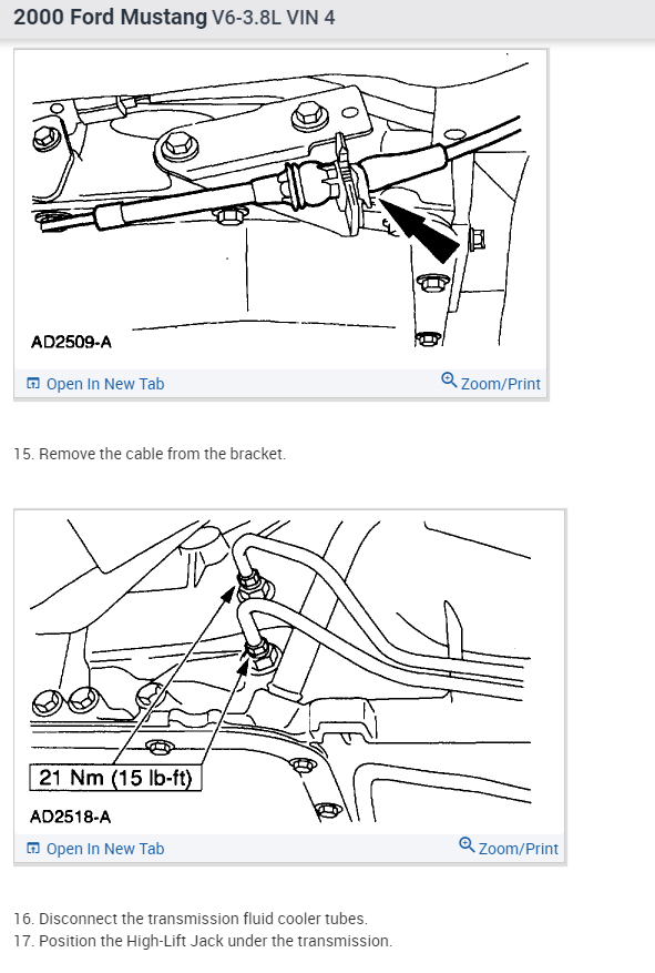

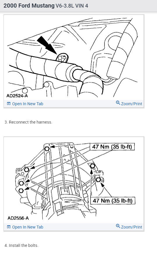

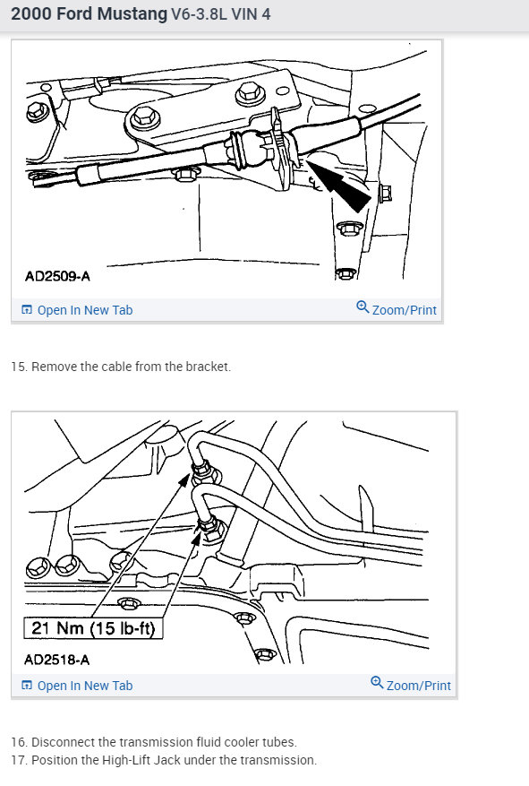

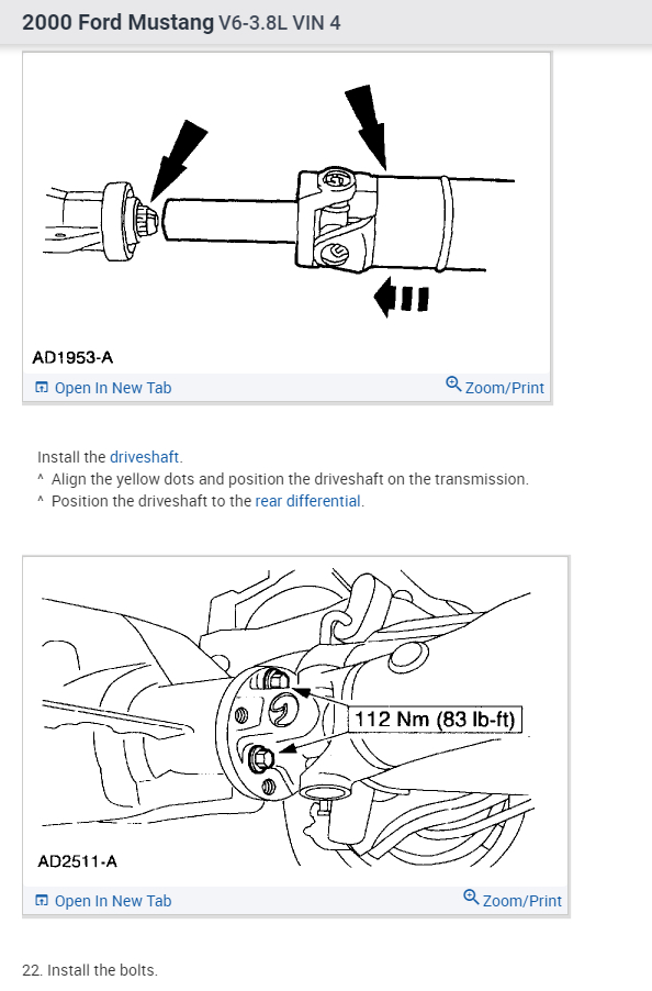

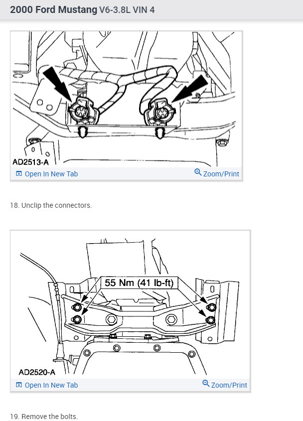

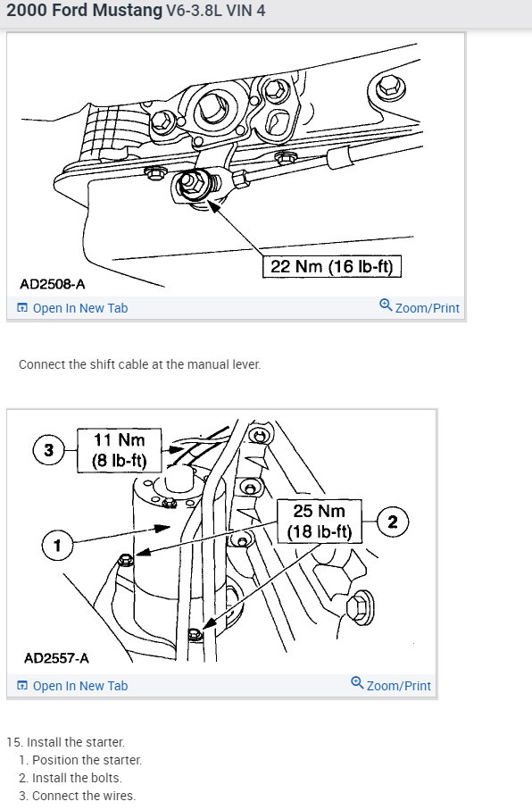

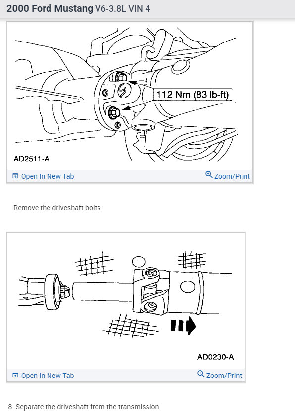

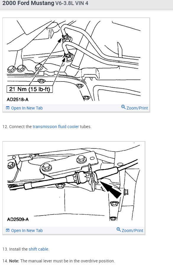

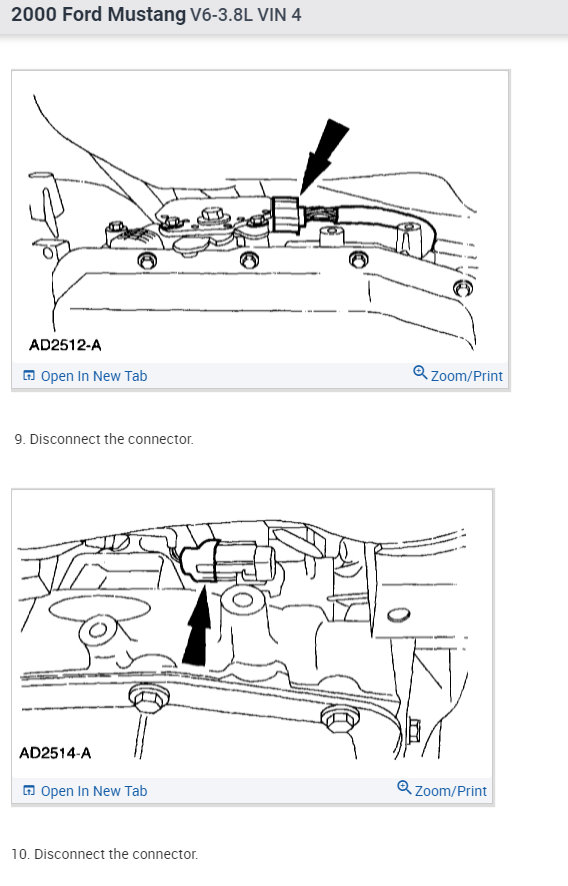

I have attached the wiring schematics for the transmission below.

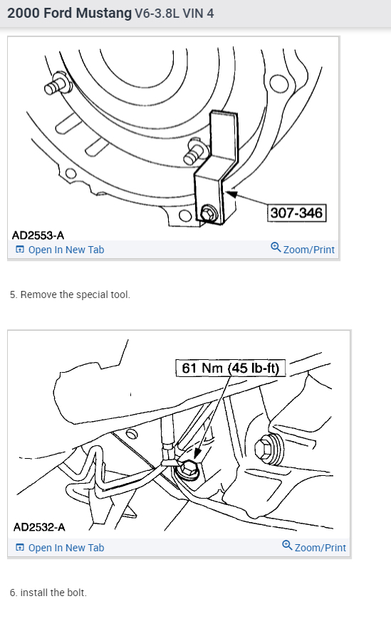

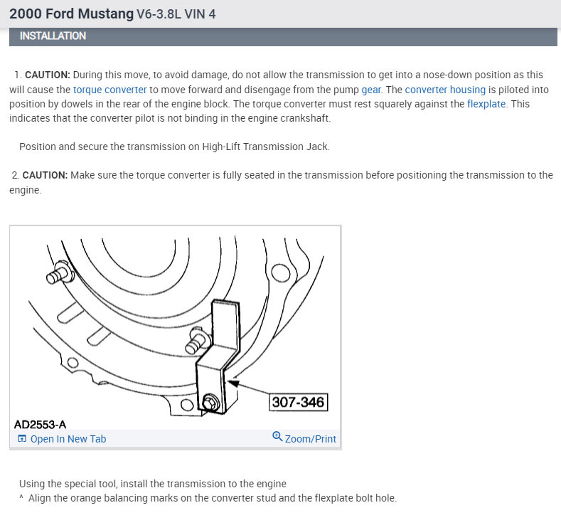

I have also attached the transmission replacement procedure below.
https://www.2carpros.com/articles/how-to-remove-an-automatic-transmission-rwd
