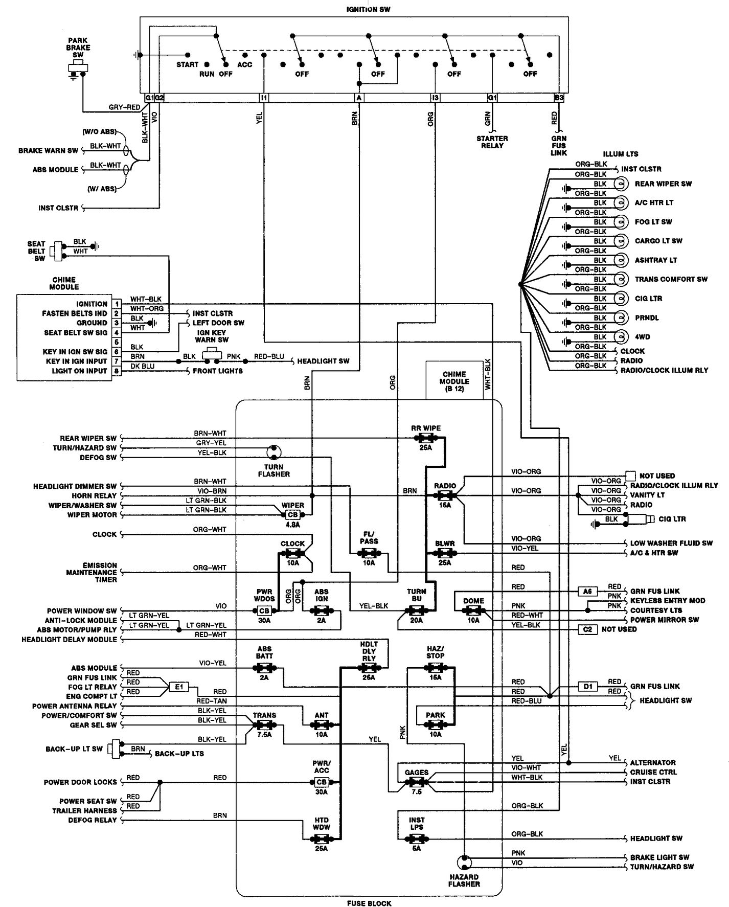

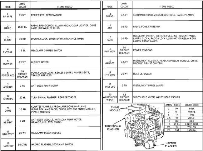

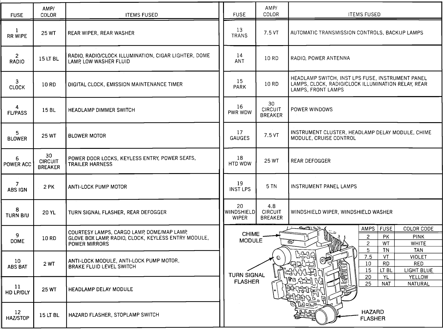

Some clips broke off of the fuse box terminal strips and I have been replacing them. Well, I forgot to take a picture before I started and I was wondering if you might have a picture of the inside of the fuse box so I know what wires go where?
Saturday, July 15th, 2017 AT 11:16 AM
STEVE W.
  • 15,702 POSTS
These are about the only items I can find that show any type of layout. If you follow the wire colors and fuse ratings it should help.
