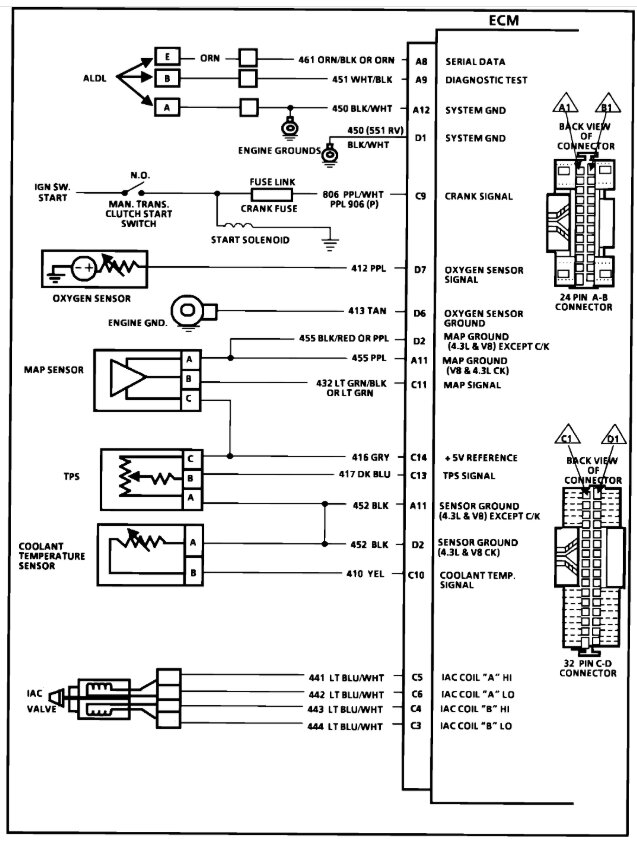

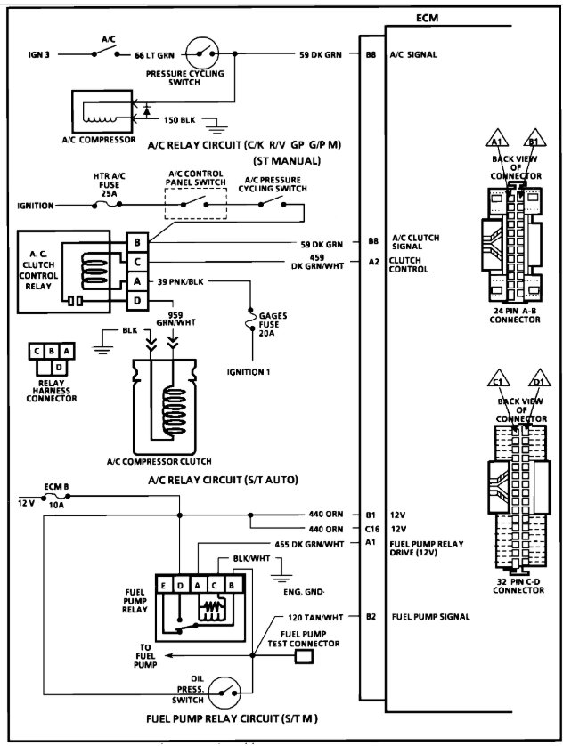

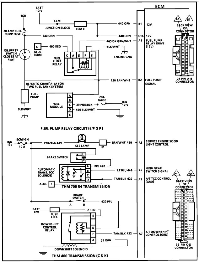

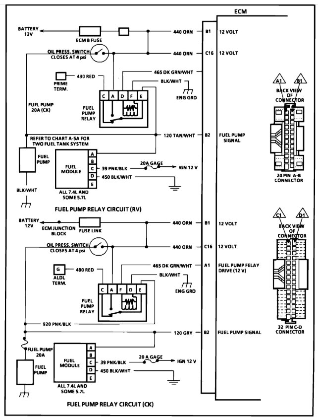

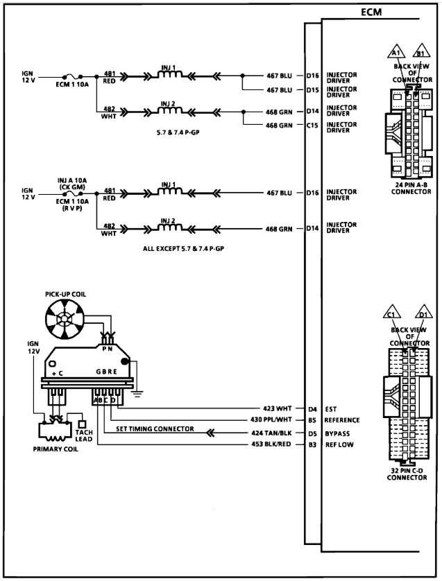

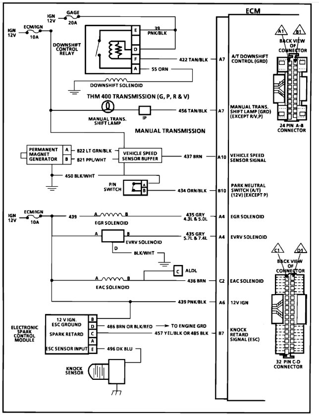

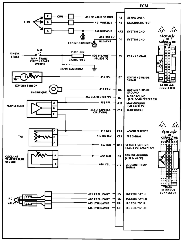

Wire harnesses were butchered and I’m trying to get back to factory specifications. I need engine harness/and sensor location for everything under hood, also the wire harness diagram for in cab harness including specs. please help.

We only handle one request at the time, here are the engine wiring diagrams for the 5.7 liter engine, please start new threads for the other issues, this guide can help you with the testing.
