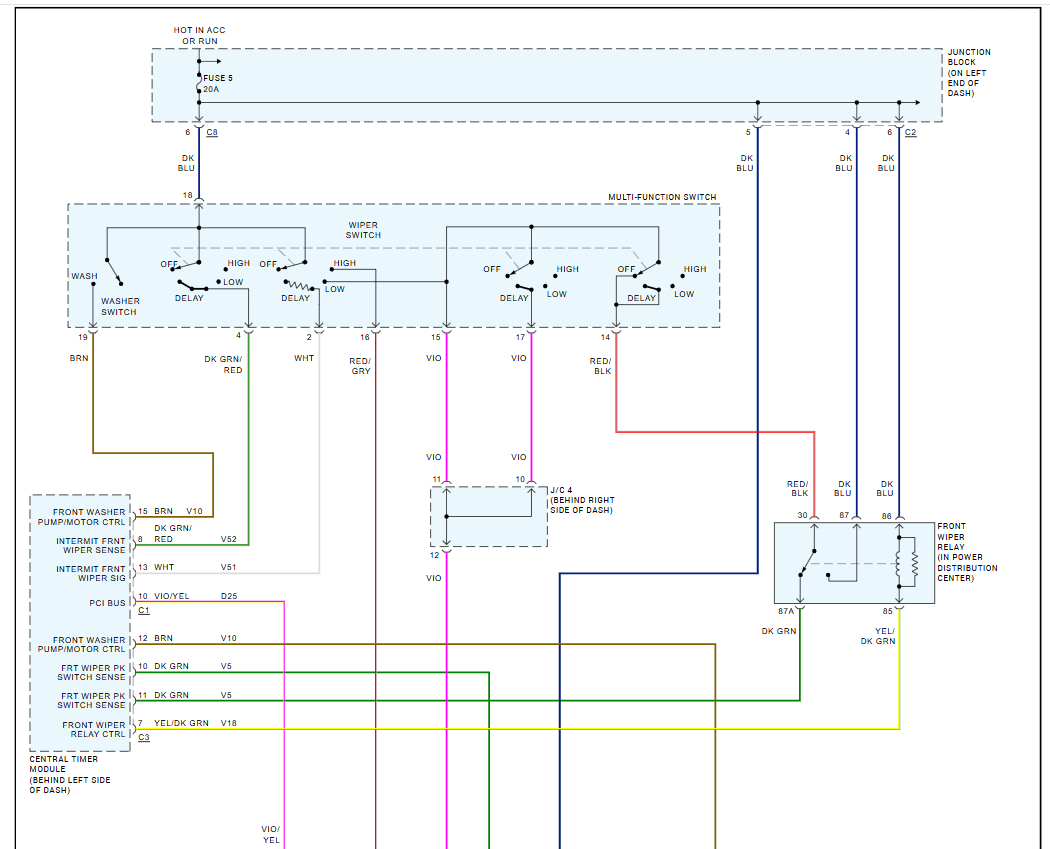

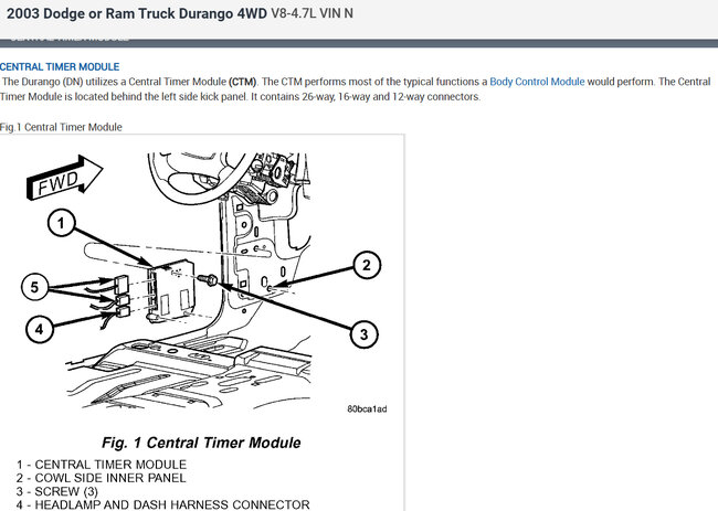

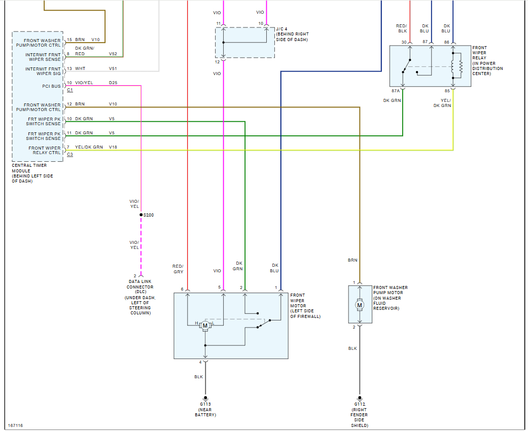

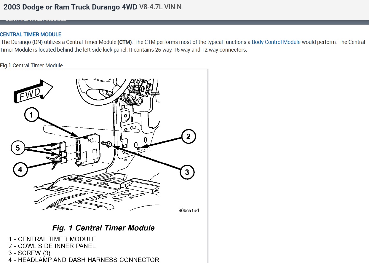

It sounds like the central timer module at the left side of the dash has done out, here is the location so you can swap it out which should fix the problem. I also included the wiper wiring diagrams so you can see how the system works. Check out the images (below). Let us know if you need anything else.

Hi, Ken! Thank you so much for your help! Would I need to have the CTM backed up or can I just swap this part out? If I were to buy a used one it should already be programmed, right?

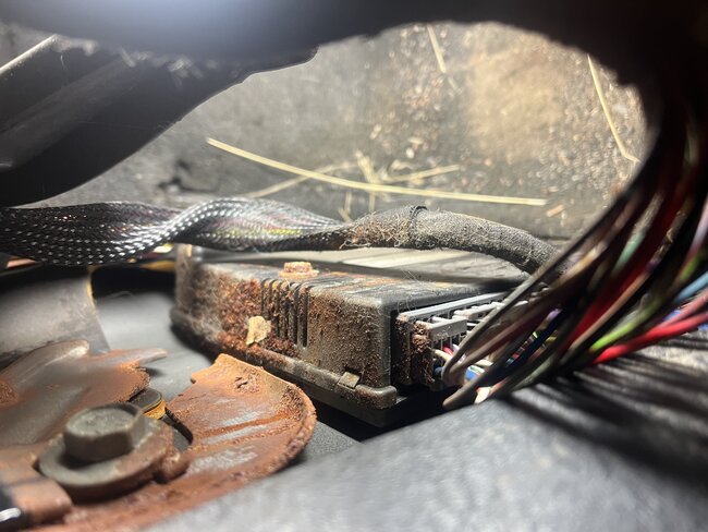

She is certainly all rusty.

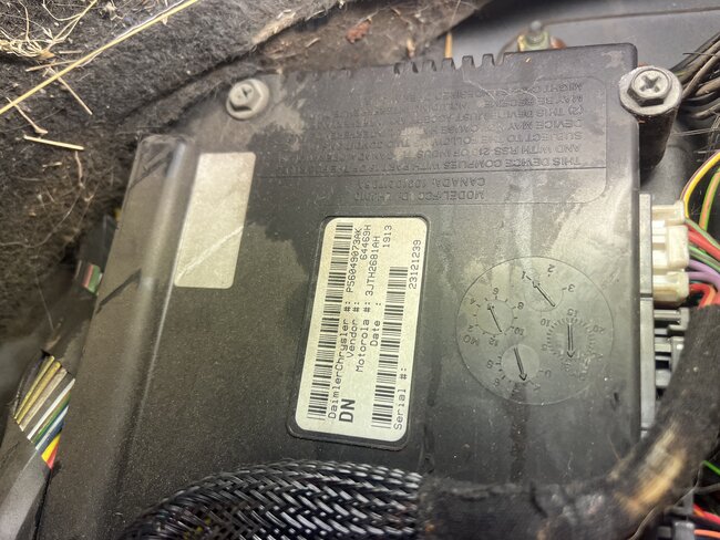

Side view.

Yep, I would get a used one from eBay, thanks for the images they help. They don't need to be programmed.
