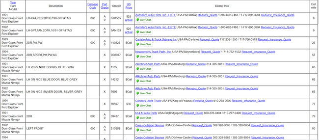

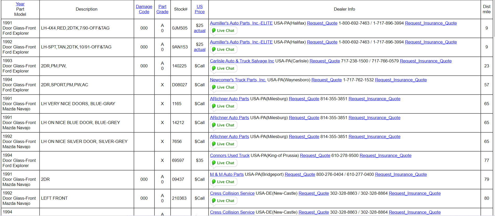

I have the vehicle listed above (Sport) that needs a driver side window. What other vehicles are interchangeable?

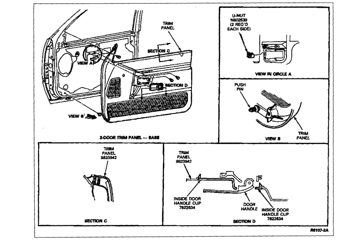

Good afternoon,
I attached the used parts available and it is the same from 1991-1995.
https://www.2carpros.com/articles/how-to-check-and-replace-a-electric-power-window-motor
I attached the available glass from www.car-part.com for you. There are many pages of possible purchases.
I also attached the picture of removing the door panel to gain access to the window.
