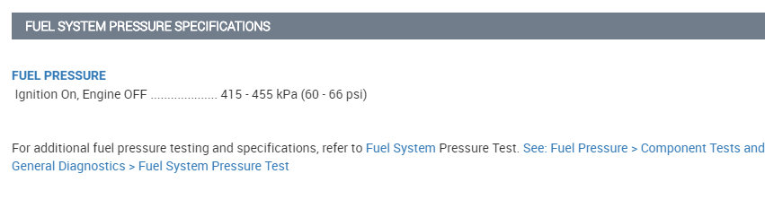

On my way home from work I was going down the highway about sixty mph and all of sudden it acted like it was running out of gas.
So I pulled off in a lot almost immediately. Walked to a gas station and got the only one gallon tank they had. I put the gas in and it will not start. I can hear the fuel pump kick in. And the pressure valve squirts gas. So it should be getting gas.
Why will it not start? And what else could cause it to act like it was running out of gas?
And yes I do have a functional gas gauge and the low fuel light works. I am just the person who tried to push it and get home. I should have had enough gas to get there. That is why I am asking if anything else could cause the issue.
Thanks

You will need to check the fuel pressure itself. Just because it has fuel at the valve does not mean it is enough to make it run. You will need a tester for the pressure. You can rent one at a parts store.

The numbers below refer to the step numbers on the diagnostic table.
2. Wrap a shop towel around the fuel pressure connection to absorb any small amount of fuel leakage that may occur when installing the fuel pressure gauge. Turn ON the ignition, the fuel pressure should be 415 - 455 kPa (60 - 66 psi). This pressure is controlled by a spring pressure within the regulator assembly.

I put extra gas in and bled as much air out as possible, and let the injectors prime really well and jumped the battery. It started up and seems to run well. I will just have to keep an eye on the gas gauge and pay extra attention to the way it acts for a good while.
Thanks for the help.
