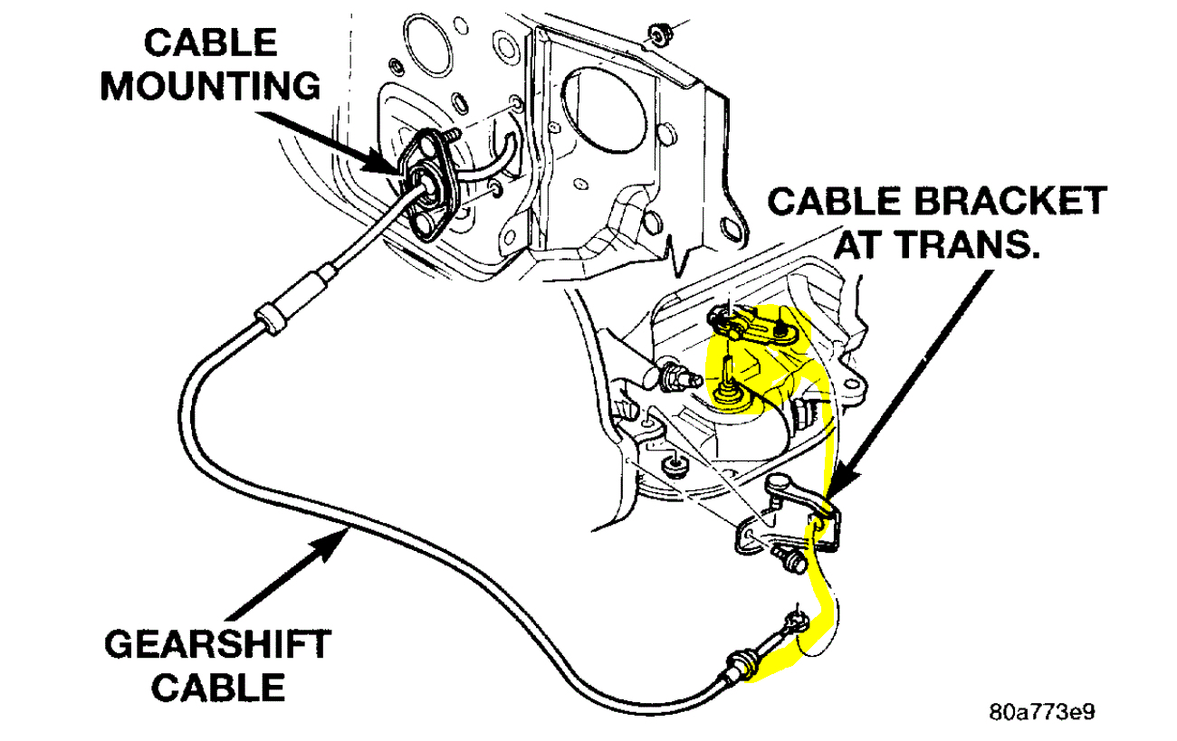

Vickie,
When you shift the gears, does the gear indicator change to the selected gear, or does it not change? Also, you indicated it was staying in second gear. When you place it in park, what happens? For example, does it still feel like it's trying to move but is being held by the park gear?
Also, confirm the shift linkage is moving at the transmission. You will need a helper to shift through the gears. Make sure it is attached to both the mounting bracket and shift lever properly.
See pic below (shift cable at transmission)

Hello, thanks for your help. When I shifted into park it felt like it was in park. And when I try manually shifting the gears nothing changes. It does go into drive when I'm stopped and shipped into drive you can feel it engage like it's supposed to, but then once you continue it never gets out of first or second gear. When I shift into neutral it goes into neutral. When I shift into park it parks. When I shifted into reverse it goes in reverse but there is a whining noise kind of reminds me of when the power steering fluid gets low that sound, but the fluids don't have a smell like it's burnt it doesn't seem to be gritty it does look a little darker. I will check the linkage in the morning and let you know a friend's supposed to come help me with that.

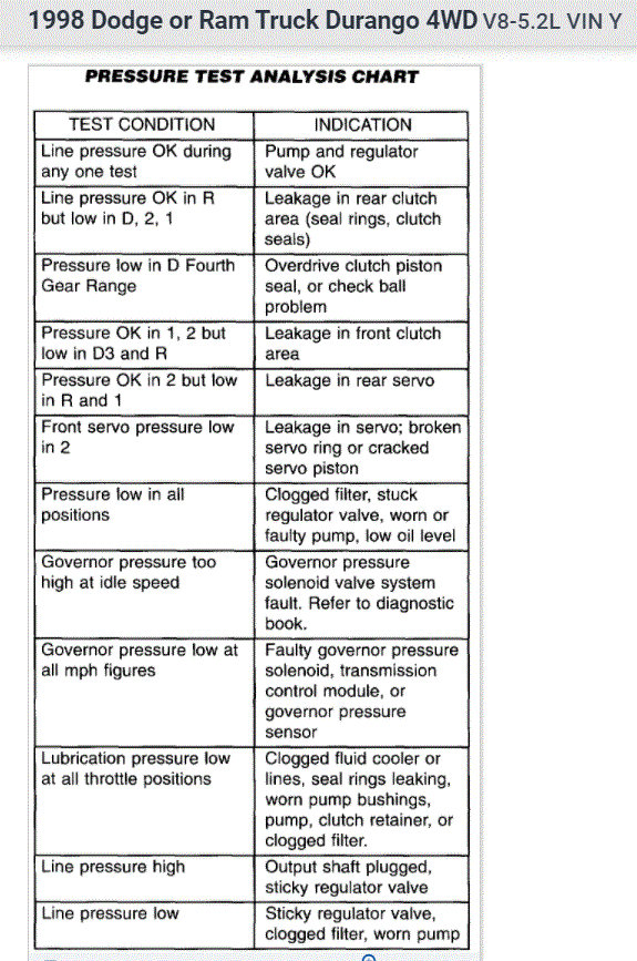

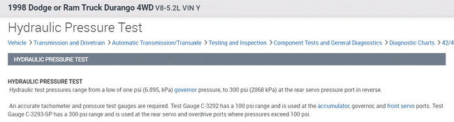

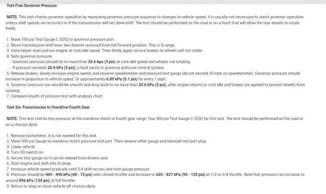

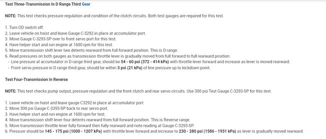

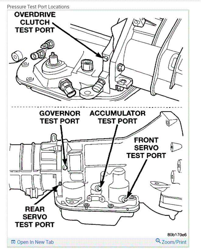

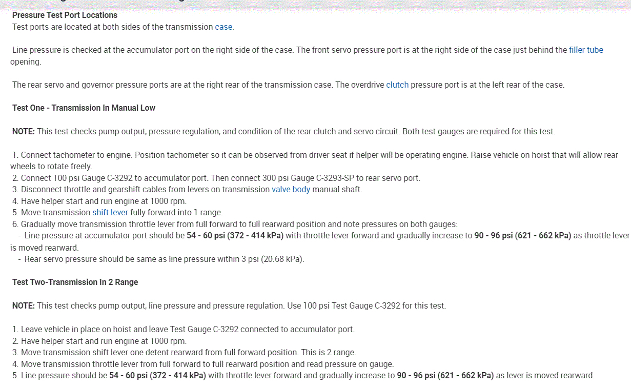

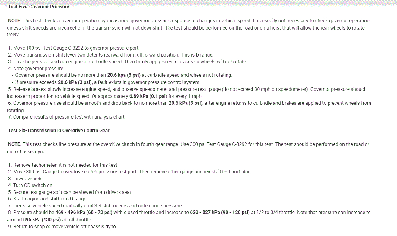

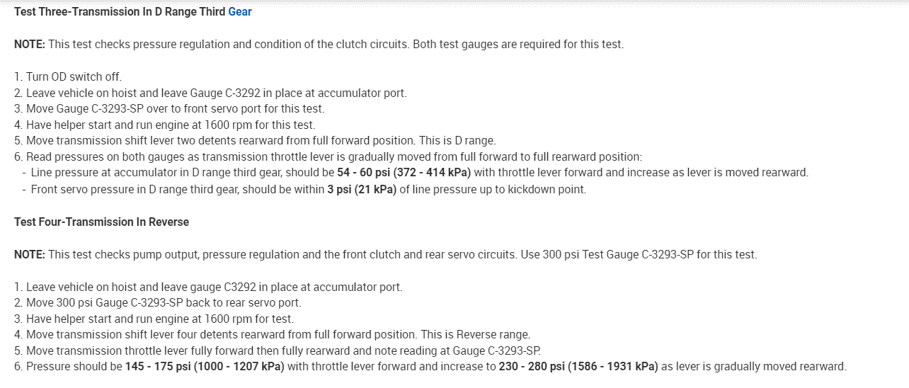

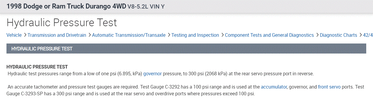

  • 110,194 POSTS
What did the plastic pieces look like?
As far as line pressure, you need pressure gauges that are able to handle over 300 PSI. Something is telling me that you won't get that high because of issues, but that is a possibility.
I attached the directions below for testing line pressure. Take a look through it and see if you are comfortable doing it.
Also, do the AT cooler lines from the transmission go to the radiator or does it have a remote cooler?
