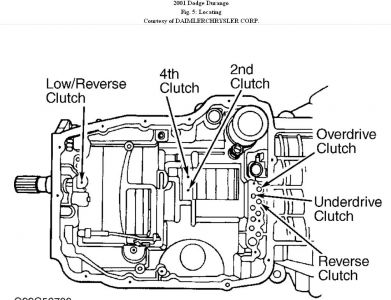

In 3rd speed, the elements in use are the Underdrive and Overdrive clutches.
Is the trouble code still the same?
Under drive clutch is used by 1st and 2nd speed as well so you have a possible OD clutch or its pressure lines.
Was the OD accumulator piston damaged when it dropped off?
You would need to perform a line pressure test for the OD clutch to confirm the line pressure. Special tools would be required.
You can perform a clutch pressure test to confirm if the clutch is operating correctly.
CLUTCH AIR PRESSURE TESTS
Test Preparation
Remove valve body.
CAUTION:Ensure air supply is free of all dirt and moisture.
Test Procedure
Apply 30 psi (2.1 kg/cm2 ) of air pressure to each test passage. See Fig. 5 . If clutch is functioning properly, a soft thump should be heard as clutch is applied. Clutch application can also be felt by touching the appropriate element while applying air pressure. As air pressure is released, clutch should also release. By comparing road test, hydraulic pressure test and clutch air pressure test information, area of fault may be closely identified.

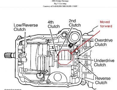

FREEGB1
  • 9 POSTS
Ok, as soon as I saw your post, I went out and dropped pan and VB again. I tested every port, and I had the thump you described at every one except rev(which just spewed fluid everywhere, not sure if result is typical), and when I applied pressure to the OD port, a metal ring moved forward with the air, and moved back when released. I dont know if this what is supposed to happen.
https://www.2carpros.com/forum/automotive_pictures/563850_pressure_check_1.jpg
Saturday, August 21st, 2010 AT 1:20 PM
KHLOW2008
  • 41,814 POSTS
To OD clutch seems to be good as the movement is what it should be doing when air pressure is applied but for the low reverse clutch, if fluids are spewing everywhere with no thumpimg noise to indicate the clutch is engaging, it indicates there is a leakage.
Retest the Low Rev clutch again to see if there is a thumping. Sometimes I there are excessive fluids, they might spew out a little but ensure a thumping noise is present.

Ok, I rechecked, and what happens when I apply pressure to the reverse clutch port, is that same object that moved forward with pressure to the OD port, moved to the reverse.
Also to be clear, the fluid mess was a result of the pressure around the tip of my air nozzle, not inside transmission
Saturday, August 21st, 2010 AT 1:59 PM
