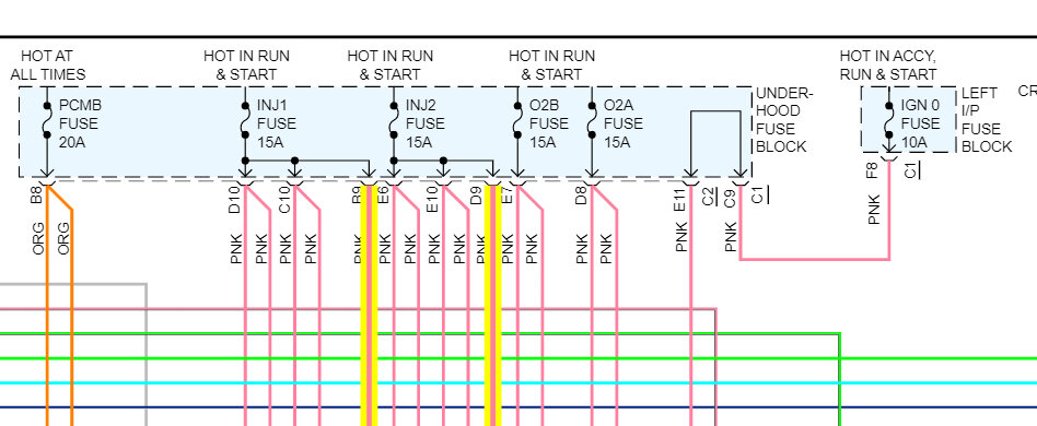

So, I have no spark. There is power at the main coil harness. Not at the individual coil harness. Now what?
Monday, April 24th, 2023 AT 3:51 PM
  • 110,194 POSTS
Have you checked both injector fuses in the under-hood fuse box? They are what power the coils via a pink wire.
Also, when you checked for power at the injectors, how was it done? Did you use a test lamp, multimeter, Noid light? I ask because if it was a Noid light, there may not be a ground path to complete the circuit.
There is a common ground on the left side front/lower part of the engine for all coils. They are known to fail. The connector basically corrodes and falls apart. Check that for me as well.
See pic below.
Monday, April 24th, 2023 AT 7:06 PM

The pink wire is spliced in several places. If any of the splices fail, you will lose power.
Let me know what you find.
