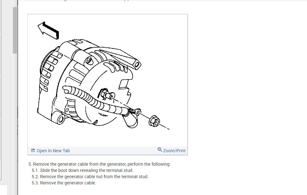

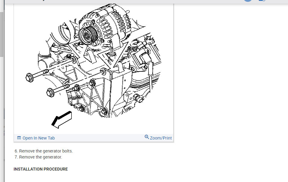

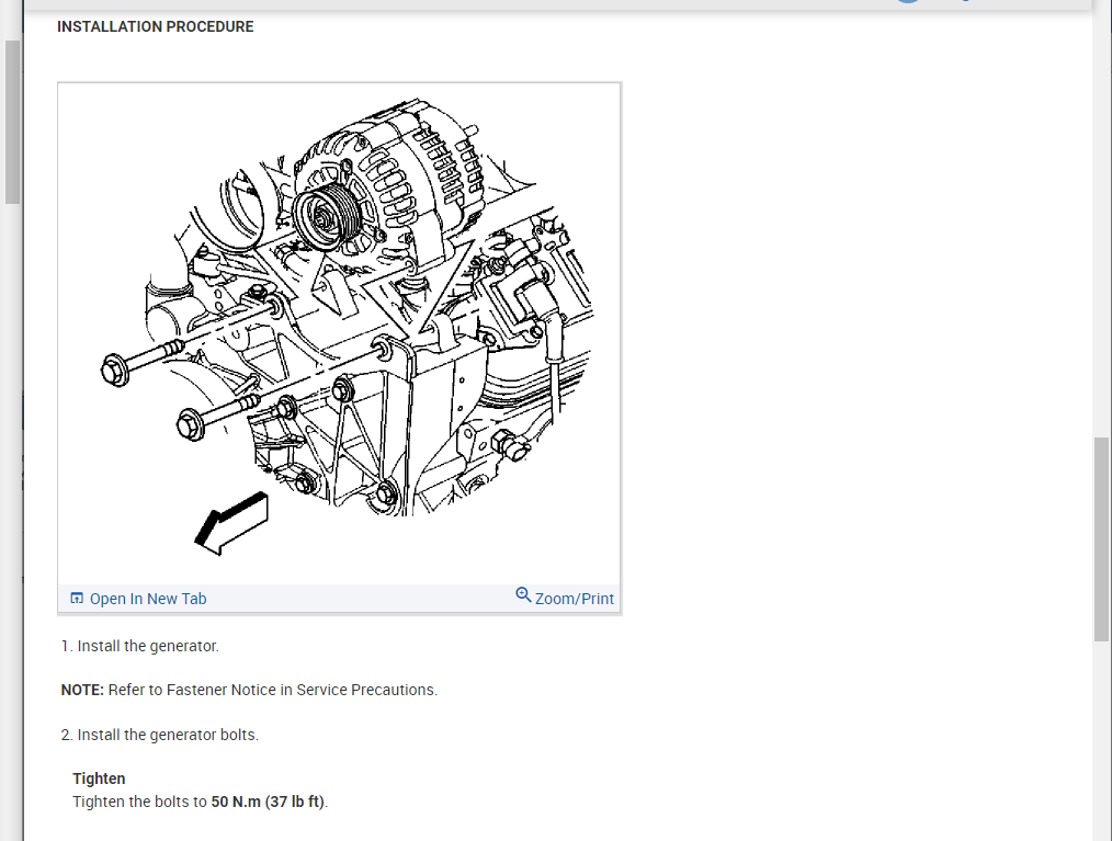

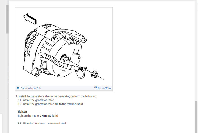

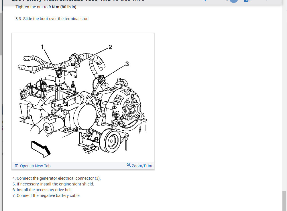

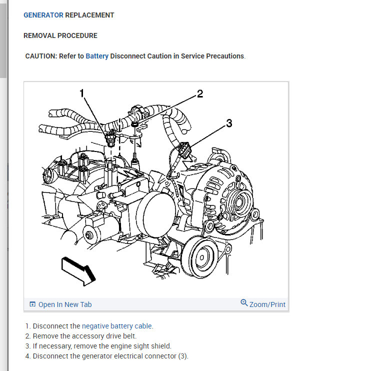

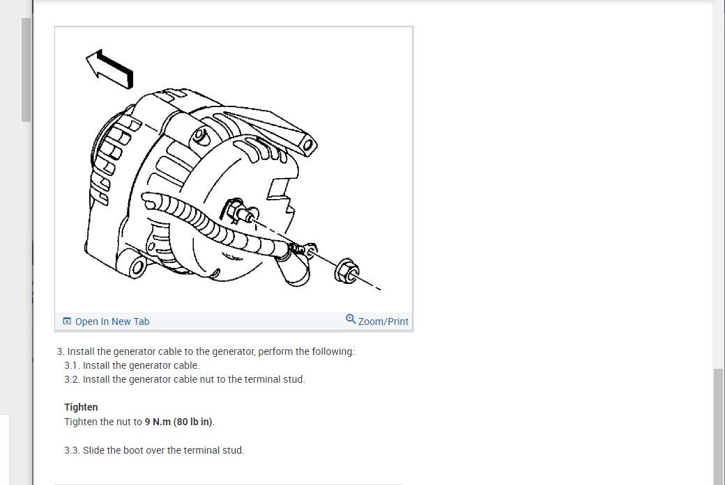

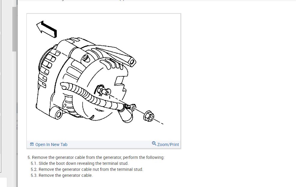

I suspect the alternator has failed and when you are running it, it runs off the battery only and eventually drains the battery.
I attached the process below on how to replace the alternator as I suspect this is the issue.
Let us know what you find and we can go from there.
