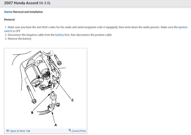

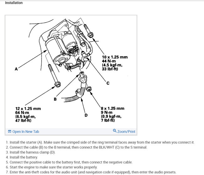

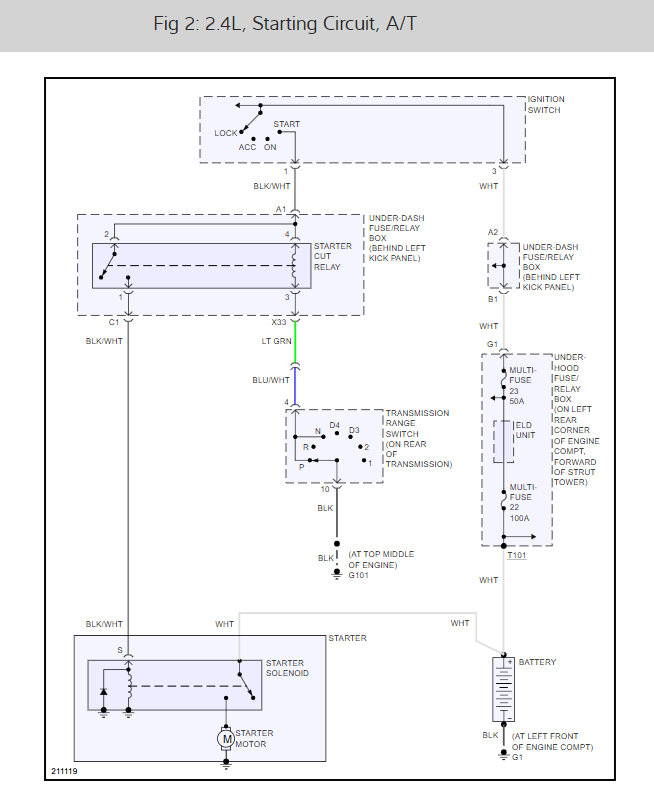

It does sound like the starter is out. To be sure here is the wiring diagrams and a guide to help check for power I updated the link above to help check the starter system so please check that out (I had the wrong link before, sorry) :
There is a starter relay as well we need to check. Here is the location of the relay and how to change out the starter (steps) with diagrams below to show you how on your car.
Check out the diagrams (below). Please let us know what you find.

We had already put in a new starter relay so it definitely was not that. We ended up having it towed back to the dealer and they replaced the battery cables that fixed it thanks for the help.
