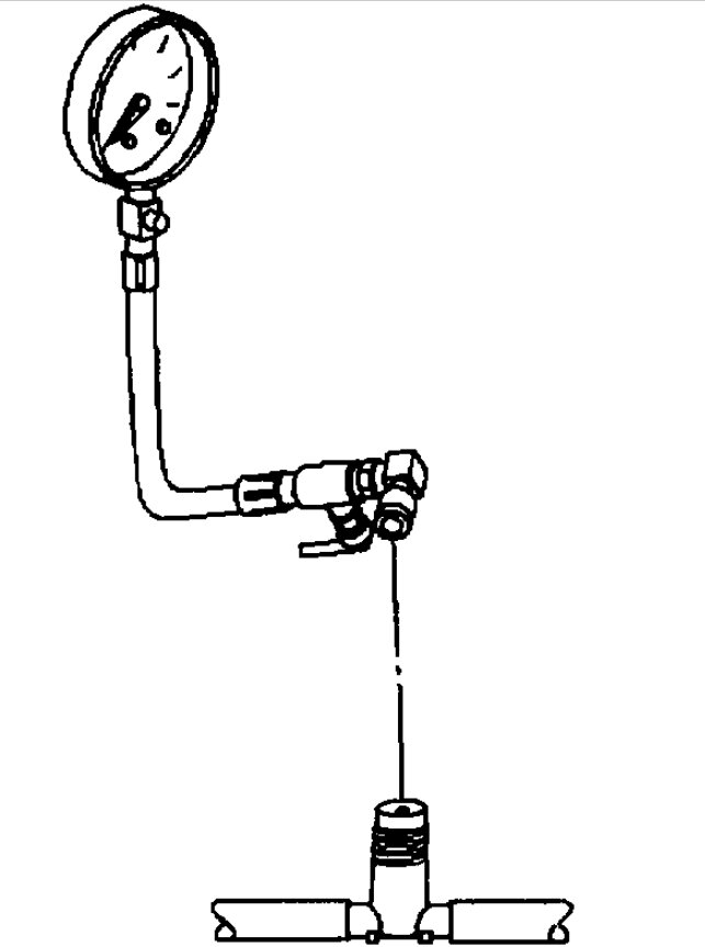

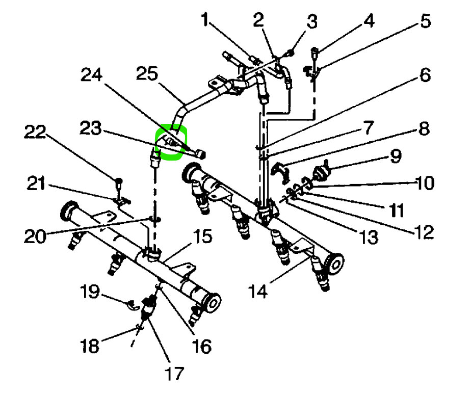

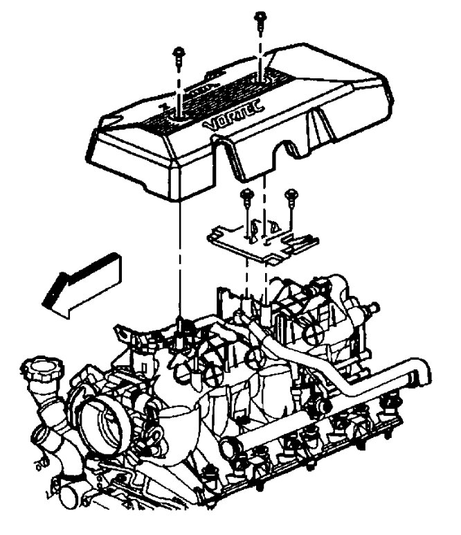

It looks like there is a fuel pressure port on the connecting hose that runs in between the two fuel rails, you'll have to take the top cover off the engine to see it. To release the fuel pressure in the rails before putting the gauge on, you can pull out the Fuel pump relay and start the vehicle until it stalls out. Then open the gas tank cap, which will help with any pressure built up in the tank, then install the pressure gauge on the fuel rail, reinstall the relay, and turn the key to On and it should prime the fuel rail for 2 seconds. Then watch to see if it drops off quickly.
