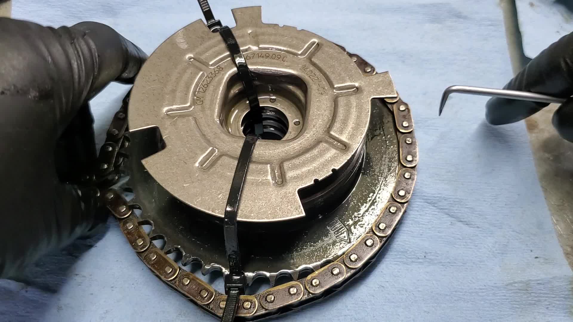

- Whine/buzz like a power steering pump low on fluid.
- Started about 2000mi ago
- Noise varies with engine speed. Same in all gears, park, neutral and reverse.
- No codes. Engine runs fine, good power, transmission shifts fine.
- Removed all belts (serpentine, AC and vacuum pump) - noise unchanged.
- Tested trans pressures with scan tool/pressure gauge as per shop manual - all good.
- Stethoscope indicated noise was coming from lower timing cover area.
- Tested oil pressure on scan tool and with manual gauge - 58psi @ 1000rpm, 65psi @ 2000rpms, 70psi @ 3,000 RPMs.
- Tested oil pressure solenoid on scan tool - open 276kPa closed 396kPa.

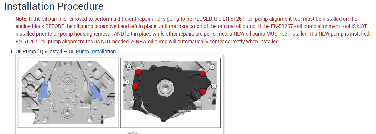

It sounds like the oil pump has come apart internally which is common. This is why they are switching over to a belt driven pump in the newer engines. Can you please upload a short video of the noise so I can tell for sure? Here is the oil pump I am talking about. Check out the images (below). Please let us know what happens.

Hi Ken, thanks for the reply. I do not have a video of the sound. However it sounds just like this video at the 2:30 mark https://www.youtube.com/watch?v=2EuXLIskQtY

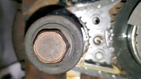

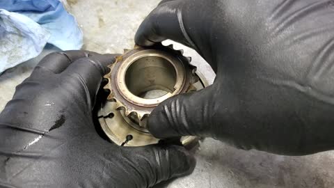

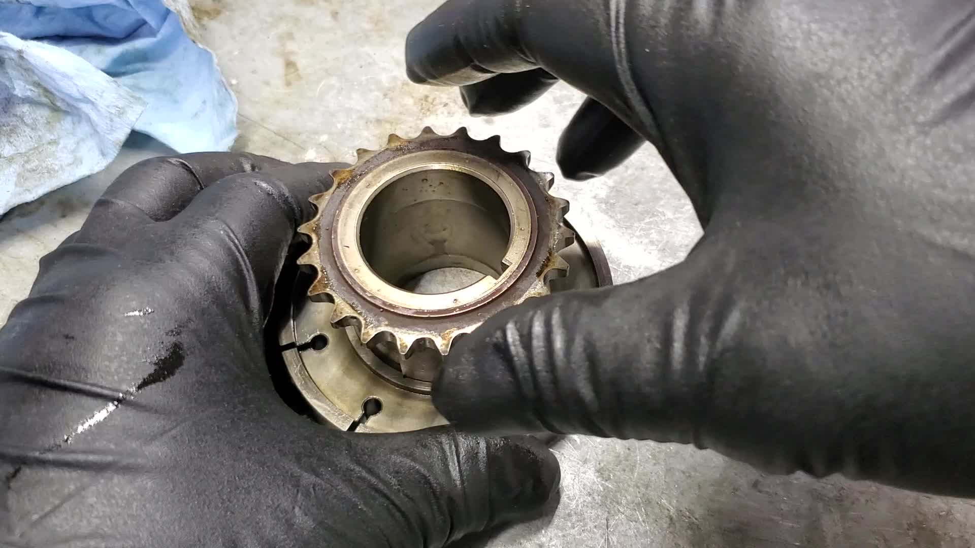

I do have the oil pump and all timing gears out. Here is a link to a google drive with photos and videos of the pump, tensioner, chain, crank sprocket and actuator. I found no wear on the crank sprocket spline or oil pump spline receiver that I could detect with a fingernail. There is a video "crank sprocket to oil pump rotor 2" which shows the fit between two two parts. I would guess a machinist would say "sliding clearance fit" about 1 thou over.

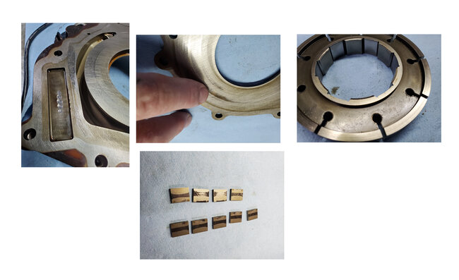

For the various pump wear marks, I could not catch my fingernail on any of them. The wear in the picture "oil pump pressure adjust spring" is interesting to note. I could not find any broken parts in the pump.
Here is the link to all the pics and videos: https://drive.google.com/drive/folders/1ziIZ0si_uYwt1Vn9obM7NbBE-gamIoCR
https://drive.google.com/drive/folders/1ziIZ0si_uYwt1Vn9obM7NbBE-gamIoCR?usp=drive_link

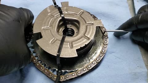

Also there are two videos showing the timing chain slack on the actuator and crank sprockets. "actuator chain slack" and "crank sprocket chain slack 2"

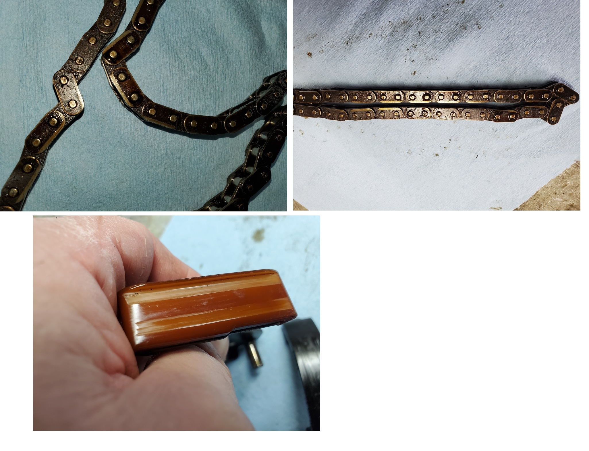

The pictures "timing chain wear" and "timing chain wear 2" show some wear on one side of the chain that corresponds to the guide of the tensioner "tensioner guide"
Also, there are two videos showing the timing chain slack on the actuator and crank sprockets. "actuator chain slack" and "crank sprocket chain slack 2"
The pictures "timing chain wear" and "timing chain wear 2" show some wear on one side of the chain that corresponds to the guide of the tensioner "tensioner guide".

Picture of timing chain wear.

Crank sprocket to oil pump rotor fitment.

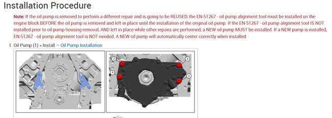

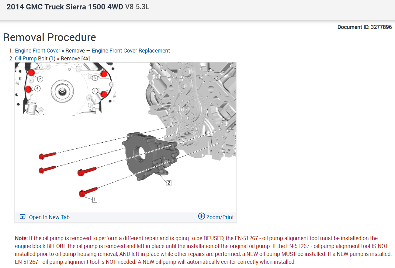

The oil pump.

Video showing chain slack on actuator.

I did not see any broken parts in the pump. Anything special I should look for?
Jan 5, 2025 at 2:14 PM
  • 54,503 POSTS
I think you found it with the loose gear on the crank sprocket to oil pump rotor fitment. Nice work. Also, change the oil and filter that should fix it.

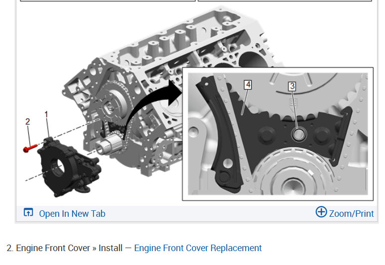

Hi Ken,
I am just installing a new timing chain and want to ensure I have it aligned correctly between cam and crank. The center hole on the tensioner is offset, so it is confusing me a little, and I would like a second opinion.
see video showing the alignment.

Thanks for the video, yep that looks good. I would run it!

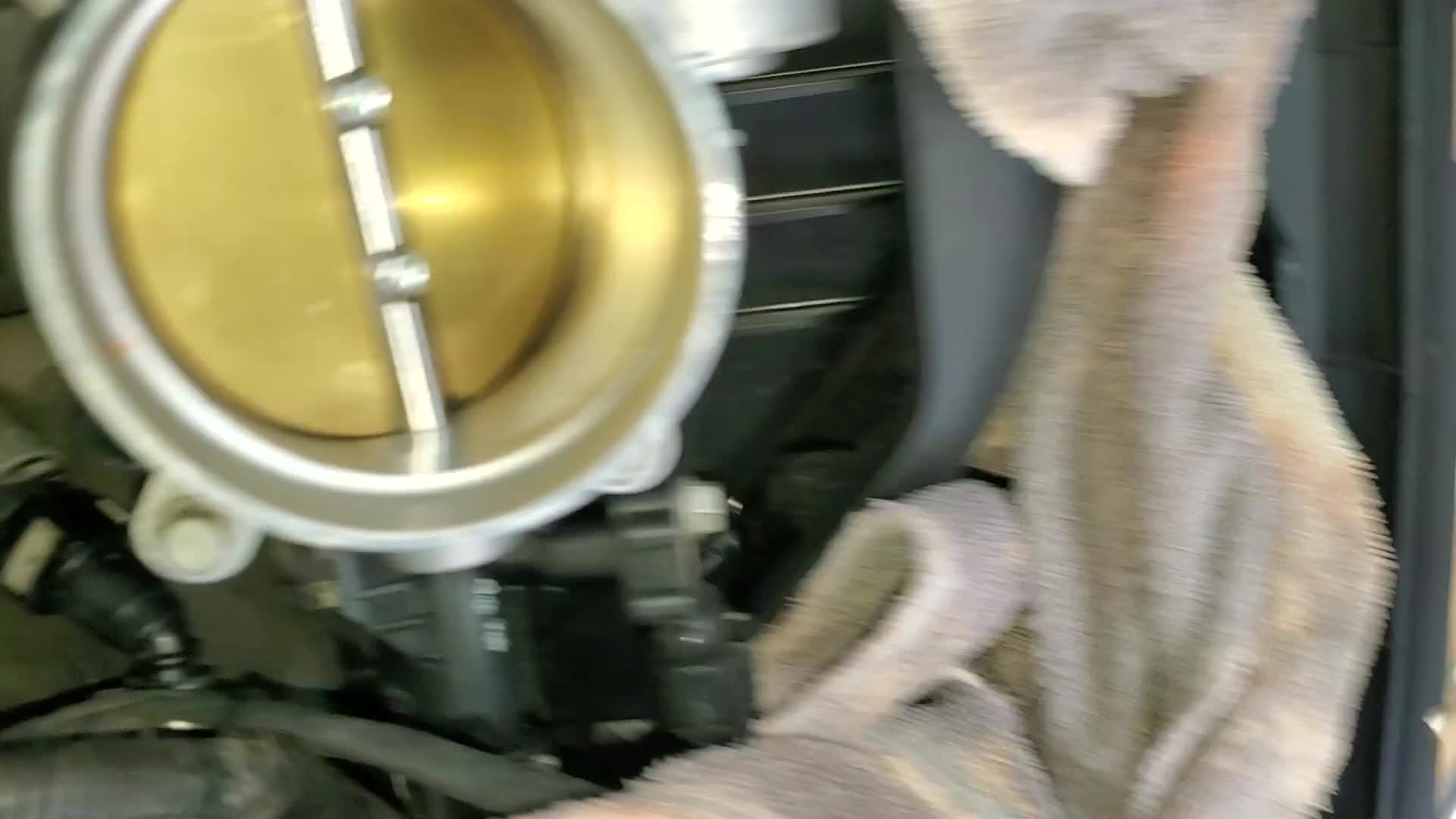

Hi Ken, well everything is fine now. Cold oil pressure are 50psi. I did replace the sensor with new OEM, plus also I did not have the front ground connected, which may have caused a ground float on the sensor.
However, the noise did not go away. Ah well. At least I have some new parts. I think once I get the axle and steering back in I will disconnect the tranny at the TC to make sure it is not trans, then hook up the chassis ears to the scope, and do a bit of noise/vibration analysis.

Hmm, can you start the engine for a second without the serpentine belt off of the engine to see if noise noise going away?
Jan 15, 2025 at 11:29 AM
SHADOWMECH23
  • 17 POSTS
Yes. I removed all the belts (AC, vacuum pump and serpentine) and the noise still persisted. Obviously, my stethoscope skills leave something to be desired.
