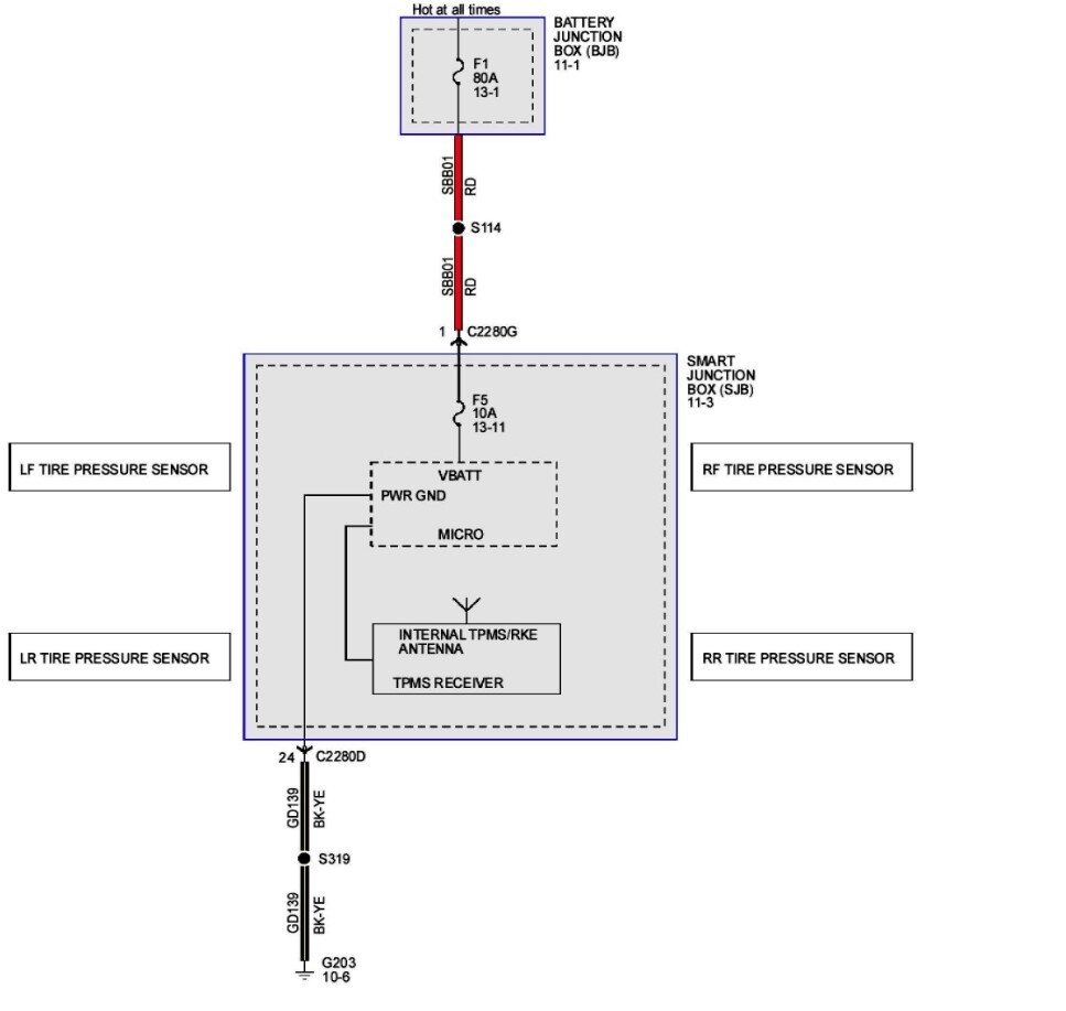

Where is the TPMS receiver module located?
2011 FORD MUSTANG
145,000 MILES • 3.7L • V6 • 2WD • AUTOMATIC
CRDTLD
Right rear tire pressure sensor will not learn.
All new were installed and RR was changed again but still will not learn.
Apr 21, 2025 at 1:32 PM
CRDTLD
Are there any wires or does the sensor directly “talk” to the module?
Apr 21, 2025 at 1:37 PM
STEVE W.
  • 15,172 POSTS
The sensors work on the same frequency as the remote key fob and the exterior combination pads. It is part of the smart junction box (fuse box). You say it's only the right rear that won't come up? Are they OE sensors? Have you tried re-learning them all in order again? I think you either have a bad sensor or something is blocking it because the way the system works it won't let you go past a sensor it cannot read a signal from. The other trick is to do the re-learn with the doors open. That can help with the signal.

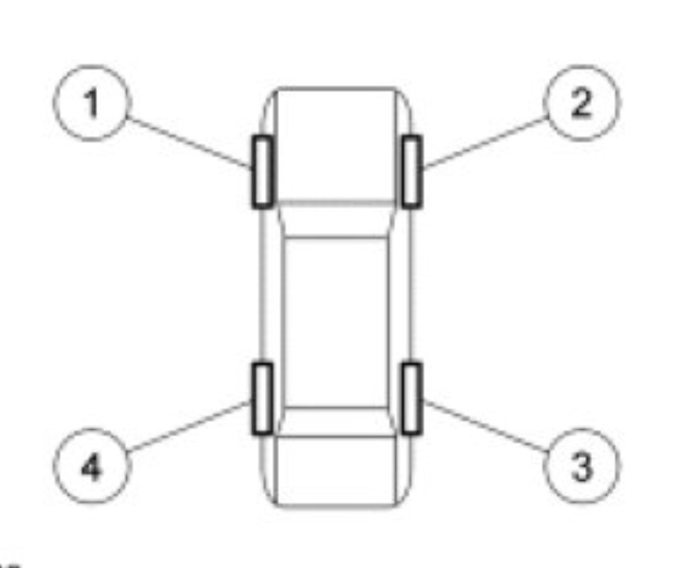

Be sure to follow the pattern in the 2nd image. The Dill 5002 is the correct 315 mhz part. You don't have a 5001 in there? That would be the wrong frequency.

Switched tires RF and RR and followed the sequence you sent
LF relearned then RF failed. So, it failed in both locations.
