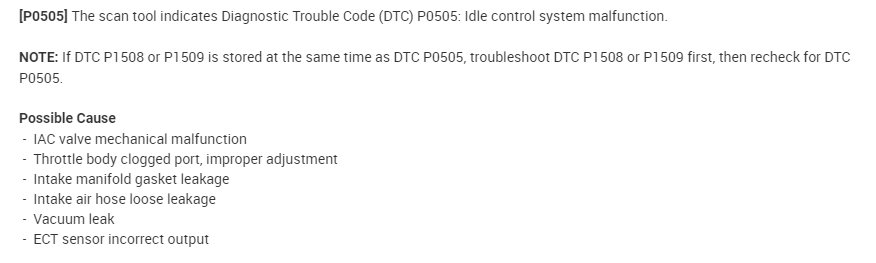

Code P505, where is the relay for the idle air control valve located?
1998 HONDA CIVIC
266,000 MILES • 1.6L • 4 CYL • 2WD • AUTOMATIC
MIKE WP23
We have changed the idle air control valve the TPS and all hoses and still throwing the po505 code.

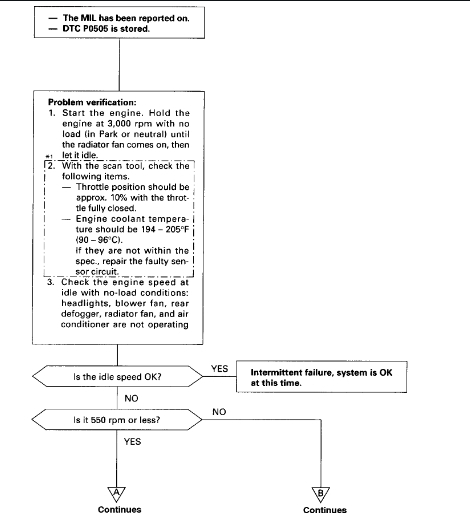

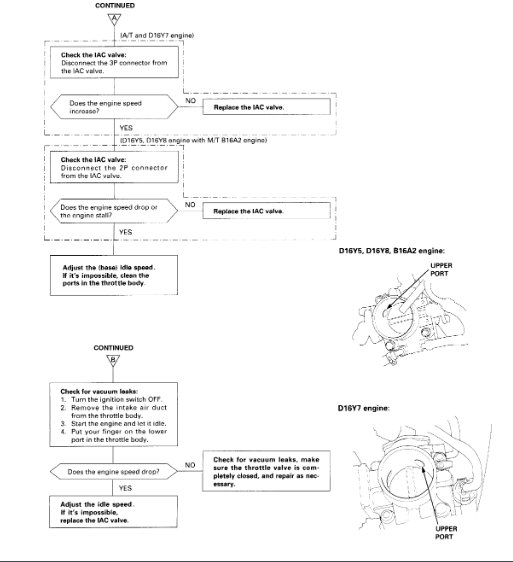

Is the idle speed consistent, and correct? Also, are you getting any other codes?
This could be a few things. I attached the diagnostics below for P0505. It will require a scan tool. Take a look through them and let me know if you feel comfortable doing it.
