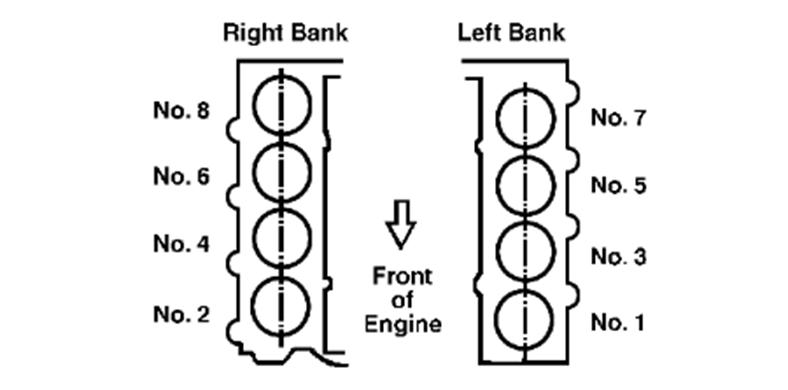

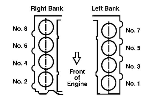

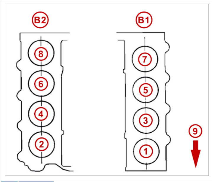

Where is cylinder number 2 located on the 4.7 l V8 engine? That will allow me to follow the exhaust to locate the oxygen bank 2 sensor 1 that I need to replace. Thank you!
Wednesday, January 13th, 2021 AT 5:20 PM (Merged)
KHLOW2008
  • 41,814 POSTS
Here is the engine spark plug firing order. Check out the diagrams (Below). Please let us know if you need anything else to get the problem fixed. Cheers
+19

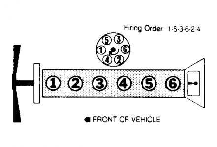

HAPAINBAJA
  • 10 POSTS
  • 1991 TOYOTA LANDCRUISER
Engine Mechanical problem
1991 Toyota Landcruiser 6 cyl All Wheel Drive Automatic
firing order, on the engine from front to back os the plugs wires are in order

  • 75,992 POSTS
Here you go and good luck
https://www.2carpros.com/forum/automotive_pictures/12900_fo_116.jpg
+1
HAPAINBAJA
  • 10 POSTS
Thank you so much, it`s now running good, thanks, and God Bless

BIGERN78
  • 1987 TOYOTA LANDCRUISER
  • 4.2L
  • 6 CYL
  • 4WD
  • MANUAL
  • 197,000 MILES
Makes explosions, pulls.
MHPAUTOS
  • 31,937 POSTS
The firing order is 1, 5, 3, 6, 2, 4. To make suer you have the correct order pull #1 spark plug and pull off the coil lead from the distributor and earth, have an assistant crank the engine in short turns, just a flick on and off and place a finger over the plug hole, when you feel compression building up, turn engine until crank shaft pulley timing marks align. Remove distributor cap and check which segment the rotor is touching, this will ne #1 cyl. Crank engine again to ensure you know the direction of rotation of the rotor.
