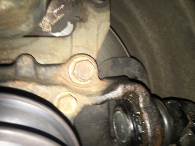

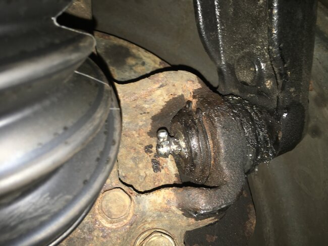

Hey, is this normal? I got both lower ball joints replaced, my driver's side is the one without the ball and the passenger is the one with the silver ball. The passenger has this black thick grease on it and the driver's side doesn’t.

JAYJOHNSON0318
  • 40 POSTS
This is the passenger side with the thick black grease.

KEN L
  • MASTER CERTIFIED MECHANIC
  • 55,297 POSTS
Yep, that is normal.

Okay. Why does one side have the thick black goo but the other one doesn’t?

KEN L
  • 55,297 POSTS
It looks like the ball joint boot is leaking on the old ball joint.
