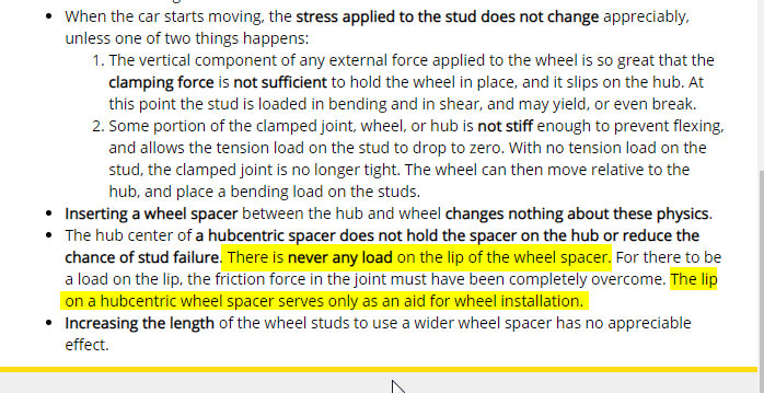

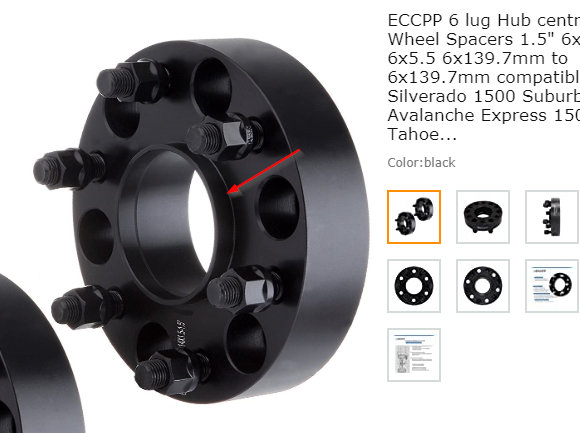

I got a set of 1.5 wheel spacers and they’re hub-centric but they don’t have a lip where the wheel mounts to them. Am I at risk of the wheel coming off of them with them not having the lip or am I okay?

Can you get a picture of your spacers? I assume you are talking about the lip in the center around the hub?
Do you have the part number and manufacturer that these are made by? I will double check but as long as they are made for your vehicle then you are fine.
This lip is a centering lip and is not required. The lug and nut are what hold the wheel on.
Let me know if this is what you are talking about and we can go from there. Thanks

I don’t have them with me at the moment but yes that’s exactly what I’m talking about.

You'll see they came with a set of instructions that includes the liability disclaimer, "For off-road use only". That is how they avoid lawsuits. Here's a lot of related information from a couple of days ago:
https://www.2carpros.com/questions/wheel-studs-keep-breaking
The first problem is the studs are not designed to hold up the weight of the vehicle. That is the job of the wheel, and to do that, it has to sit snugly on the center hub. If I understand correctly, the lip you're referring to is that hub that fits the center hole of the wheel. Without that hub to hold the wheel in place, the wheel will have repeated up and down forces acting on it with each revolution. The nuts don't actually have to work loose. The wheel will be sliding up and down under the nuts, and that will wear away the mating friction surfaces. That is what usually leads to the loose wheel.
I've used these spacers in the past, and I was constantly having to retighten the lug nuts. What I wasn't aware of at that time was once the nuts worked loose, they chewed up the matching friction surfaces on the wheel that hold the nuts tight. At that point the wheel and nuts must be replaced.

Just to clarify. That lip is for nothing more then centering the wheel and helping you install the wheel. As long as these spacers are installed properly they will not loosen or cause any issues. When they are installed properly they change nothing as to the physics of the wheel to hub.
Here is a website that gives some good info. It is all in how they are installed. If the lug nuts are constantly loosening then it is because there is flexing or movement between the hub, spacer, and/or wheel.
If you get a spacer that is made for your vehicle and it is installed and everything is torqued properly you should not have any issues. I have had these on trucks before and never had issues.
https://www.maximummotorsports.com/tech_wheels_spacers.aspx
Let me know if there are questions.

So I would be fine running these on a set of 20 inch rims with 35” tires?
Sunday, April 5th, 2020 AT 6:25 AM
Clearly I don't know the specific product so you would need to verify compatibility, which you can do by simply calling the manufacturer, but speaking in general terms, yes. The size of the wheels and tires don't effect the spacer as long as they are installed correctly. When they are installed correctly there is no difference between these and the stock hubs. Again, I would suggest calling and speaking with the people that made them and verifying that they will work with your exact set up but I don't hear anything alarming.
