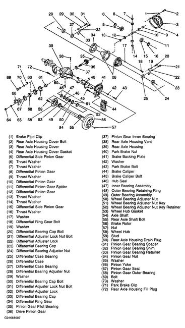

Without all info had to guess so here is 10.5 Suspect installation may have damaged bearing also 115 ft. Lbs. Torque on hub.
-1
Sunday, February 7th, 2021 AT 9:44 AM (Merged)
DOCFIXIT
  • 18,828 POSTS

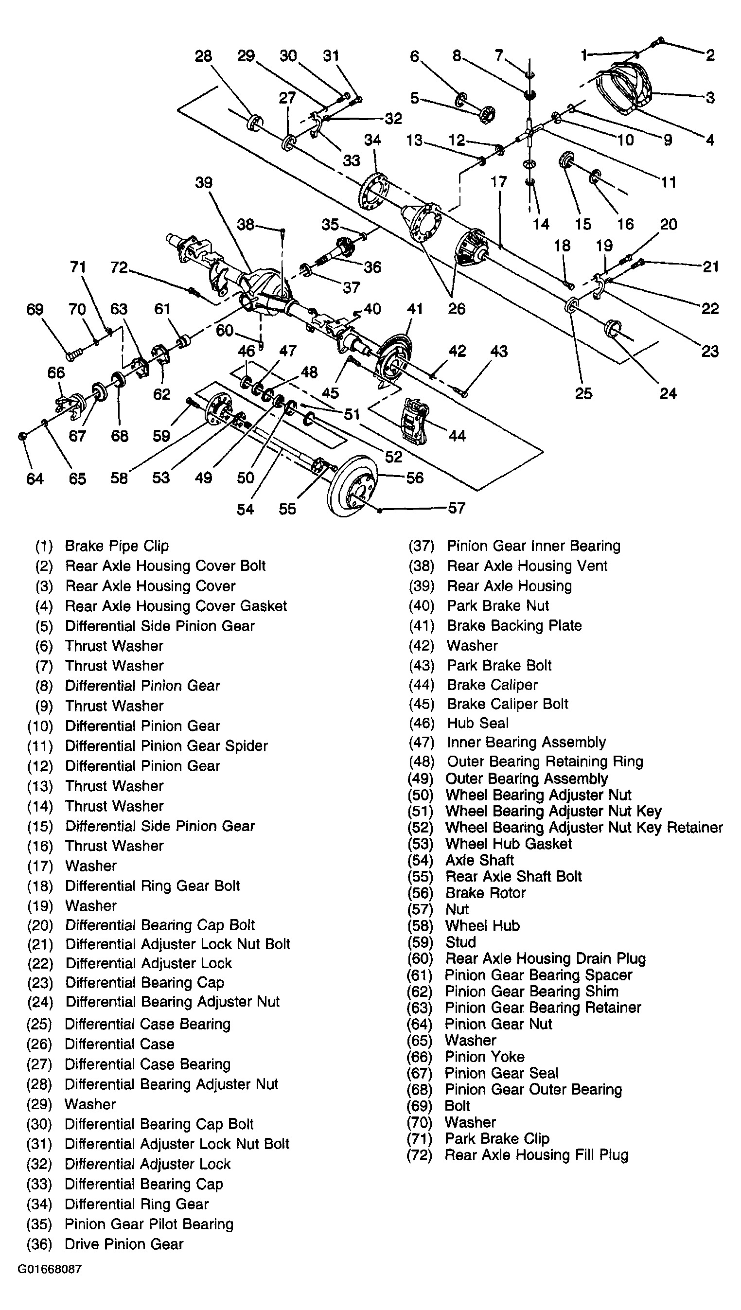

Oops forgot diagram
BCOHOE
When the bearing were installed into the wheel hub the outer bearing cone the taper end was pointing into the inner retaining ring, also the adjuster nut was not torqued just hand tighten until wheel started dragging than was back off and pinned. My next question is this adjustment nut should be torque to 115 pds for preload than back off?
DOCFIXIT
  • 18,828 POSTS
115 for bolts to hub the adjuster finger tighten to zero lash then with socket and torque wrench tighten to 52 lb. Ft. You can back off one slot counterclockwise to insert keeper key

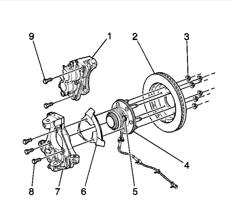

What is the procedure step by step for wheel bearing hub replacement on my 2001 chevy p/u 4wd. Front driver side. Its 4wd and its a sealed hub type?
HMAC300
  • 48,601 POSTS
Remove brake caliper, rotor, bracket, dust shield. Remove brake hose and wheel speed sensor from steering knuckle. Remove dust cover and then nut an dwasher for axle. Remove bolts that hold hub in knuckle. Reverse for reassy. Picture is of 1500 series 2500 series is a little different Retorque axle nut to 177 ftlbs for assembly and hub bolts to 133 ft lbs.
