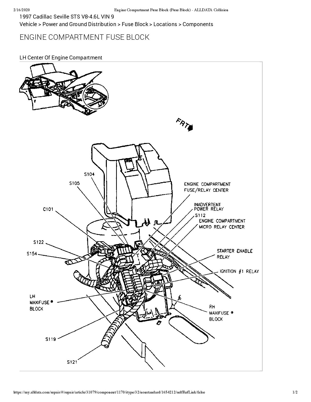

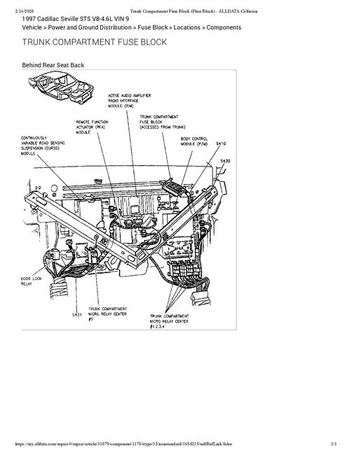

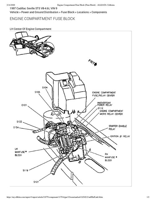

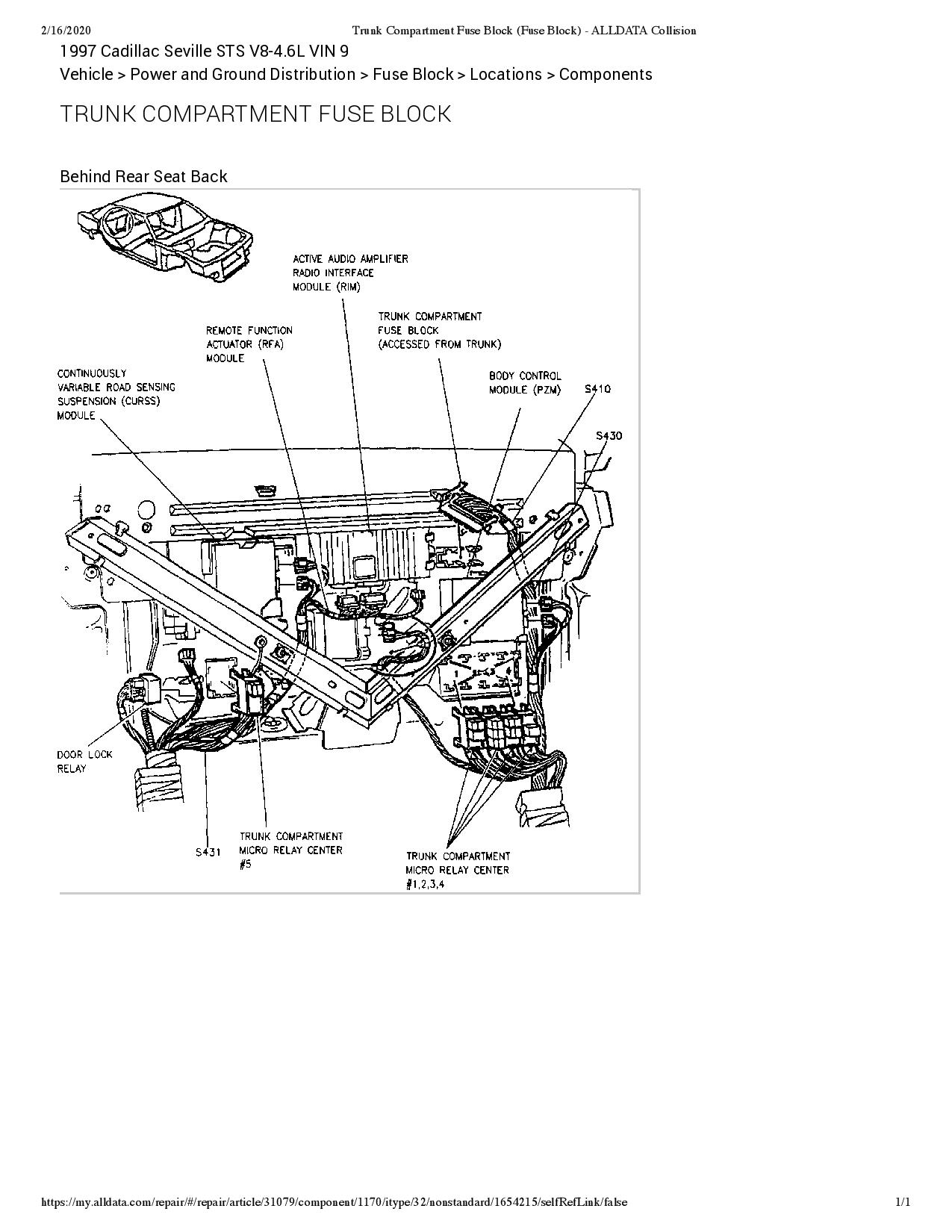

Can you please check all fuses in the engine compartment and truck fuse boxes?
I have attached diagrams to show the location of these fuse boxes.
This is always the first step in electrical diagnosis.
There is a guide on how to check fuses below.
A 12V test light makes the process much quicker.
Let us know what you find here.
Regards, Joe

Okay, checked trunk fuse block continuity; first all were good then key on power to all 12 v. Then engine compartment fuse block same all good all 12 v, but one DRL fuse only 11 v. Now that I have done all of these things I turn on key and chime goes off five times and headlights come, on the check engine light comes on, clock comes on, trunk light comes on. Lid open I turn off'the key and head lights tail lights go off and then the interior lights come on when I shut! The door. When
the headlights are on I cannot seem to turn them off no matter what switch for the lights I turn or pull. And still not even a click out of the starter or dash lights or any relays. What I was getting a noise out of starter relay when I would pull out and in a couple times on the PCM fuse. Oh, and when the headlamps are on there are no high beams. I just went back out and turned on key and the chime went off 7 times with a few seconds between the headlamps coming on. Turned off key everything goes off; radio, clock, check engine light, headlamps and then shut the door and interior lights come on.

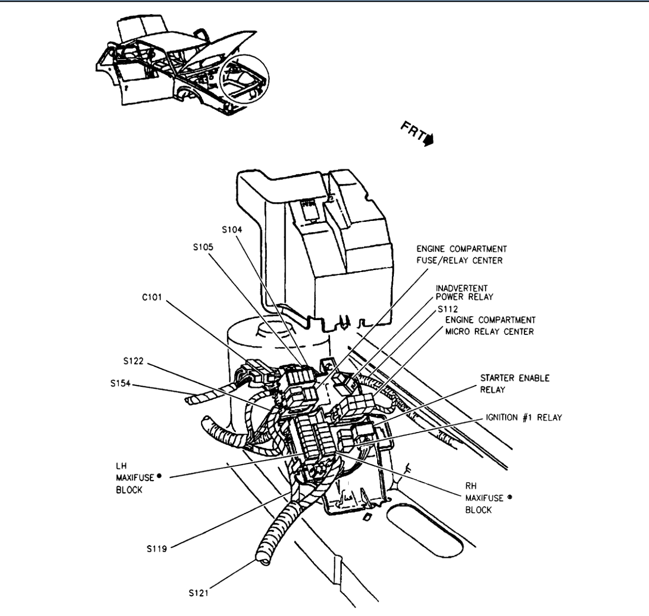

Hey ROBERTEUGENEALBERIGI,

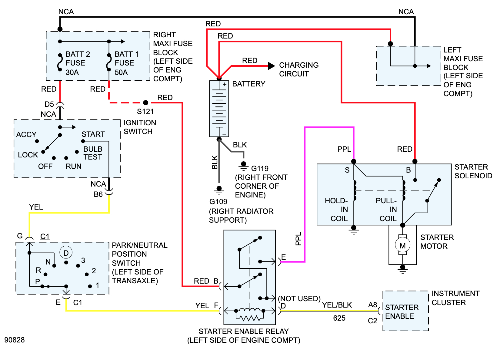

Can you please clear down the fault codes, attempt to start and then recheck the fault codes?
I think the next step will be to check the operation of the ignition and power/ground to the PCM and instrument cluster.
The P1604 code is for communication between PCM and instrument cluster.

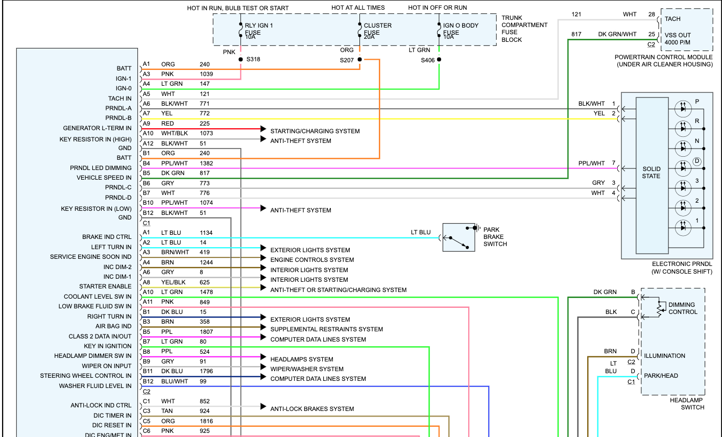

The starter enable relay is grounded by the instrument cluster. If you check for voltage between the yellow and the yellow/black wire while attempting to start you should get 12 volts.
If not then check between the yellow wire and battery negative to see if the positive side is switching correctly. You should see 12 volts.
If it is then the instrument cluster is not grounding the relay control circuit.
I have attached the wiring diagram for the starting system.
Let us know what you have with the fault codes and we can start trouble shooting the starting/communication issue.
Regards, Joe

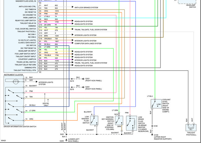

Okay Joe, I unplugged the starter relay and did as you said yellow to yellow black and turn key as I would trying to start it, no 12 volts. Then I took and left test meter probe in the yellow socket of the harness of the starter and the other probe on negative side of battery and turned key and voila 12 volts. So does this mean I don't have a good ground going to the instrument cluster to send signal to the relay? I would like to know what is a inadvert power relay and what does it do? Its located in the same ares as the starter relay and the ignition 1 relay. Okay thanks, for all the help we appreciate whole heartily. So what to do next?

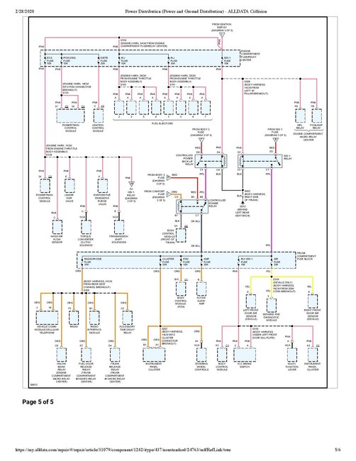

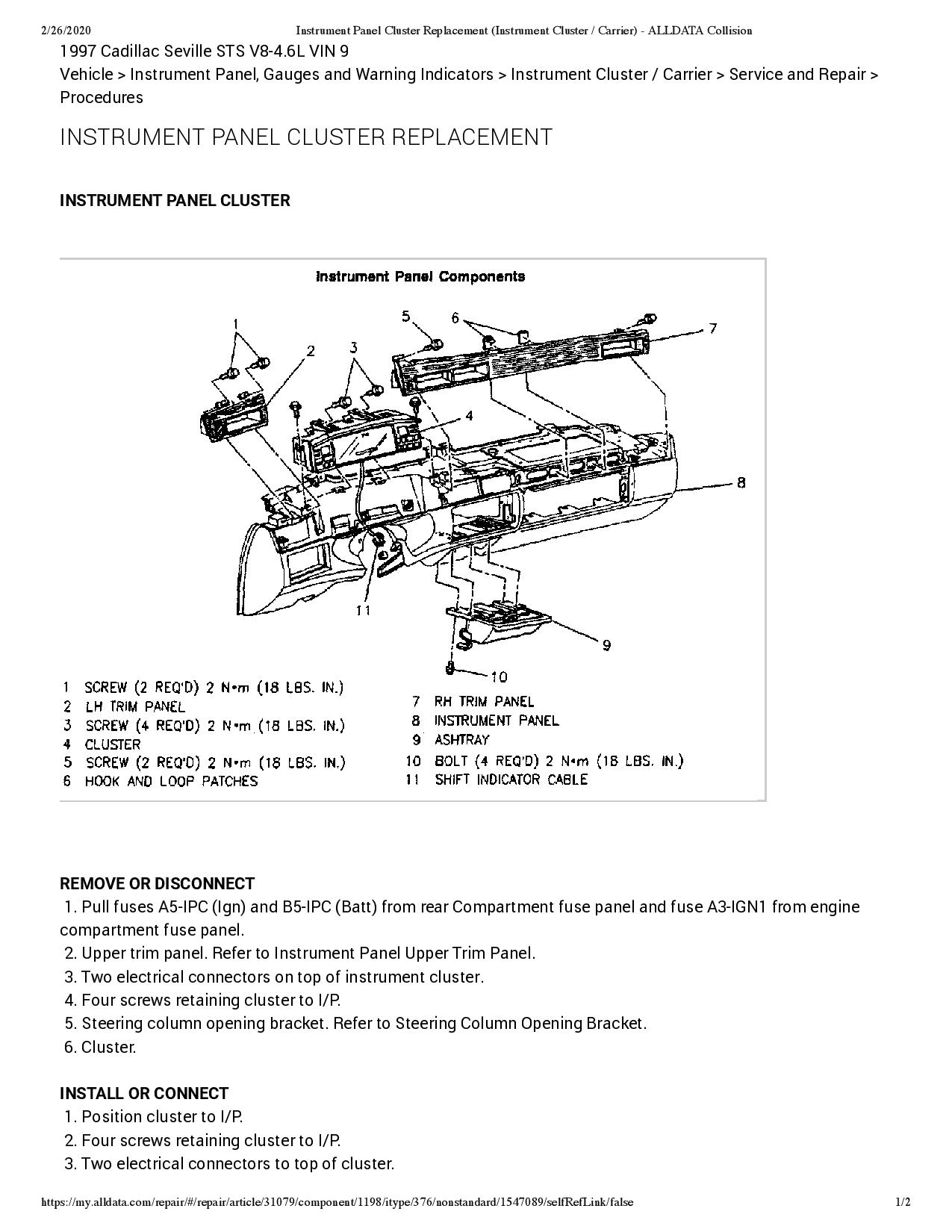

It's okay, I just copy and paste your name in there. Keeps it consistent across the posts.
It is pointing to you having an issue with the instrument cluster or the ignition.

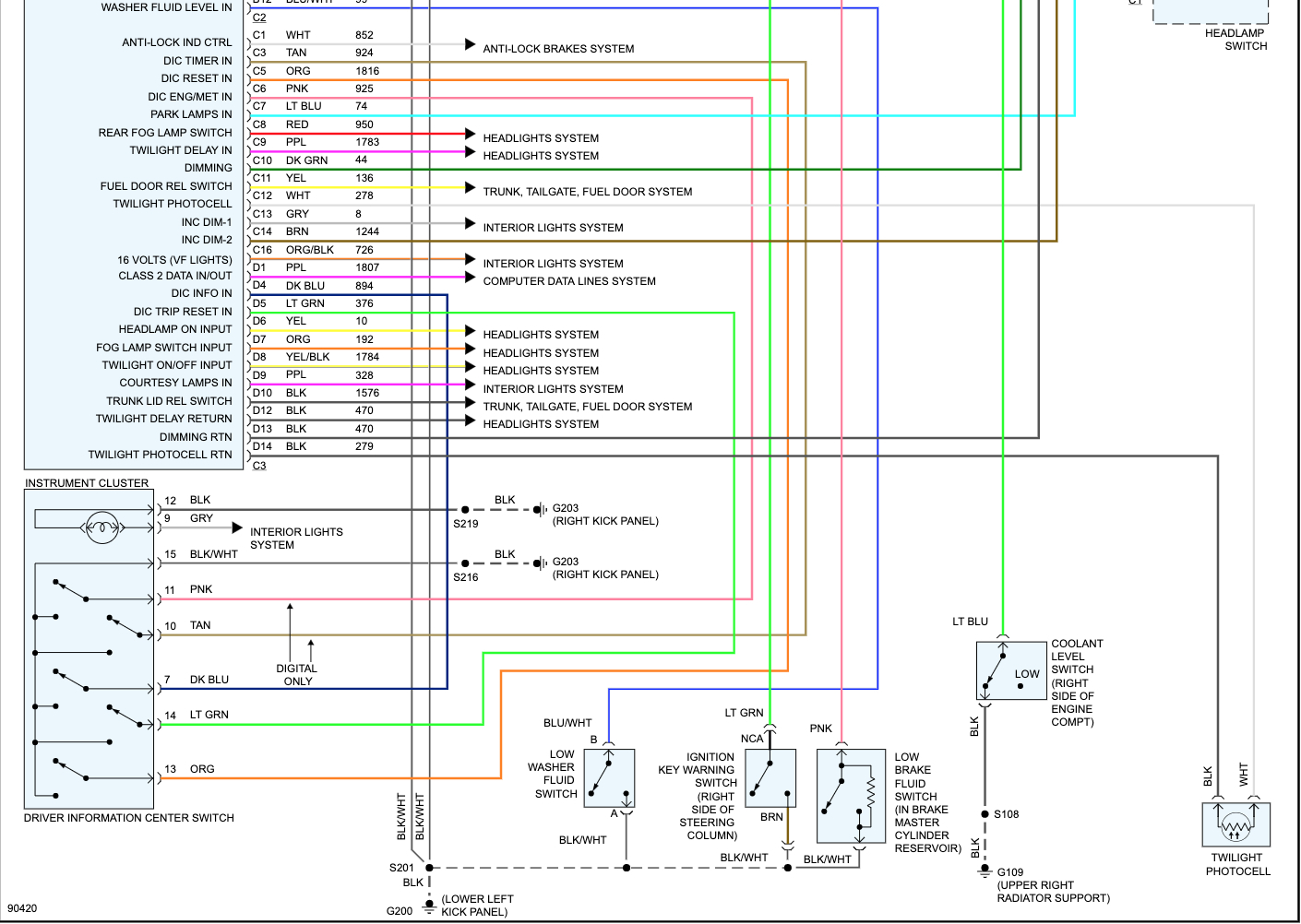

I would say the next step would be to confirm that you have power and ground at the back of the instrument cluster.
Also checking power/ground to the PCM would be good to confirm you have this present.
Was there any work carried out before this fault occurred?
How did the vehicle fail originally?
Did you have a flat battery and then it wouldn't start?
I just need to build up a full picture of what has happened and the order of events so we can choose the best testing route.
Do you have the digital or analogue instrument cluster?

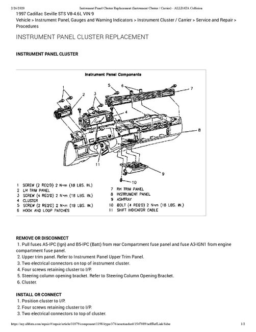

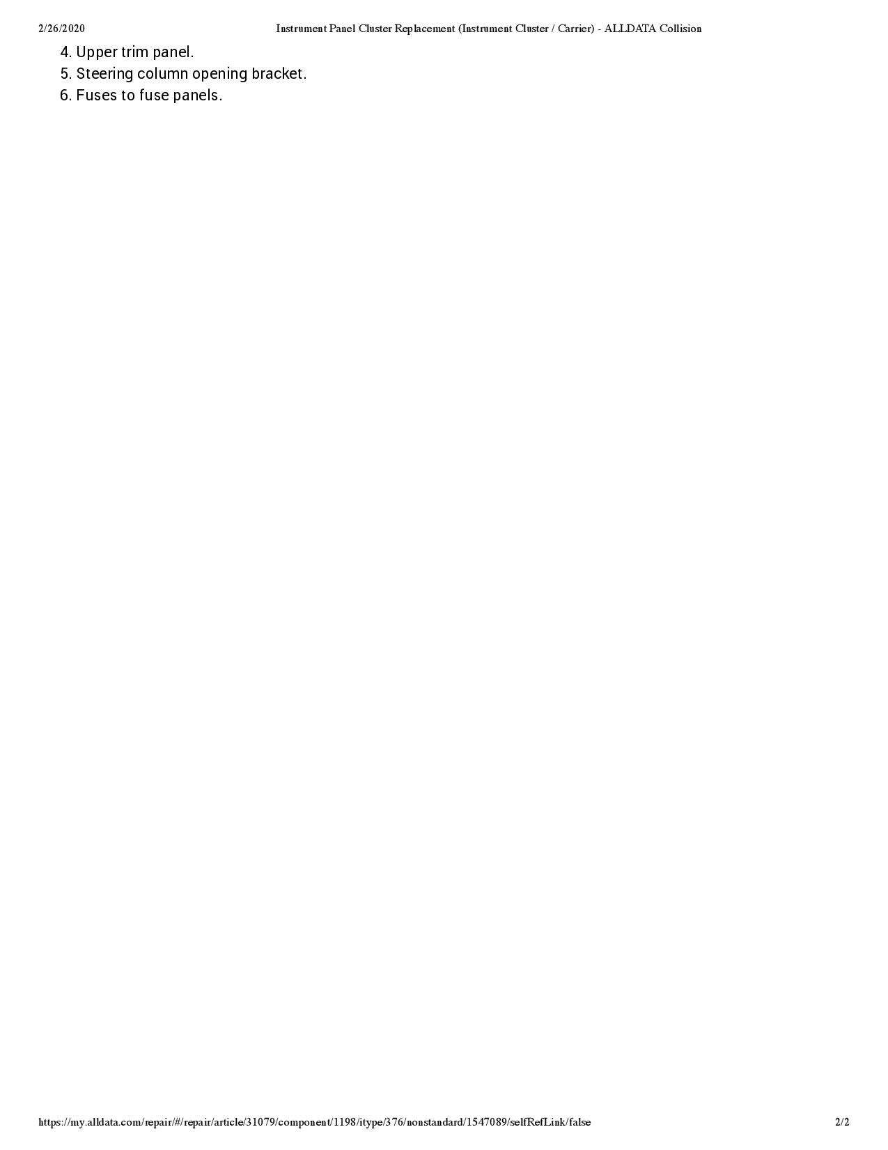

If you can source a replacement cluster replacement will be a quick way to rule out an instrument cluster problem before performing further wiring checks.
I have attached the replacement instructions for the cluster, you will see you have to remove 3 fuses before disconnecting and replacing the cluster.
Please ensure these fuses are good and have power to them with the ignition on.
You will see from the diagram that you should have power on pins A1, A3, A4 and B1
You should have 12V between any of these and pins A12 and B12 which are grounds.
With the cluster plugged in if possible check between the power and grounds with the ignition on. You should have battery voltage.

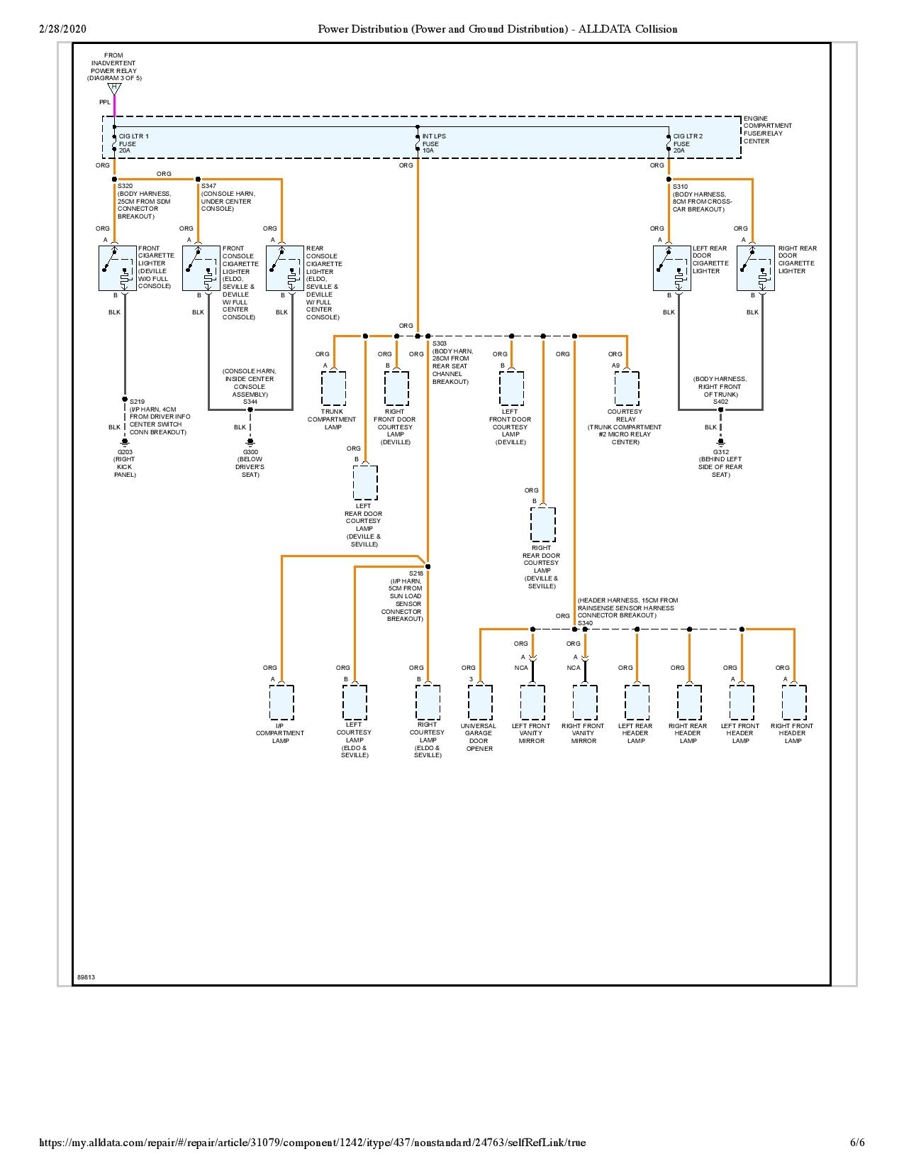

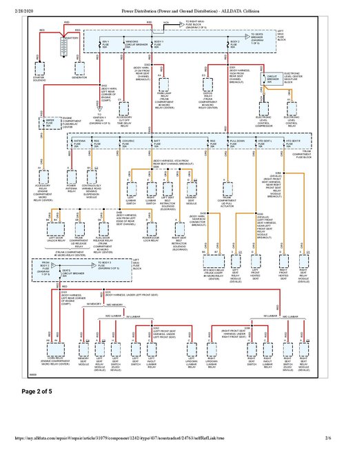

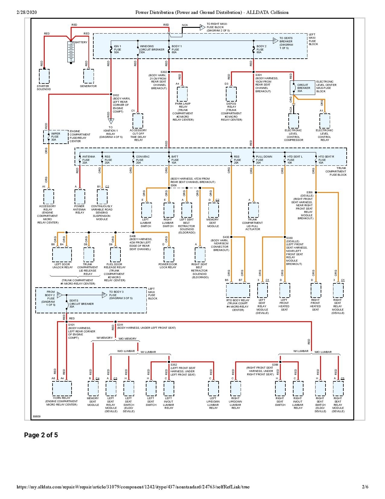

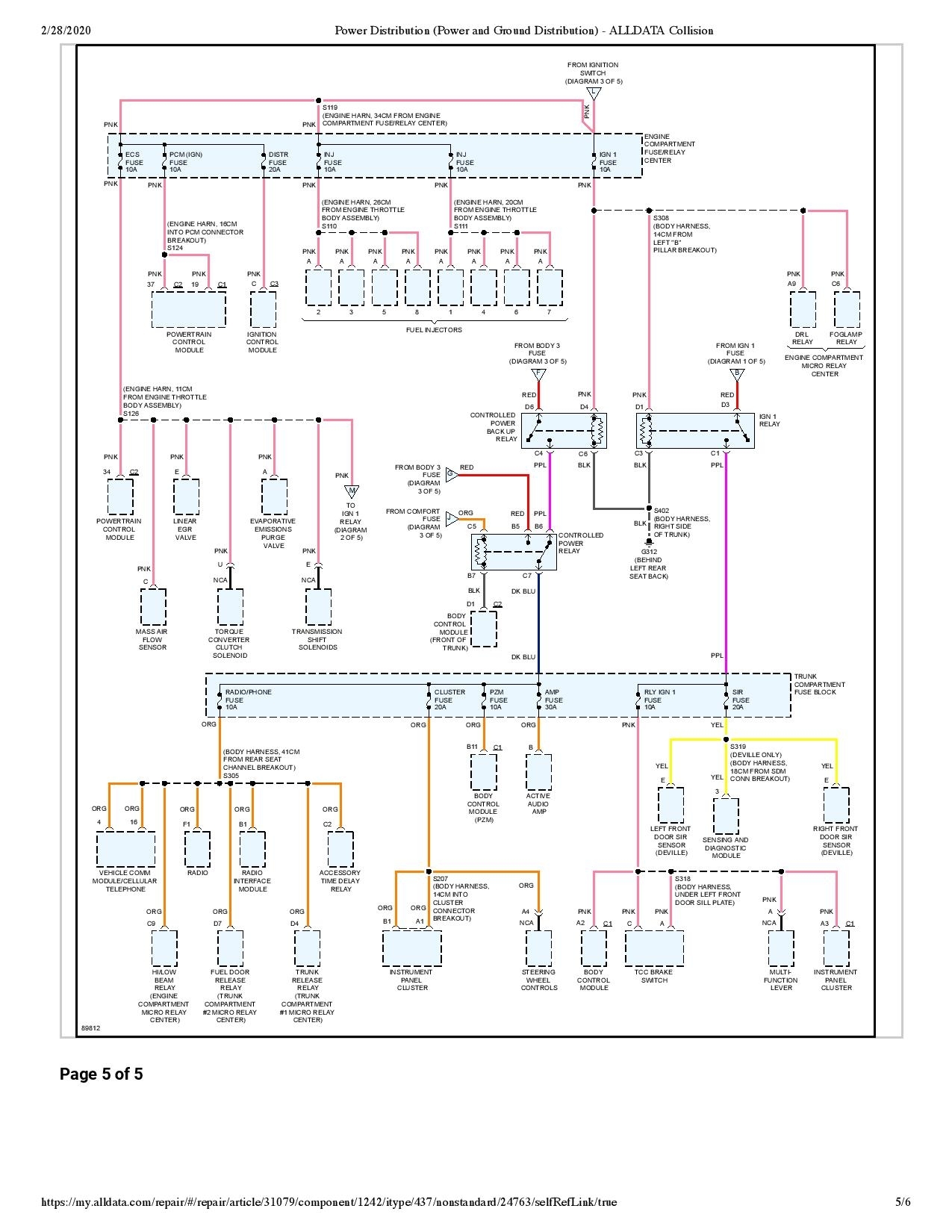

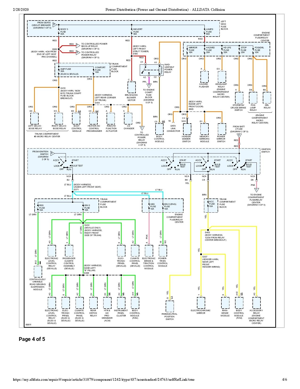

I would still like to see what you have for power and ground at the instrument cluster.
One of the feeds comes from the ignition 1 relay so if you can test at the cluster you will be able to tell if that circuit is working correctly.
You will also be able to tell if you have a ground issue.

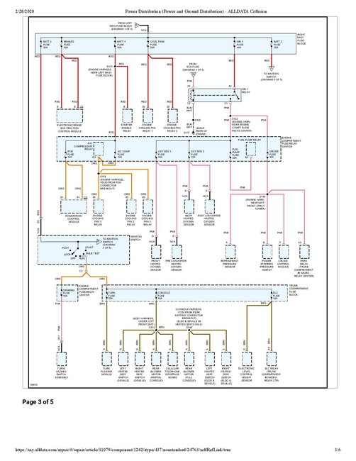

I have attached the diagrams for power distribution so you can get a better idea of what is getting supplied from each fuse/relay.
You may want to print the diagrams to get them to be a better size or if you open the pictures in a new tab they will be readable.
Regards, Joe
