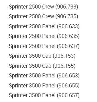

Have the vehicle listed above 3500 RV. I need a low cost scanner which will absolutely troubleshoot this vehicle to diagnose faulty rear wheel speed sensors. No one in the country seems to be able to answer this question absolutely with confidence. Answering this question may very well mean you are the only genius in this country to be able to answer it. I need to know which sensor is bad and how to reset the three accompanying lights on the dash which are on because of the wheel speed sensor. I will give you an honorary genius certificate if you can tell me what low priced scanner will do what I am requesting. Thanks

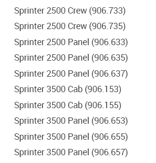

If you look at the attached picture, it indicates the models of Sprinters that were available in 2013. If you indicate which one you have, I can get you sensor information, wiring, procedures and so on. Another thing that you may find beneficial are Bluetooth set ups for OBD2 systems. Basically, a small device is plugged into the OBD port which connects with your phone. I was given one and it works great. It doesn't take the place of my scan tool, but I take it with me and it reads everything. The brand is Blue Driver.
