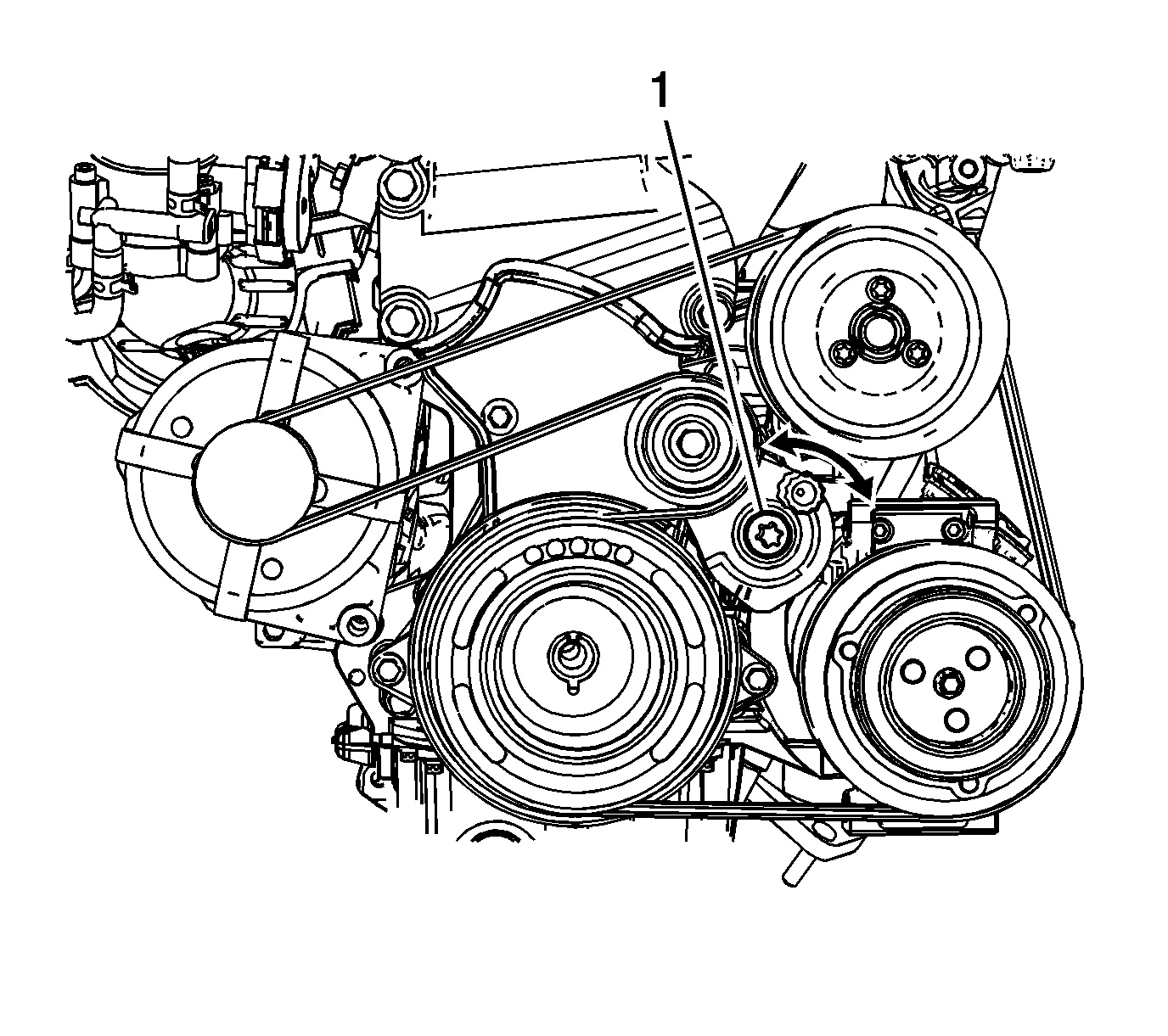

It’s driving me crazy. What is the easiest way to remove a drive belt and power steering belt on this vehicle? I cannot seem to get to the tensioner under the hood. I cannot reach the tensioner to loosen belt. Also does the power steering belt have a tensioner? What’s the easiest technique if you don’t have a lift?

You have to remove the front wheel and inner fender to access it. Here are the directions. The attached pics correlate with the directions. The second set of directions are for the PS pump. You are going to either laugh when you see them or be really frustrated. You have to remove the headlamp assembly and the air box assembly. There is no tensioner. Take a look at the directions and let me know if you have questions.

DRIVE BELT REPLACEMENT
Drive Belt Replacement
Removal Procedure
pic 1
Note: To remove the power steering pump belt, do remove the accessory belt in advance.
1. Rotate the tensioner star-nut (1) and remove the accessory belt.
2. Remove the power steering belt. Refer to Refer to Power Steering Pump Belt Replacement (See: Drive Belt > Removal and Replacement > Power Steering Pump Belt Replacement).

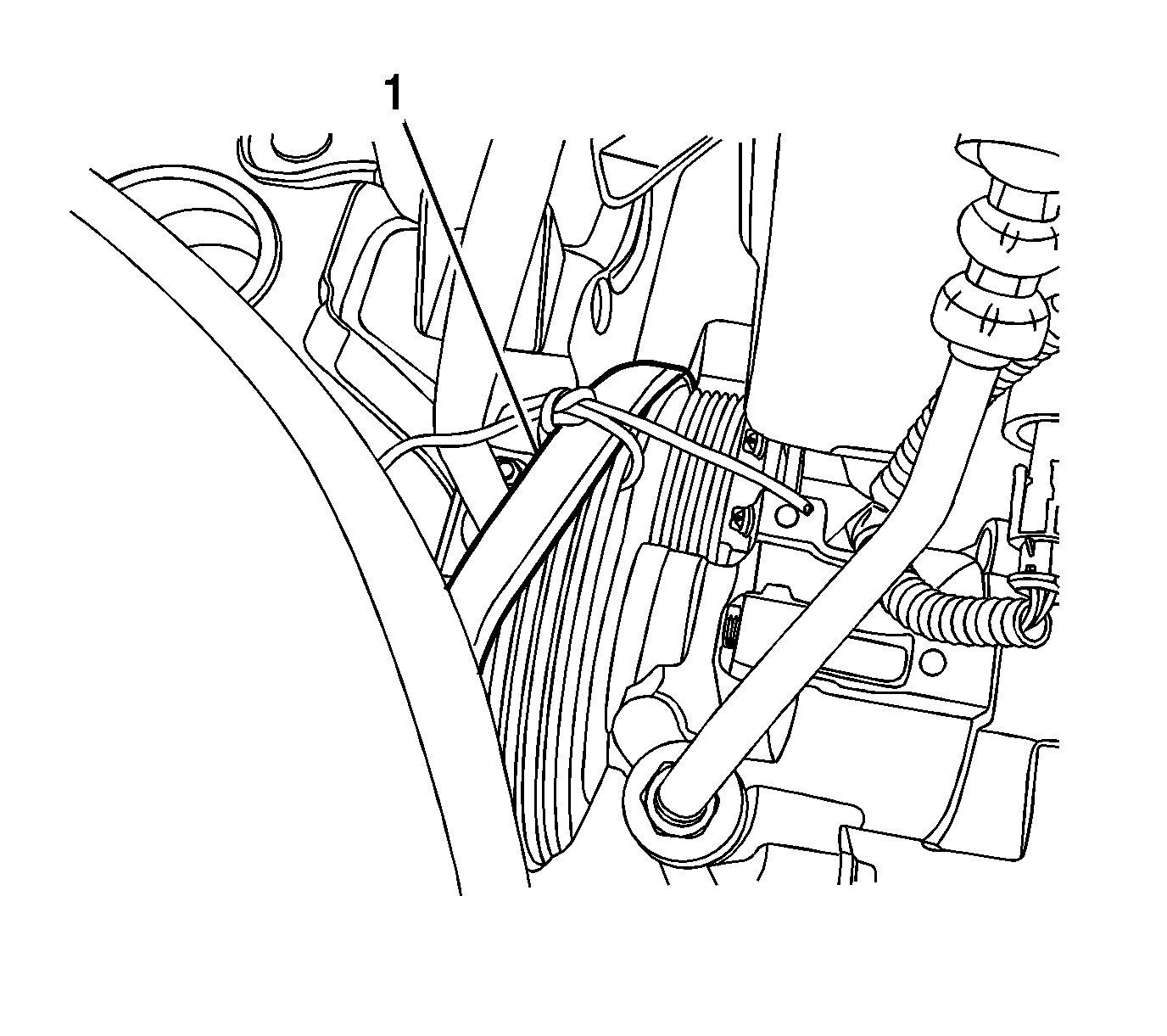

Removal Procedure
1. Remove the engine accessory drive belt. Refer to Drive Belt Replacement (See: Drive Belt > Removal and Replacement > Drive Belt Replacement).
Pic 3
2. Remove the RH headlamp assembly. Refer to Headlamp Replacement (Notchback) (See: Headlamp > Removal and Replacement > Headlamp Replacement (Notchback))Headlamp Replacement (Hatchback) (See: Headlamp > Removal and Replacement > Headlamp Replacement (Hatchback)).
3. Remove the air cleaner assembly. Refer to Air Cleaner Assembly Replacement (See: Air Cleaner Housing > Removal and Replacement).

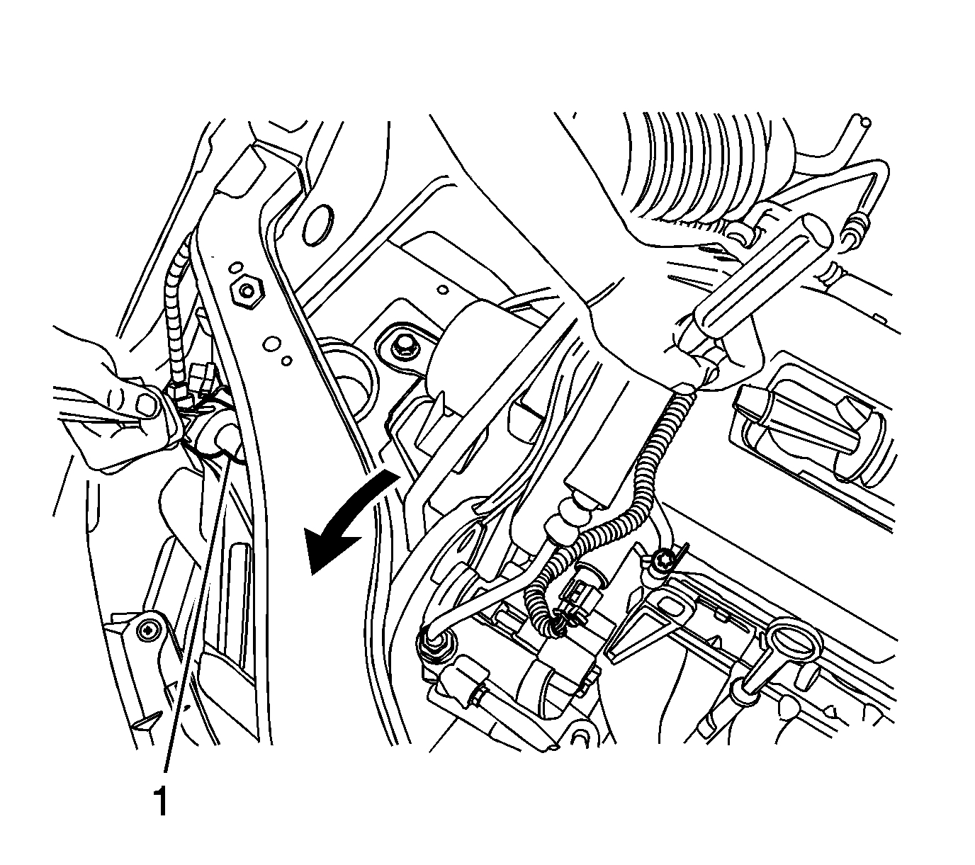

4. Place a long bar (1) in the opening between engine and pump drive belt.
Note: This will provide a guide function for the drive belt removal.
5. Using the bar (1) push the drive belt (2) into the opposite side of engine.

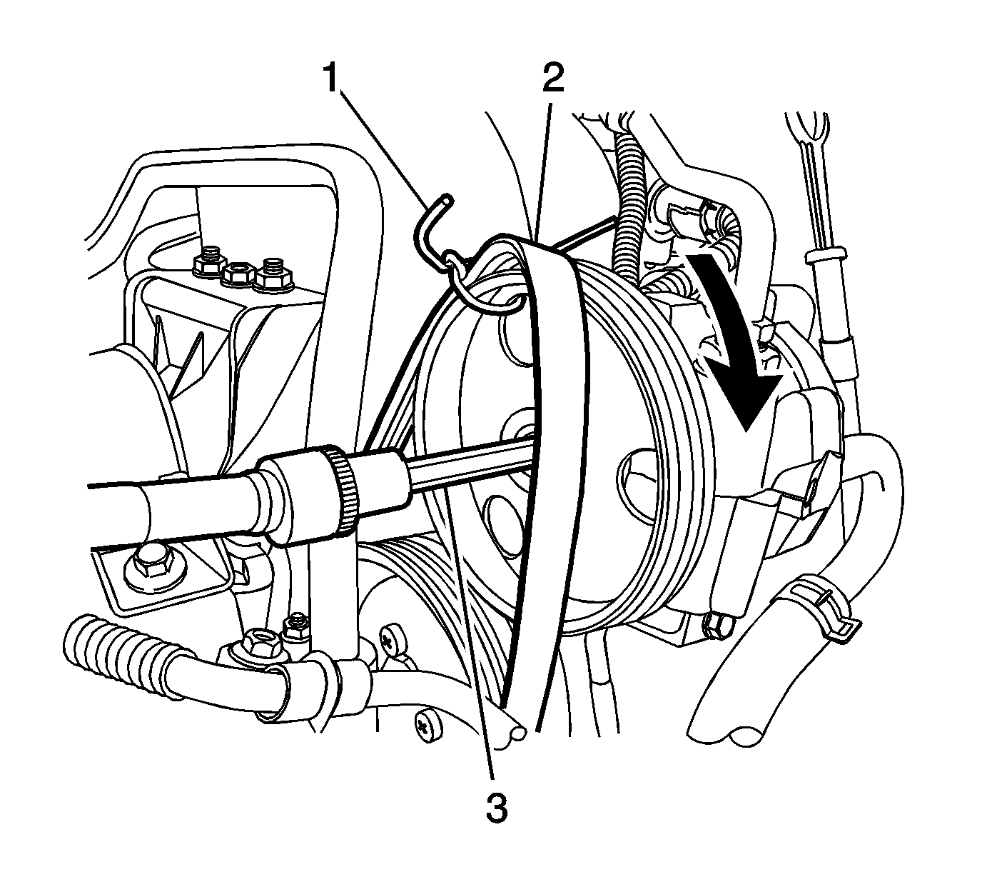

Pic 4
Note: Outside surface of the belt should face toward the engine.
6. Rotate the pulley using 3/8 inch hex bit socket (1) in the power steering pump pulley shaft hole.
7. Rotate the power steering pump pulley clockwise while pushing the drive belt until the belt is fully removed from the pulley.

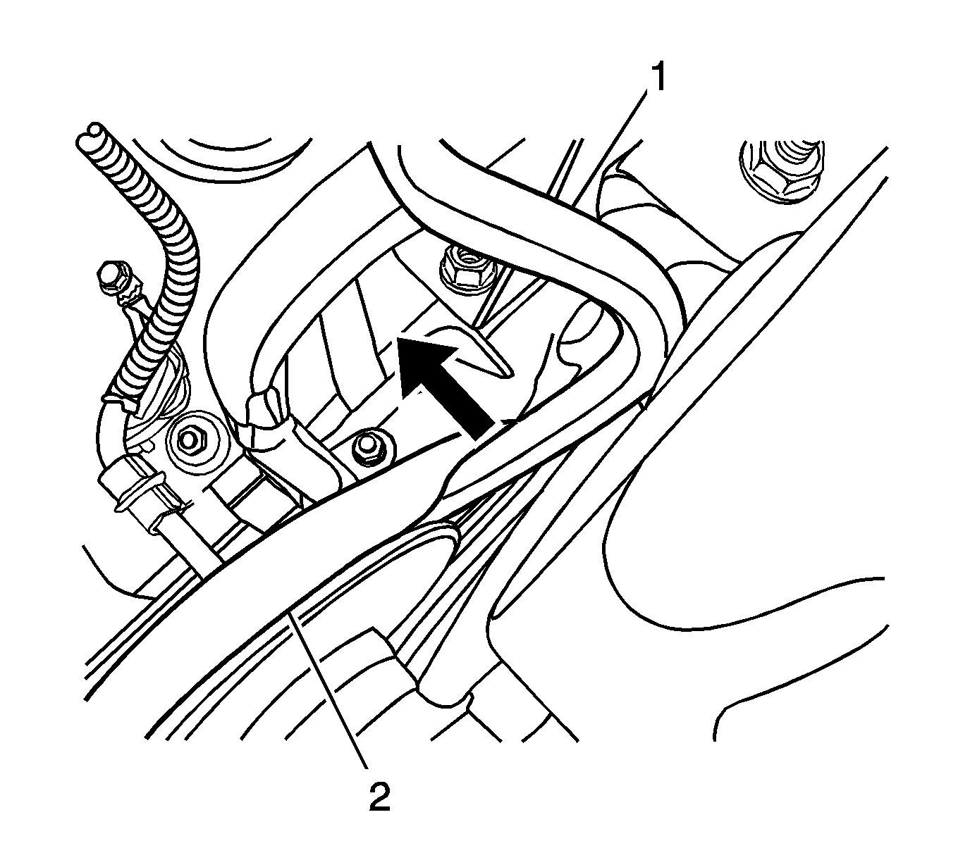

Installation Procedure
pic 5
1. Route the power steering pump drive belt (1).
2. Align the drive belt on the water pump pulley first.
3. Position one of the three pulley holes on top point.

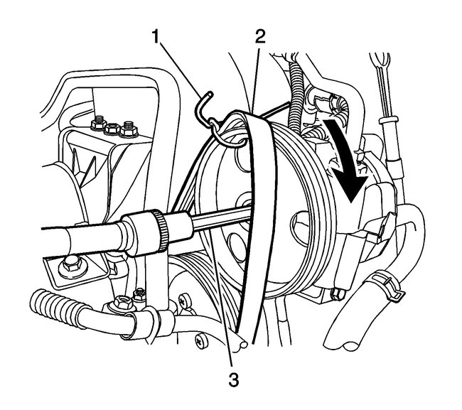

Pic 6
4. Through the pulley hole tie the driver belt to the pump pulley using a cable tie (1).
Note: This will provide a guide function for the drive belt (2) installation.
5. Rotate the pulley using 3/8 inch hex bit socket (3) in the power steering pump pulley shaft hole.
6. Rotate the power steering pump pulley clockwise until the belt is fully installed on the pulley.
7. Remove the rope or cable tie.
8. Inspect for correct belt installation.

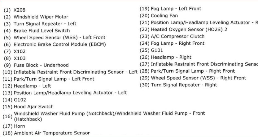

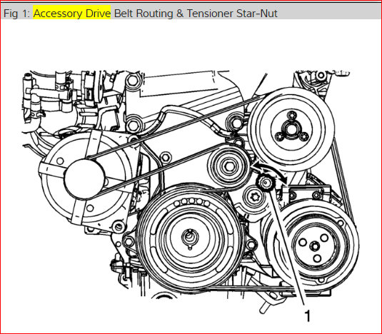

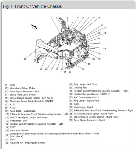

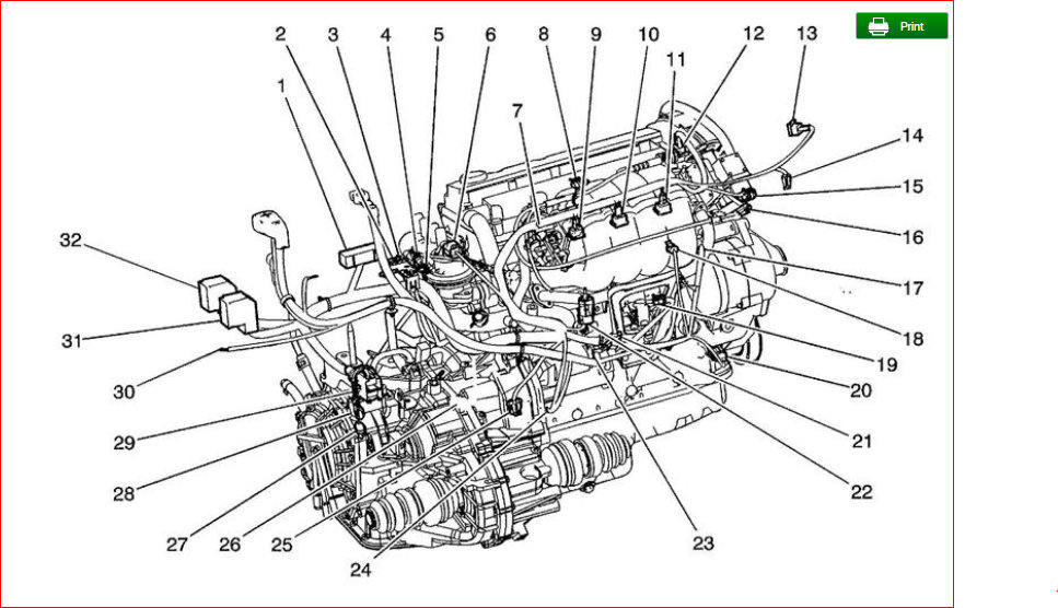

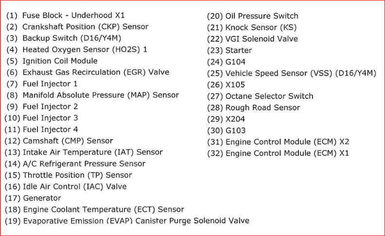

Engine compartment components diagram of all where all the components are located at in the engine compartment and drive belt routing diagram with all accessories driven by the belt.
Saturday, March 13th, 2021 AT 12:22 PM (Merged)
DANNY L
  • 5,648 POSTS
Hello, I am Danny.
Just a quick question. What components are you looking for to be located in the engine compartment? I have attached a picture of the serpentine belt diagram and a tutorial showing how to replace it. Hope this helps and feel free to ask any questions if needed. Thanks for using 2CarPros.
Danny-

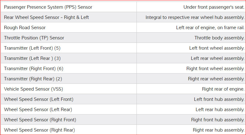

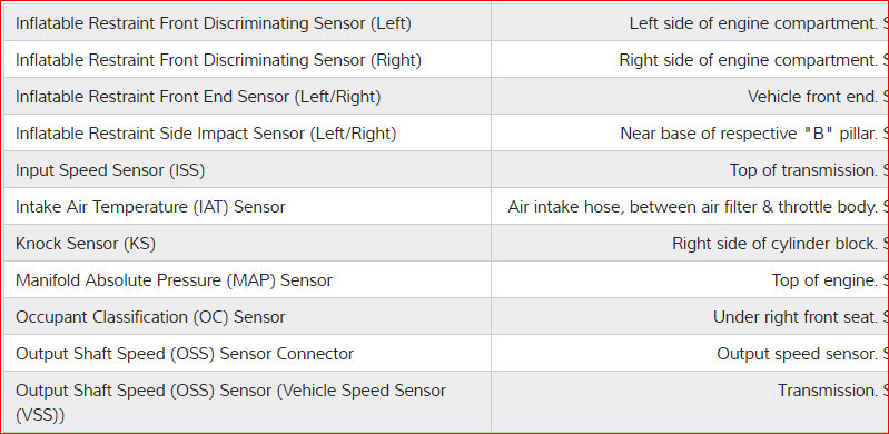

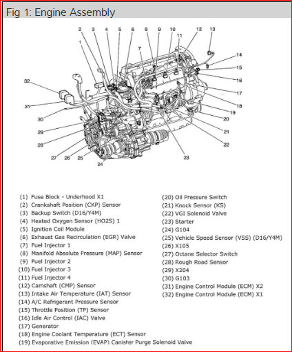

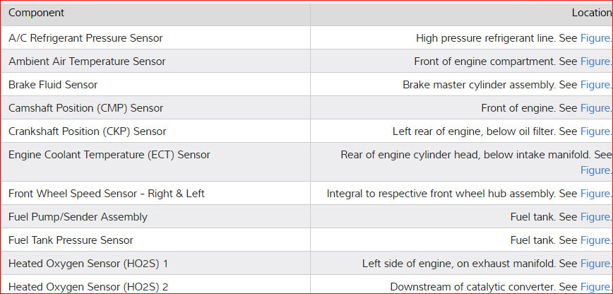

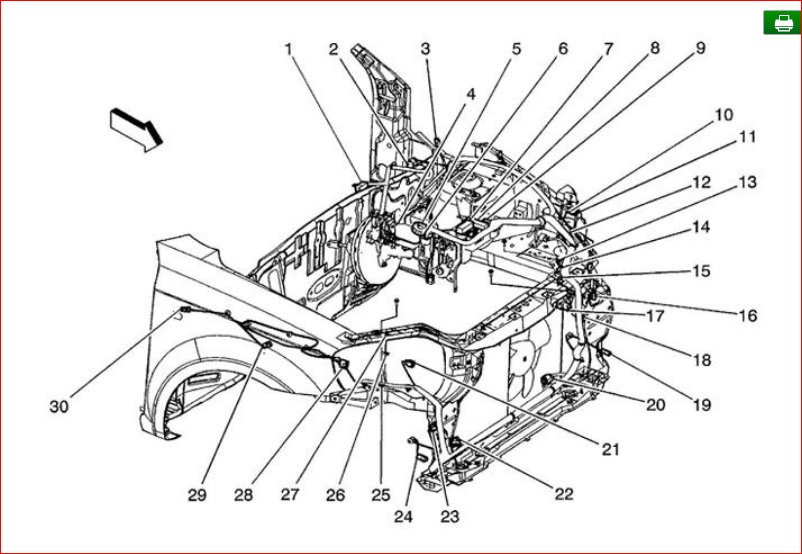

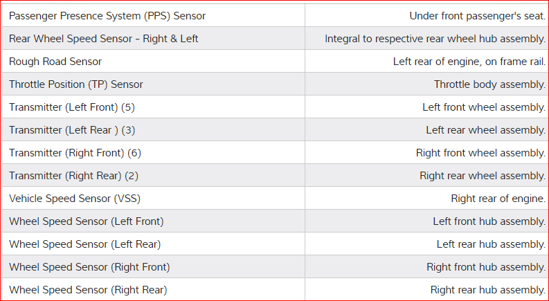

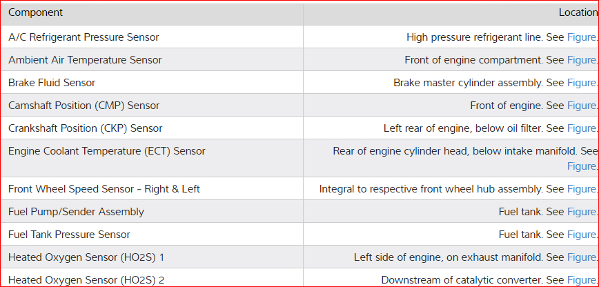

I want to know where all of the sensors are located at.
+1
DANNY L
  • 5,648 POSTS
Hello again.
Okay, I have attached pictures of the sensors and their location. Hope this helps. Feel free to ask questions if needed.
Danny-
COOLOLDS85
  • 173 POSTS
Do you think you can post a larger photo of the last two so I can see it more closely? If that is okay?
DANNY L
  • 5,648 POSTS
Hello again.
Okay, here you go. Thanks again for using 2CarPros.
