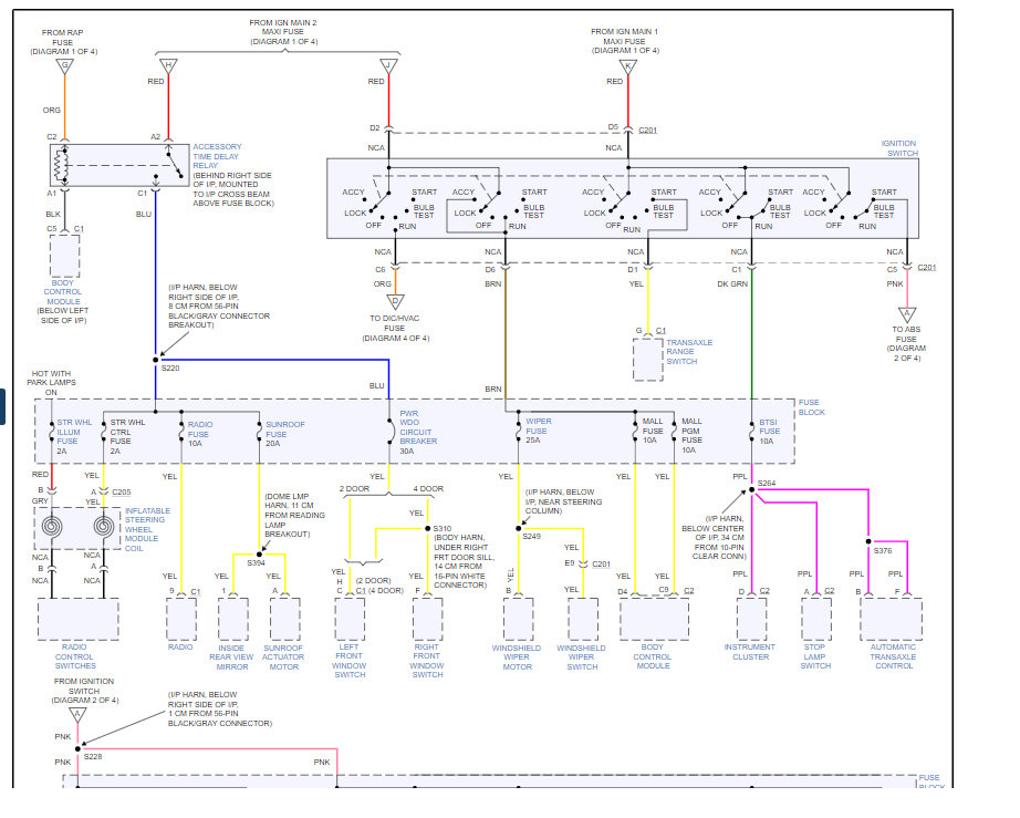

We're re-wiring harness to switch assembly under the dash that goes for the key. Need to know where my wires connect.
Tuesday, January 5th, 2021 AT 11:57 AM
KEN L
MASTER CERTIFIED MECHANIC
55,459 POSTS
Here is a guide to help you check the wiring and the ignitions switch wiring diagrams so you can see how the system works:
