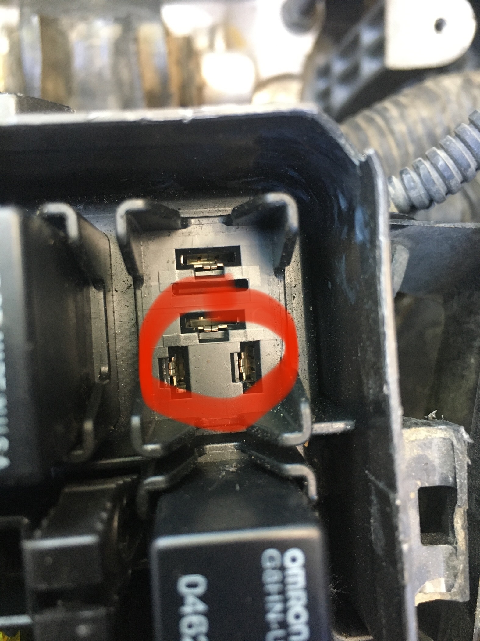

No, I told you on that relay of pic I sent you only 3 have power going through it.
Thursday, July 9th, 2020 AT 11:19 AM
$ANGEL559
  • 33 POSTS
3 little holes.
Thursday, July 9th, 2020 AT 11:20 AM
$ANGEL559
  • 33 POSTS
Which it’s these three.
Thursday, July 9th, 2020 AT 11:22 AM

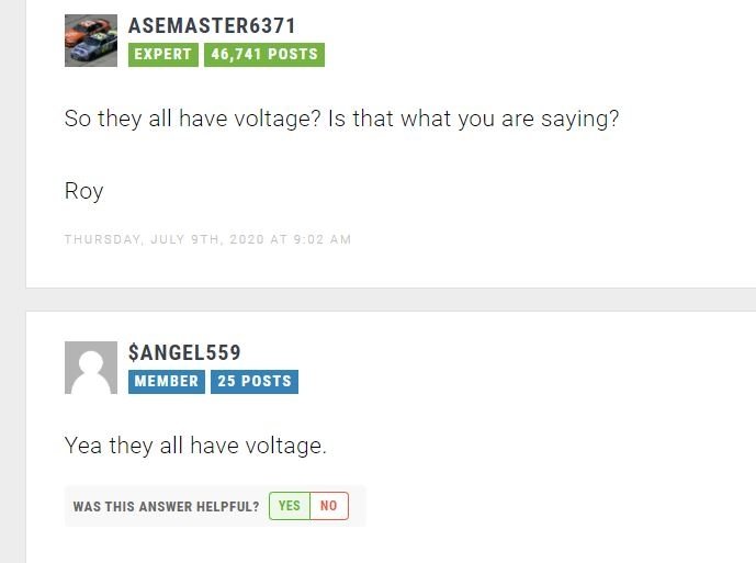

Okay, I attached your answers that told me all the terminals had voltage.
Still, only 2 should have voltage, not 3.
Thursday, July 9th, 2020 AT 12:16 PM
