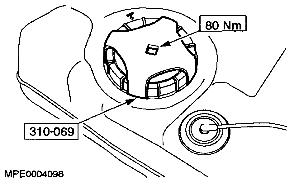

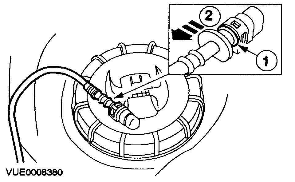

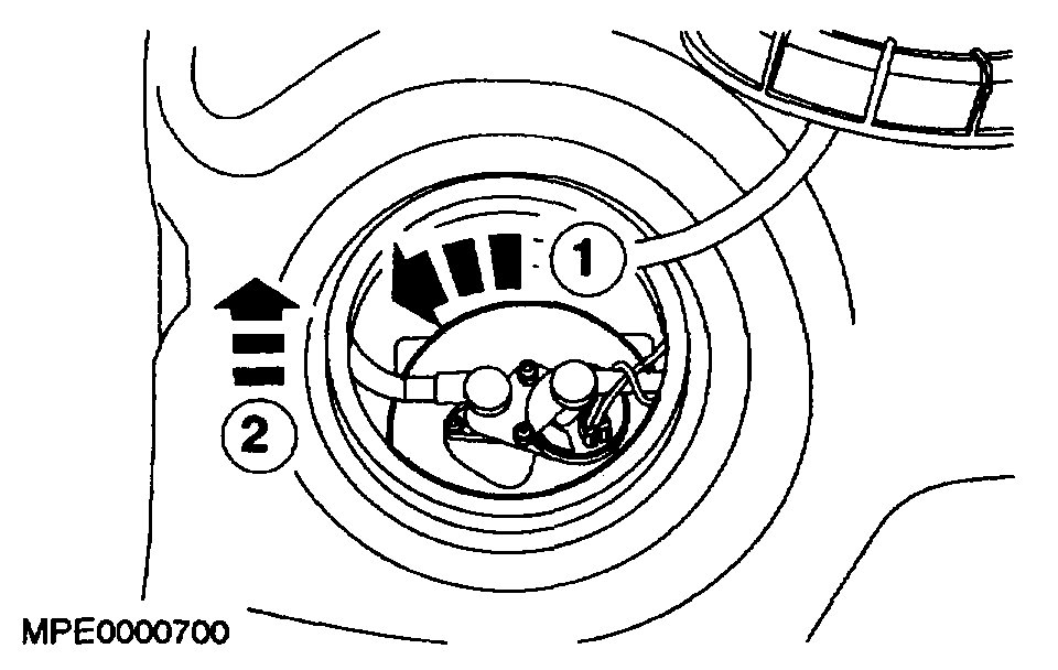

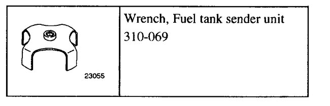

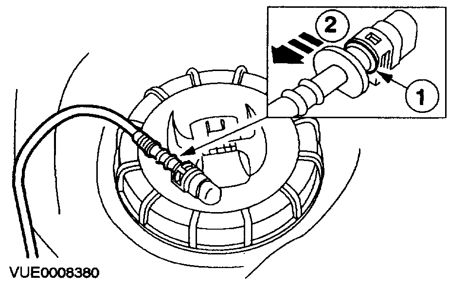

Fuel pumps are extremely common on these vehicles. If your scanner can read the sensor parameters (pids), monitor the frp sensor and while revving the engine, if it goes any less than 30 psi, replace the pump and inspect the tank for contaminants.
