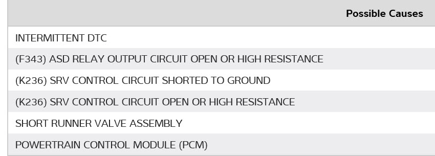

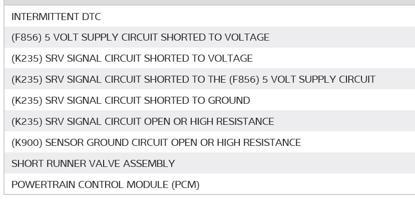

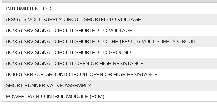

My car started running rough skipping etc, and loss of power. I went to Autozone and came up with three codes. 2 P2017 and 1004 Autozone said the codes showed issue with the fuel system being faulty. Either pump or injectors etc. I know it needs spark plugs and there seems to be an exhaust leak.
Monday, January 6th, 2020 AT 10:16 AM (Merged)
HMAC300
  • 48,601 POSTS
You only listed two codes not three, but the ones you did list are manifold tuning valve and either pump or injectors. See pictures for causes, but really a mechanic should check this out.
