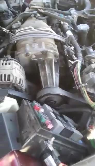

Sorry, it took me so long been really busy. But this is what it does. I replaced the plug and wires yesterday and still nothing.

Thanks for the video. It seems like the battery cables are bad but to be sure let's remove the spark plugs and then crank the engine over to see if it turns over better. Just to be clear the engine cranked like this before the starter replacement, correct? Please send other video once the spark plugs have been removed and check the ground cable and positive battery cable as well.

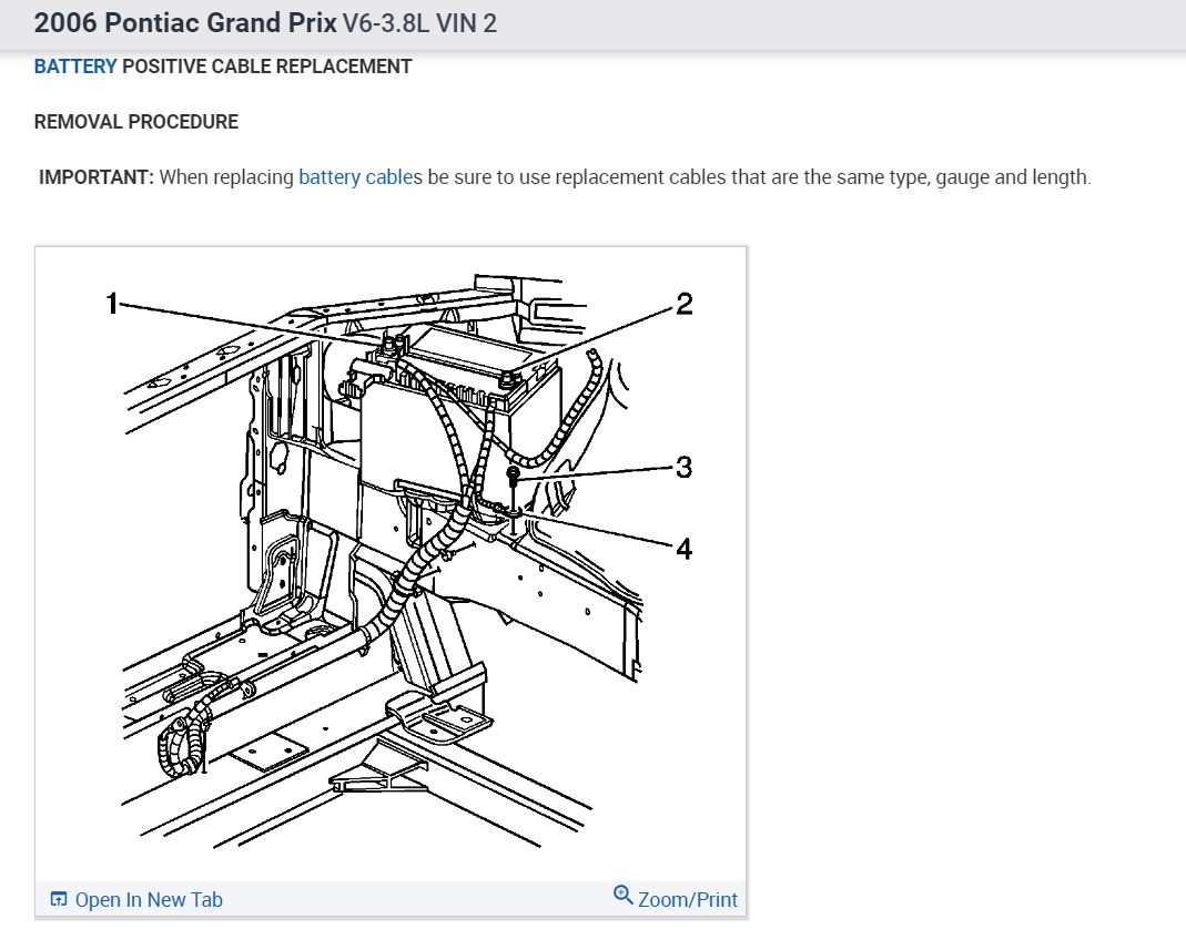

I replaced the negative cable to engine block at the same time I changed battery. I was checking connectivity today and at some spots I touch multimeter to engine block I'm getting a way lower # than what my battery is at. 1 bolt was 5.46v another was 7.22v when battery was at 12.46v. I'm at a loss right now.

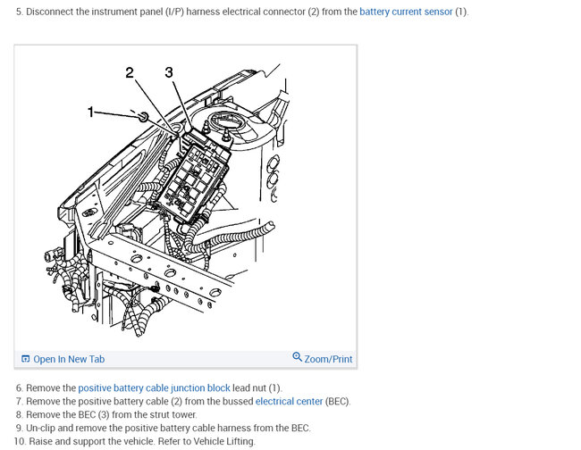

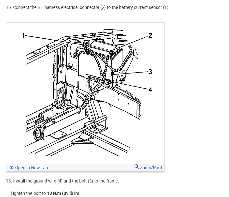

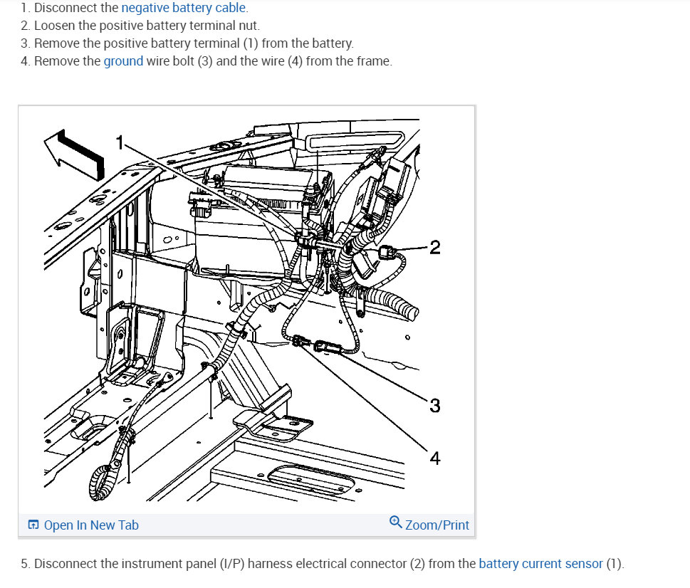

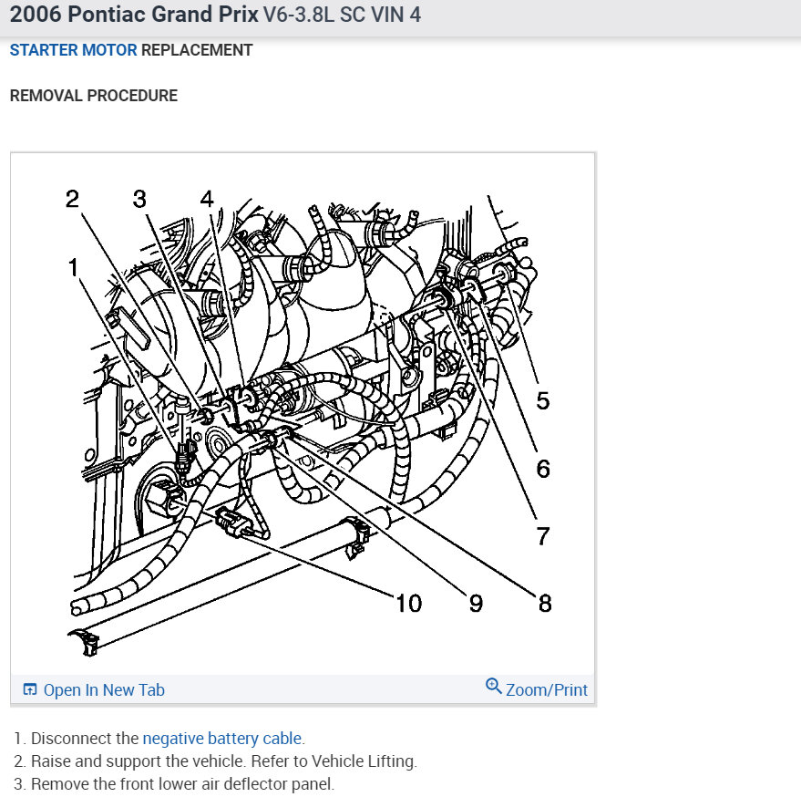

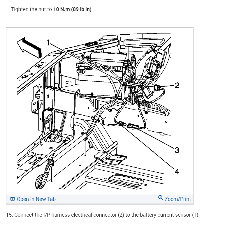

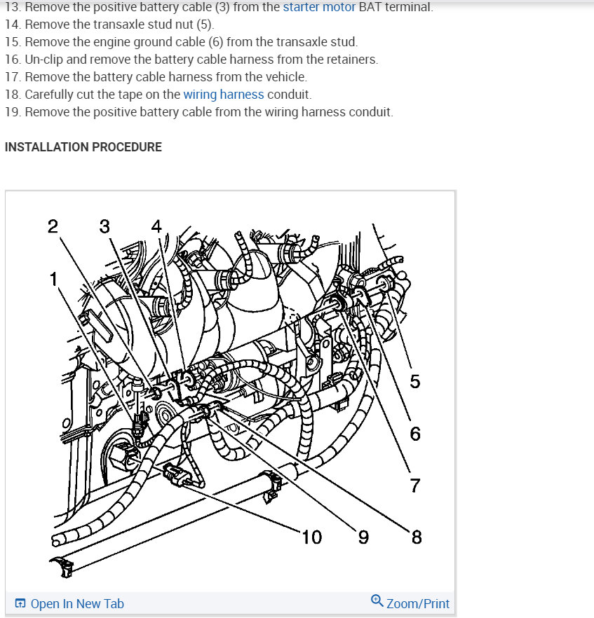

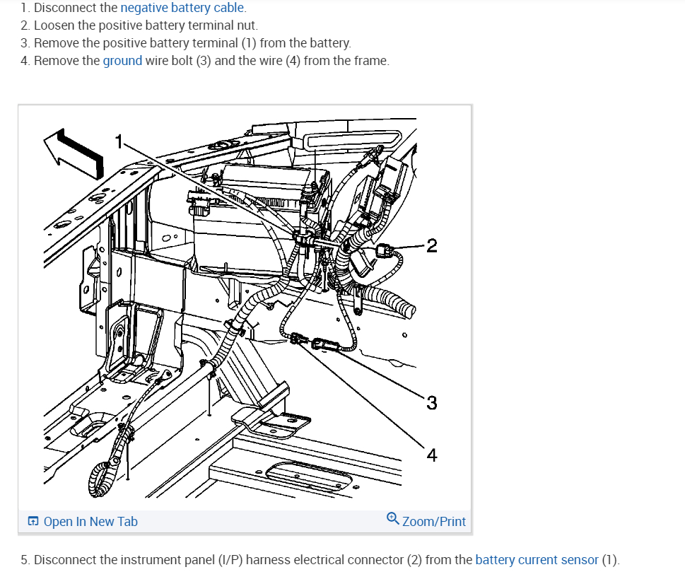

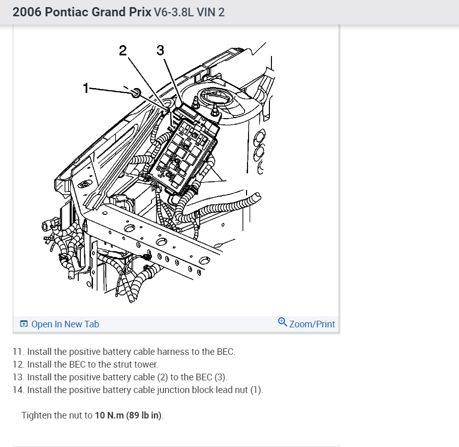

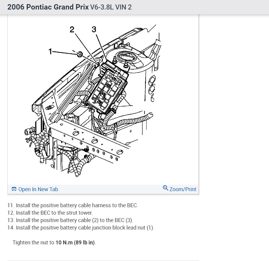

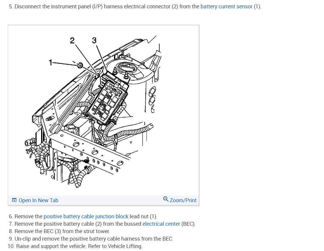

Yep, that is low voltage I would replace the positive battery cable it must be corroded internally. Check out the images (below). Let us know what happens and please upload pictures or videos of the problem so we can see what's going on.

I changed positive battery wire still no change. Pulled all plug wires and tired turning over no difference. Couldn't do video it was really windy 35+ winds and no helper today. Let me go back to when the problem happened. Went to gas station turned car off. Went to restart nothing. Turned key off and tried again started. I went to Walmart turned off came out started first try. I went to dollar tree turned off hasn't started since. I'm at my ropes end.

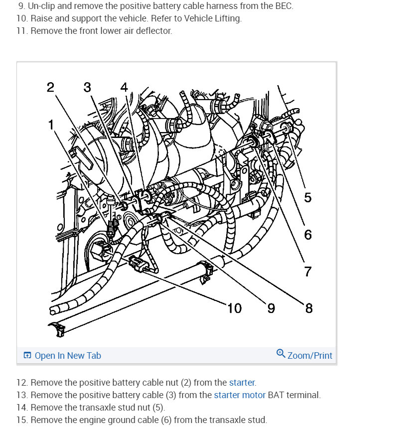

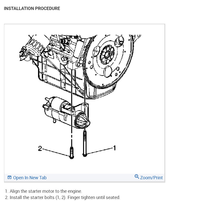

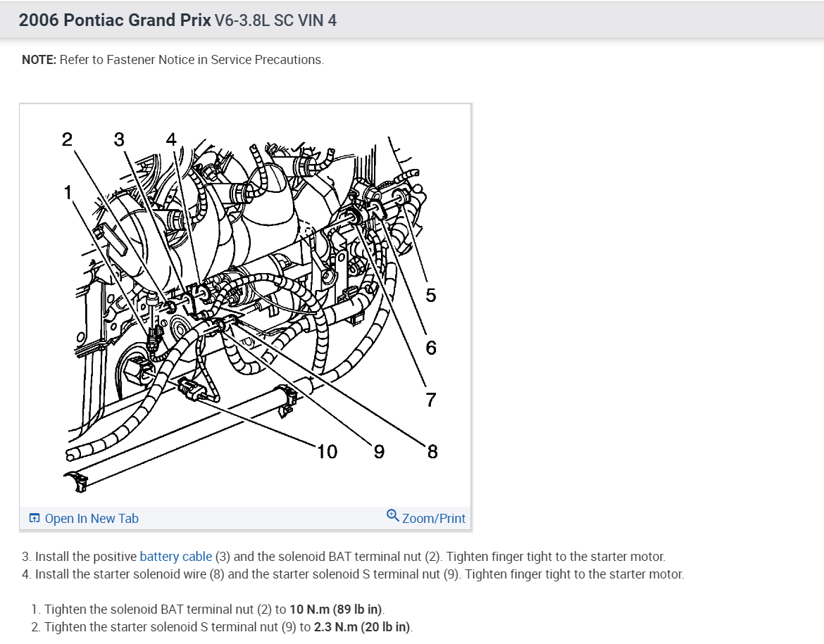

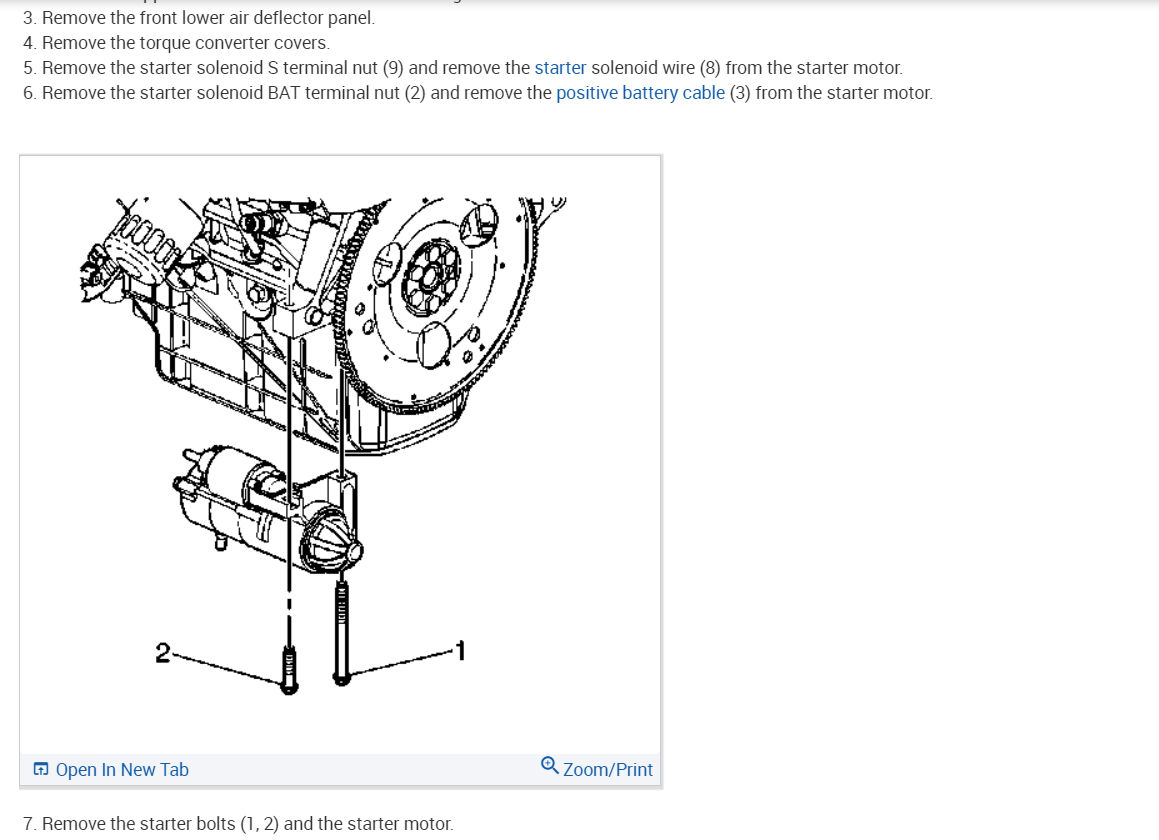

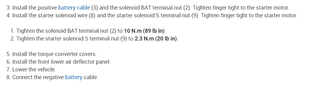

You must have a defective starter motor is the only thing left I can think of. I would check it out for a different one. Here are the instructions to do so. Check out the images (below). Please let us know what happens.
Tuesday, May 2nd, 2023 AT 12:28 PM

Here is a guide to check the connections and the starter wiring diagrams so you can check it out:
Please go over this guide and report back.

It wasn't the starter which I knew it wasn't. Had a buddy come look at it, and it turned out to be a seized power steering pump. Car is running like a dream now.
