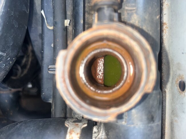

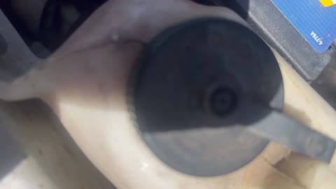

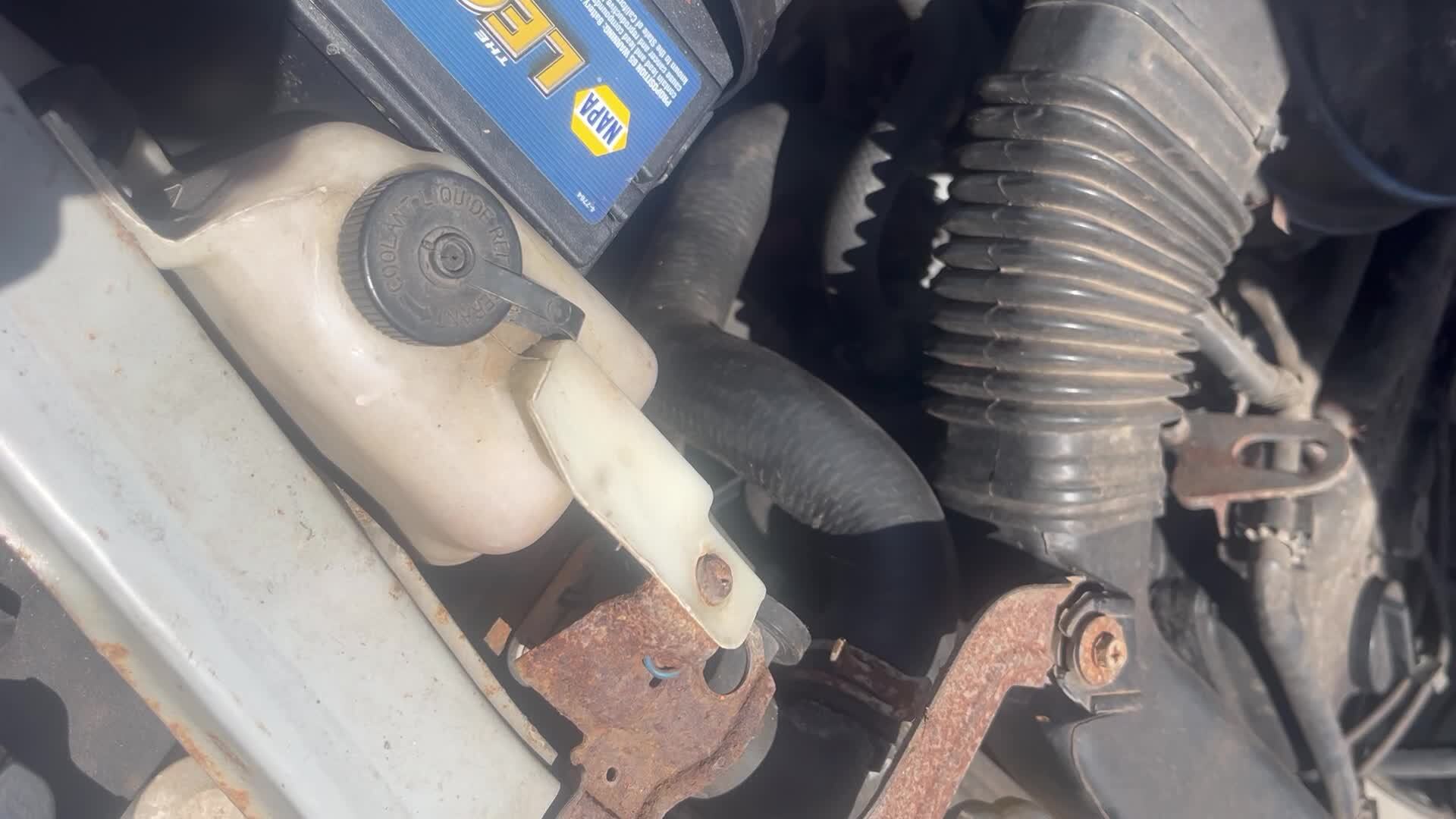

Hi, I need some guidance on how to get to the water pump and removal also replacing thermostat. I just purchased the vehicle runs very strong but I did notice the belts squeaking on start up and while driving. I’m not sure wich belt it is yet as there’s 3 belts on here but I saw the alternator belt in bad shape. I did check the coolant it was quite low and as I drove it for about 30 to 45 mins I notice my ac got warm and temp came up on the cluster so I opened the hood and sure enough I can here bubbling in the hose and in the return tank of the coolant. So I purchased some coolant topped it off. So far idled roughly 30 mins temp seems to stay steady in the middle.I picked up a code PO327 but I don’t suggest that’s the problem here. I’m thinking water pump or thermostat. Also I’m not familiar with this year and model but does the timing belt or chain have to be removed as well to get to the water pump? Need some help thank you.
Note: fan is blowing and I have not notice or detected any leakage. After adding coolant and idling for 45 mins coolant level remains. I did open up cap while vehicle was running and there is circulation wich therefore maybe it’s not the water pump idk.

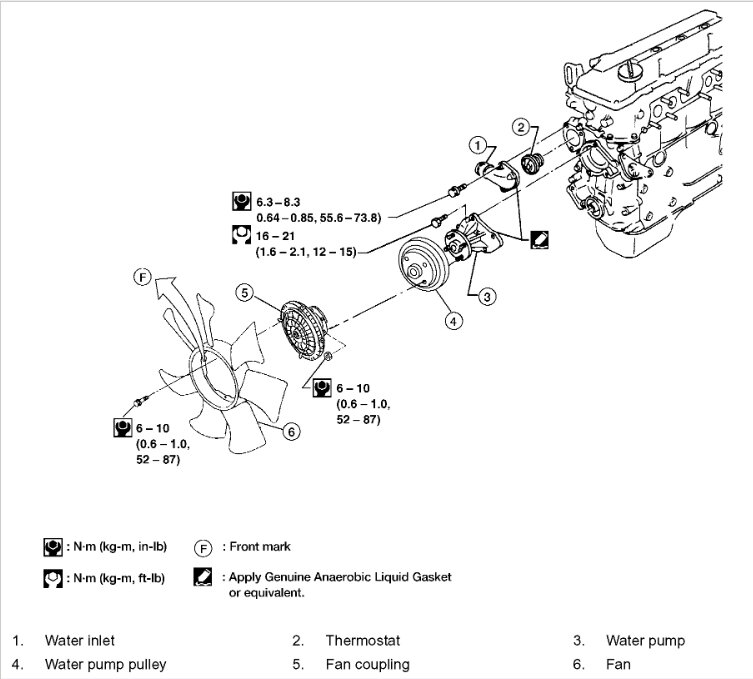

Here is how to replace the water pump, thermostat and fan clutch. Check out the images (below). Please upload pictures or videos in your response of any problems so we can see what to help you with.

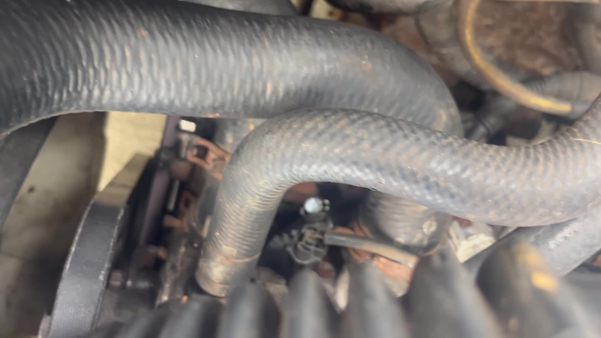

Thank you I have stripped the whole front part. Today I drove the vehicle for about an hour I noticed the temp got higher on 45 mins in. Occasionally it dropped back to normal then back up high until the ac started going warm. I drove it back home and oops one of the smaller hoses connected to the side of the thermostat housing busted. It was a very bad thinned out hose so I ended up stripping down the front I’m going to go ahead and throw in a new water pump and thermostat with new belts and see what happens. As far as blown head I did most of inspection and nothing that points to a blown head. I’ll keep this thread posted updated once I’m done. Thank you

DQ671
  • 24 POSTS
Here’s a video of what it sounds like in the hose
Wednesday, August 6th, 2025 AT 11:12 PM
