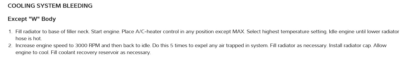

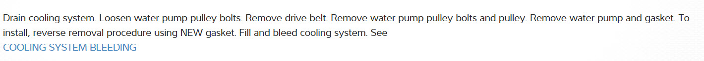

HMAC300
  • 48,600 POSTS
Okay, it is a VIN number K. See picture for instructions. What is not said is power steering pulley may need to be moved out of way and harmonic balancer and engine mount may have to be removed as well to get all the bolts out. System may need bleeding after install.
