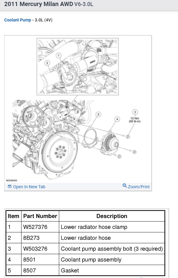

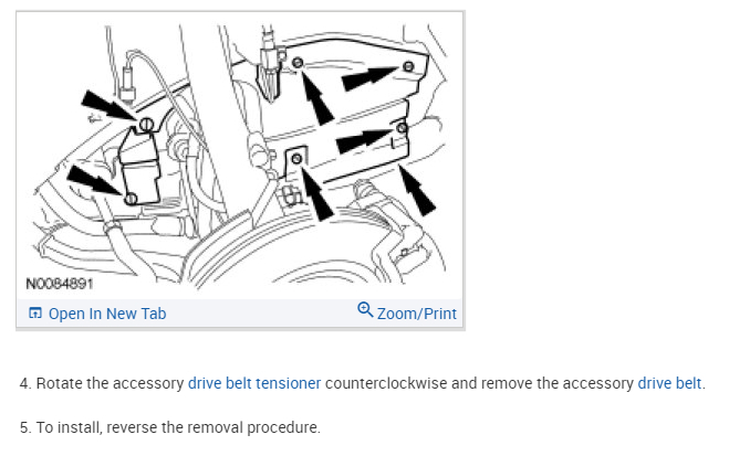

The water pump busted, and i need to replace it. How can i get off, DIY?

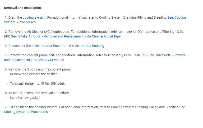

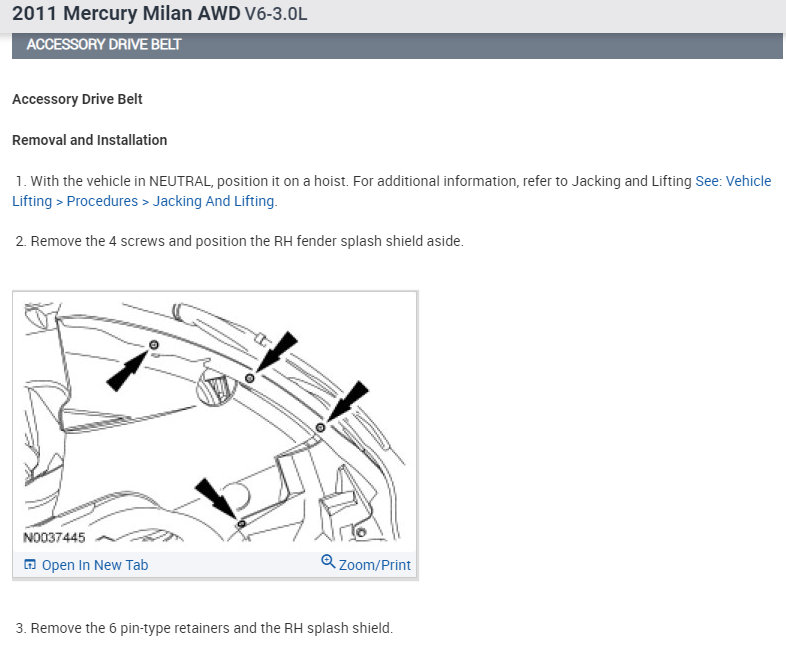

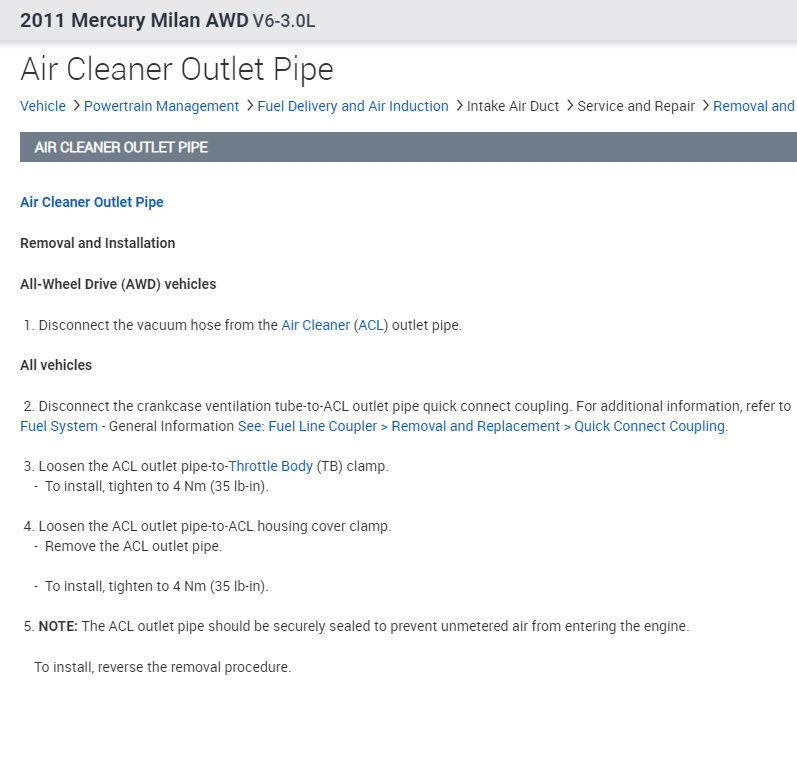

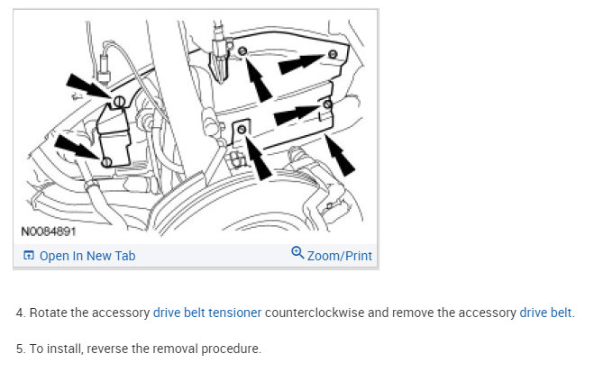

In order to replace the water pump. First the serpentine belt needs to be removed.
Here is a helpful guide and best practices for water pump replacement:
https://www.2carpros.com/articles/water-pump-replacement

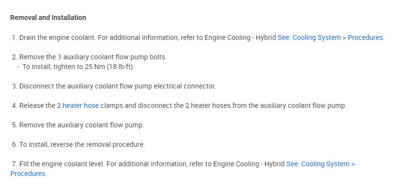

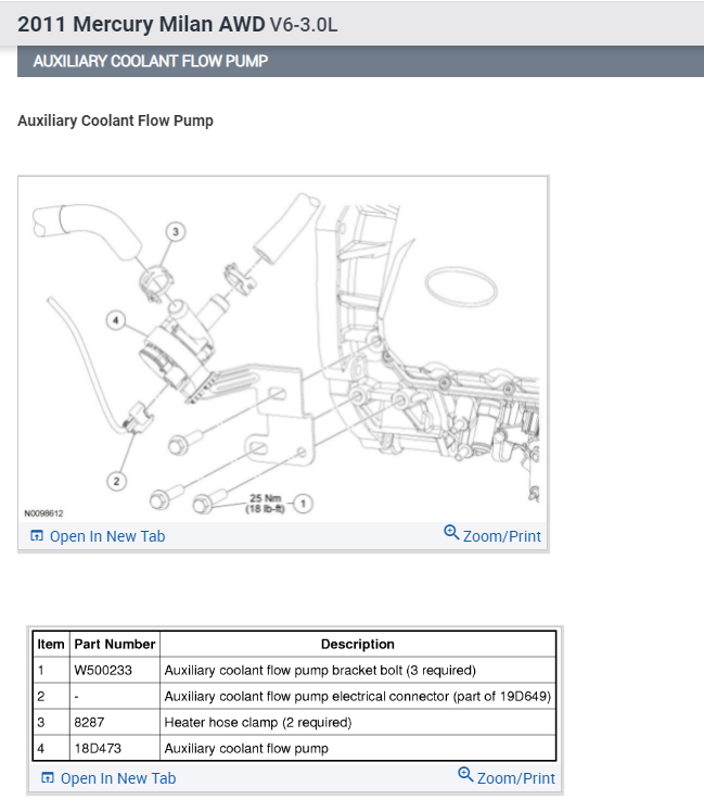

This vehicle has two water pumps, one primary and another one auxiliary.
I have attached the replacement procedures for below for your reference.
