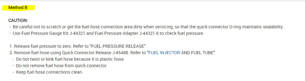

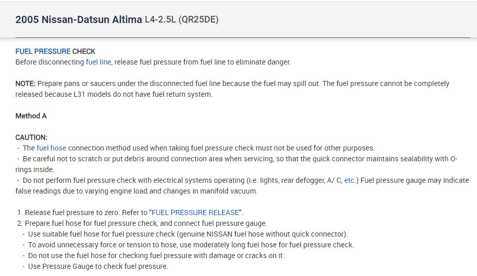

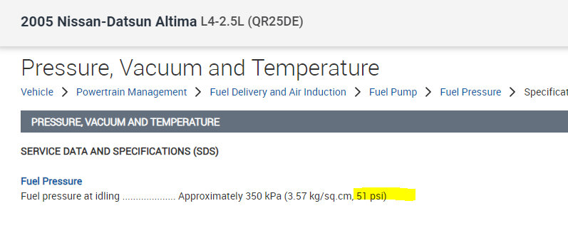

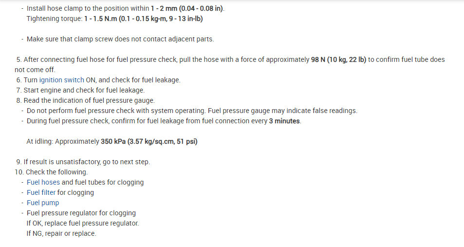

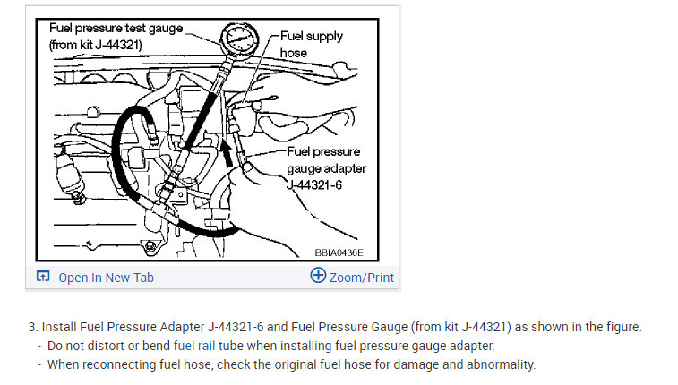

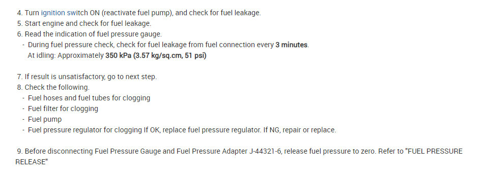

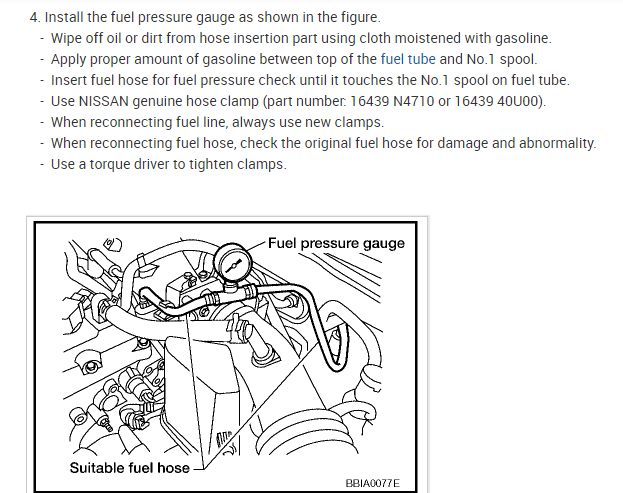

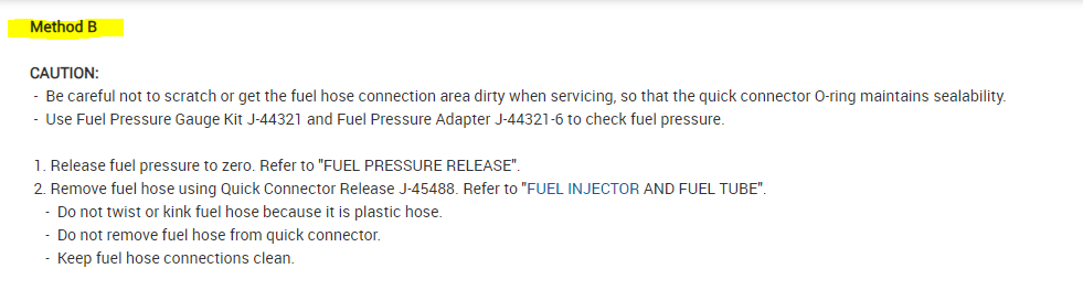

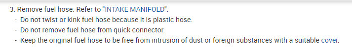

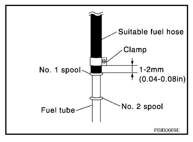

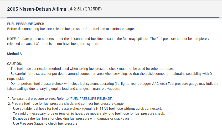

Okay, no problem. I need you to try something, so I know which direction to take you. See if the vehicle will start if you use starting fluid. If it starts and then stalls, we will know it is a fuel related issue. If there is no change, I need you to check for spark at the plugs.
Here is a link that explains how that is done:
https://www.2carpros.com/articles/how-to-check-for-ignition-spark

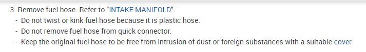

If you are uncomfortable performing the tests, here is a link that explains how to check fuel pump pressure. You will need a fuel pressure gauge, but most parts stores will lend one to you.
I attached the manufacturer's procedures below for you. Also, the procedures include the pressure specifications.
Let me know what you find.
