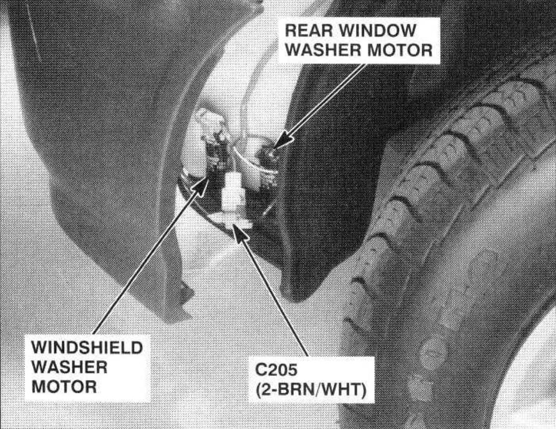

Hello I have a couple questions, first question is what would cause my fluid not to pump, is there a fuse or could pump need replacing,

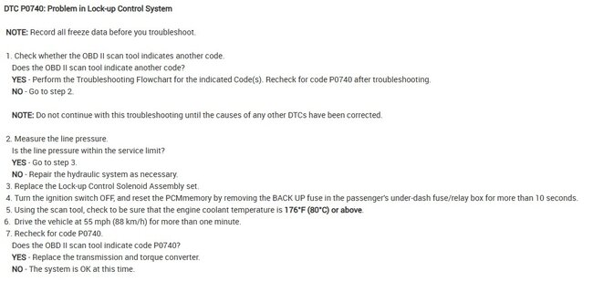

Second question is what do these codes mean and how do I fix it
Po700
Po740

The washer issue could be the pump, bad hose or bad control switch. Have someone hold the wash switch on while you listen at the washer fluid bottle to see if you hear the pump. Fuse wise, the same fuse powers the wipers and washer pump so if the wipers move it isn't the fuse. One other item, are you in a location that got really cold recently and possibly had washer fluid not rated for those temperatures? That could cause pump failure if the fluid was slush and you tried to use the washers. The pump isn't that bad to replace, it plugs into the washer bottle. You remove the fender liner on the left side and the reservoir is in front of the tire. From there you can test the pump and check the lines as well.

The P0700 isn't really a code, it is a flag to tell a shop to scan the transmission systems to find the real code, as such you can ignore it as the P0740 is the real code and it relates to how the torque converter lock up system operates. Testing for it involves testing the fluid pressure in the transmission, then test driving the car after clearing the code, if the fluid pressure is within the specification and you clear the code and it returns, you replace the torque converter and the transmission as there is an internal failure. So you could try that before you ask the question related to that code

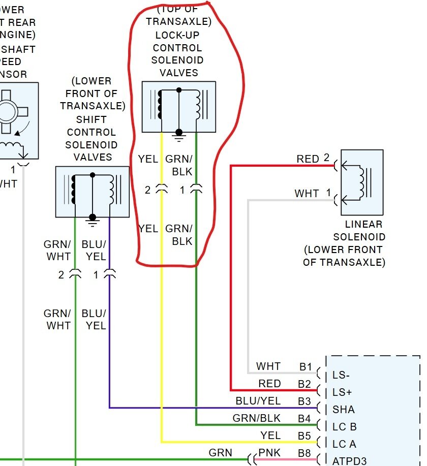

Can’t I just replace the torque converter lockup solenoids cUZE THAT IS WHAT THE CODE IS I BELIEVE

This is the OE test for the P0740. I would also test the resistance through the solenoid and see if it has a broken circuit. If it does, replace it and see if the code goes away and it actually locks up.

So if torque converter is licking up what do I do then

It might be locking up, but the solenoid might be partially shorted or it might have intermittent issues. That is why you put a scan tool on it and do the testing, to see what the PCM thinks is an issue that sets the code.
