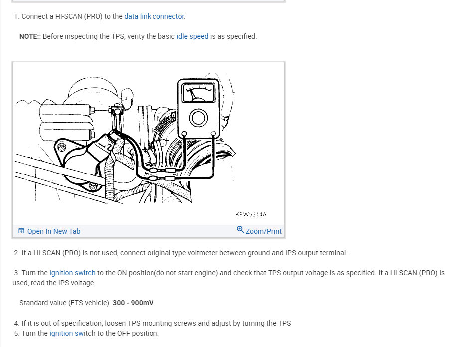

Just replace throttle position sensor. Started vehicle and check engine light still on and 4wd is blinking and car running worse?

Couple things. First what was the reason for replacing the TPS? Second what codes do we have now?
You are able to adjust this TPS so I attached the process just in case that turns out to be the issue.
Let me know what codes you have and we can go from there. Thanks
