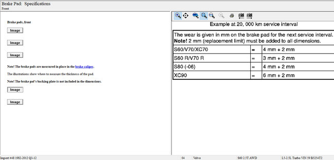

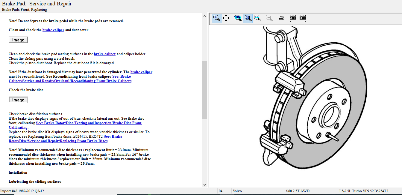

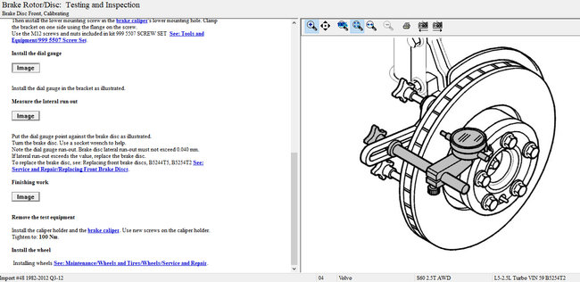

I need you to help me with a brake job.
Sunday, May 17th, 2009 AT 3:27 PM
SEVAG P
MECHANIC
406 POSTS
Check the instructions below you can replace front brake pads and discs by yourself.
check our guide below how to replace front pads and rotors.
Check the diagrams and instructions below how to replace and inspect front pads and rotors.
hope these helps.
